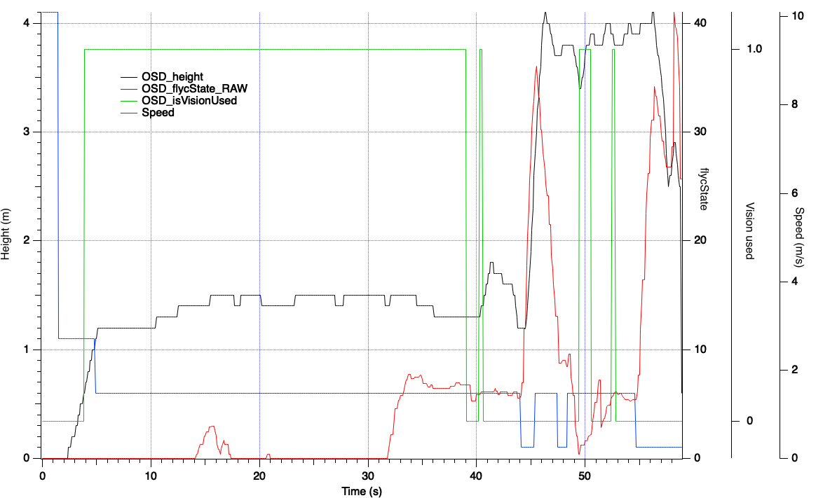

I've investigated the flight records closely and cannot seem to understand the cause of the issue. I've flown the spark consistently through my trips with limited speed and did not expect it to accelerate uncontrollably at these speeds in such a sudden.
I've attached the flight logs for your reference as well. I did not recieve any environmental warning on strong winds to suggest otherwise - so I believe it might have been a defect or malfunction. According to my understanding of the drones features I do believe there should've been safety limits and consistent controls to ensue consistent flight behaviour.

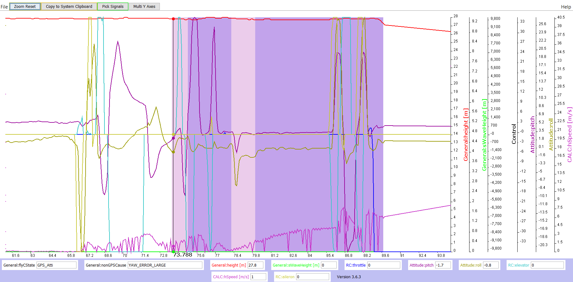

At ~74 seconds the aircraft experienced a Large Yaw Error ( Basically a compass error ). The aircraft then auto-switched to ATTI at ~80 seconds which means no GPS positioning. The aircraft was responding normally to your inputs and appeared to be under your full control. You may not have experience flying in ATTI mode. From what I see, the crash is a result of that and not due to the actual aircraft errors. The aircraft will drift with the wind when in ATTI mode. There was a brief period where the drift speed up occurred ( With no control inputs from you ) and this would be normal.

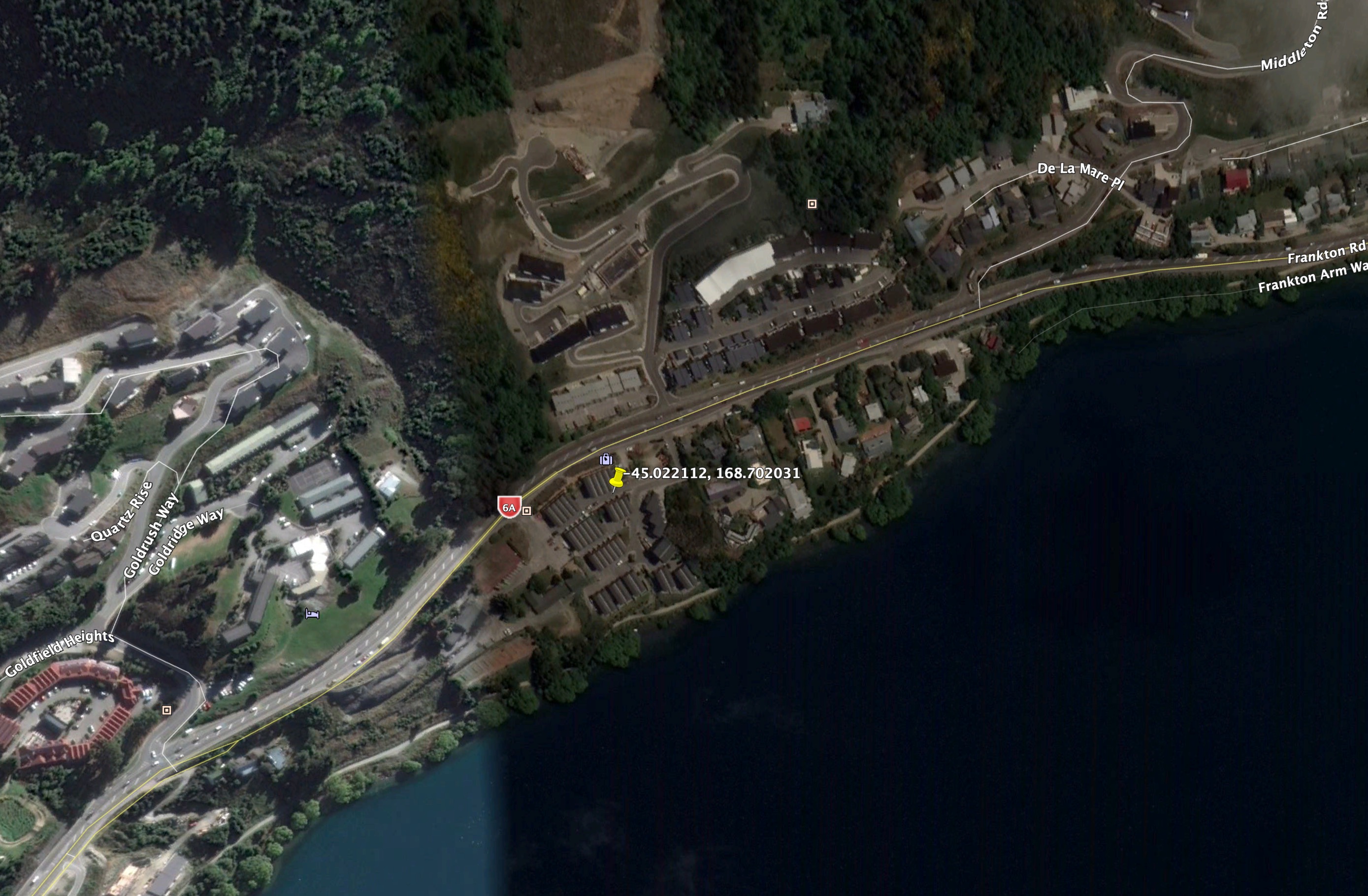

Well it was flying outside in central Queenstown. I dont think it took off near anything remotely abnormal. A lot of nature around here...
Perhaps a faulty GPS error?
The yaw error was irrelevant since the aircraft never had any GPS satellites - positioning was via the vision system and responded normally. Once the aircraft climbed that was lost, hence the switch to ATTI and the pilot lost control.

The question is why did it have no GPS reception. Location, cold start or faulty GPS module/connector? The mobile device had a position lock:
Yes good question... I reckon it could be an issue with the GPS module? I'm dead centre near Queenstown, I dont think GPS would be a problem here. Further, this was all done outside - not sure if interference would've played a part, I wasnt under some concrete or anything magnetic...

Ignore the compass error - that happened before the aircraft took off and could have been for any number of reasons. Why did you take off without any GPS satellites locked? Has that happened before? Will the aircraft still power up and, if so, does it show any GPS satellite reception?

Unfortunately the problem was fundamentally an error on your part - you took off with no satellites locked. None. That guarantees ATTI mode once you lose VPS, and if you are not experienced flying in ATTI mode it will most likely result in a crash.

The acceleration was caused by your elevator input once the aircraft switched to ATTI. Unfortunately the aircraft is well out of warranty, so even if you can demonstrate and persuade DJI that the problem stemmed from a faulty GPS module they are not going to replace it.

That's not what happened, as illustrated by the fact that the mobile device on the ground had good satellite reception. Zero satellites is rare, and suggests that something else was going on.
If the location you showed was your takeoff point, it shows a lot of non-nature around.
Being under concrete is not what was meant.
Launching from on top of reinforced concrete is a very common cause of the the issue you experienced.
Or anywhere else that's close enough to something steel that can disrupt the compass.
The speed you mentioned matches your right joystick inputs and just shows the drone continuing without being able to stop and hold position.
Once your drone is in atti mode, it does not have the benefit of position holding that GPS gives and flying is like driving on ice with no brakes.
The drone can't stop and will continue coasting after you centre the joysticks.
The GPS is usually very reliable and the issue is much more likely to have been caused by where you launched than a faulty equipment.
