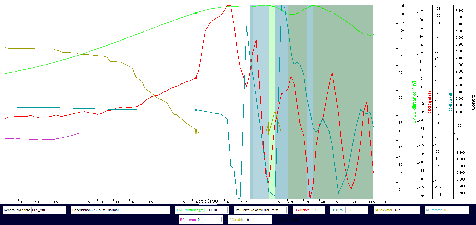

Before the error messages show up, the drone was flying forward in a northerly direction.
The joysticks were released at 3:56.2 and the drone slowed down
At 3:57.2 we see the drone starts to rotate, the drone pitches and rolls.
At the same time the drone rapidly loses height and tumbles toward the ground.
At 3:57.9 the Speed Error messages start to show.
These are a symptom of the failure rather than pointing to the cause.
The flight controller reacting to the information it's receiving from the sensors as the drone tumbles.
It lost GPS when the drone rolled/tumbled and that was the reason it went into atti mode.
The compass error is because the drone is spinning.

The speed error is unrelated to the incident. Those occured during the tumble. That is related to the IMU positioning and Velocity Calculations. It certainly looks like a lost prop as you released the elevator.
Hey Fly Dawg, you know what I'm going to ask, how do you come to that conclusion from the above plots? Everything seems to be going everywhere, I don't se anything suddenly stopping.
Gold Plot- Elevator: Goes to Zero Input gradually.
Red Plot- Aircraft Pitch : Pitches up as you would see in a fast stop, but much more severe.
Aqua Plot- Aircraft Roll : Sudden severe roll to the left.
Afterwards the tumble begins.
Is that what you were asking?
