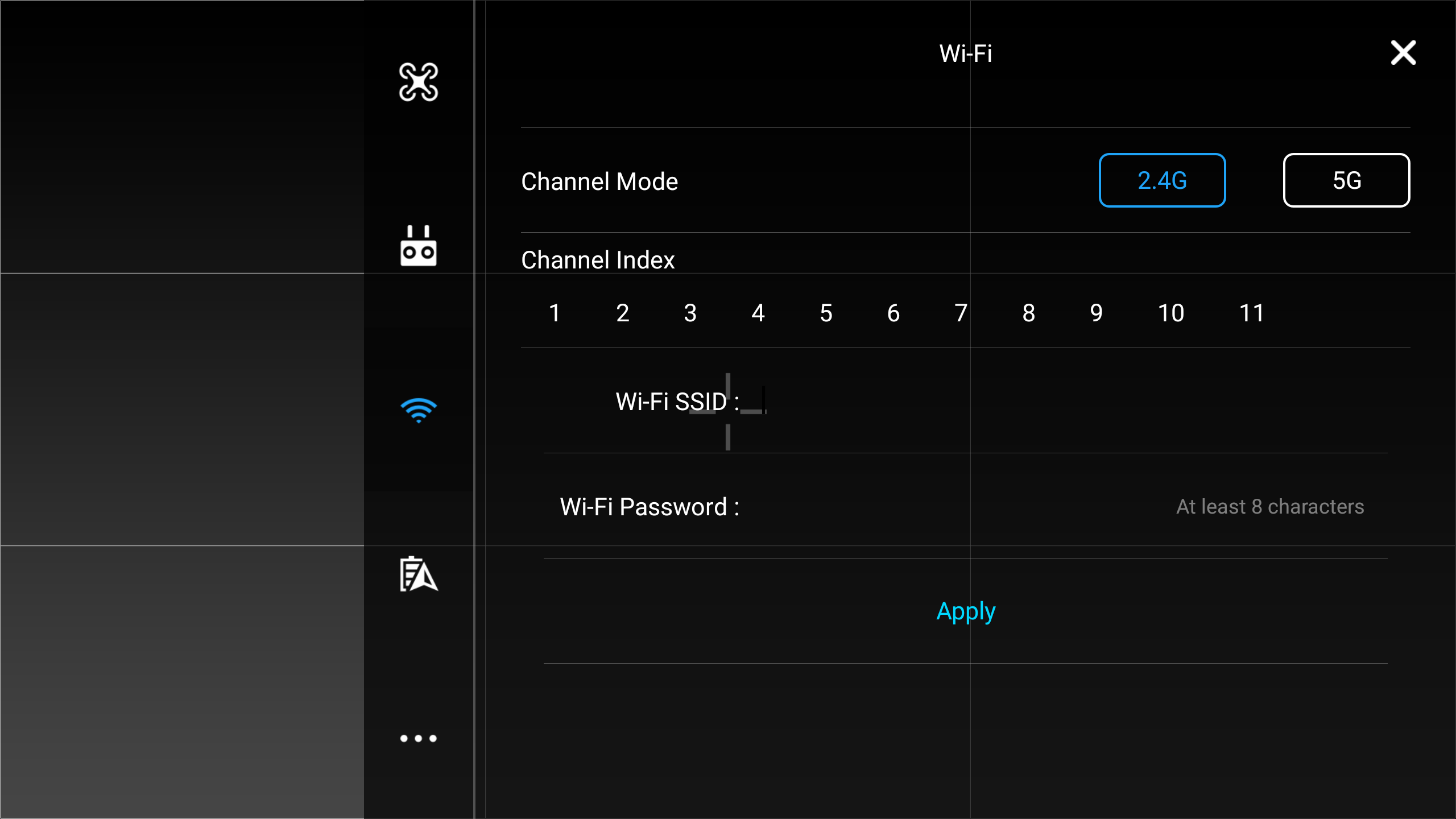

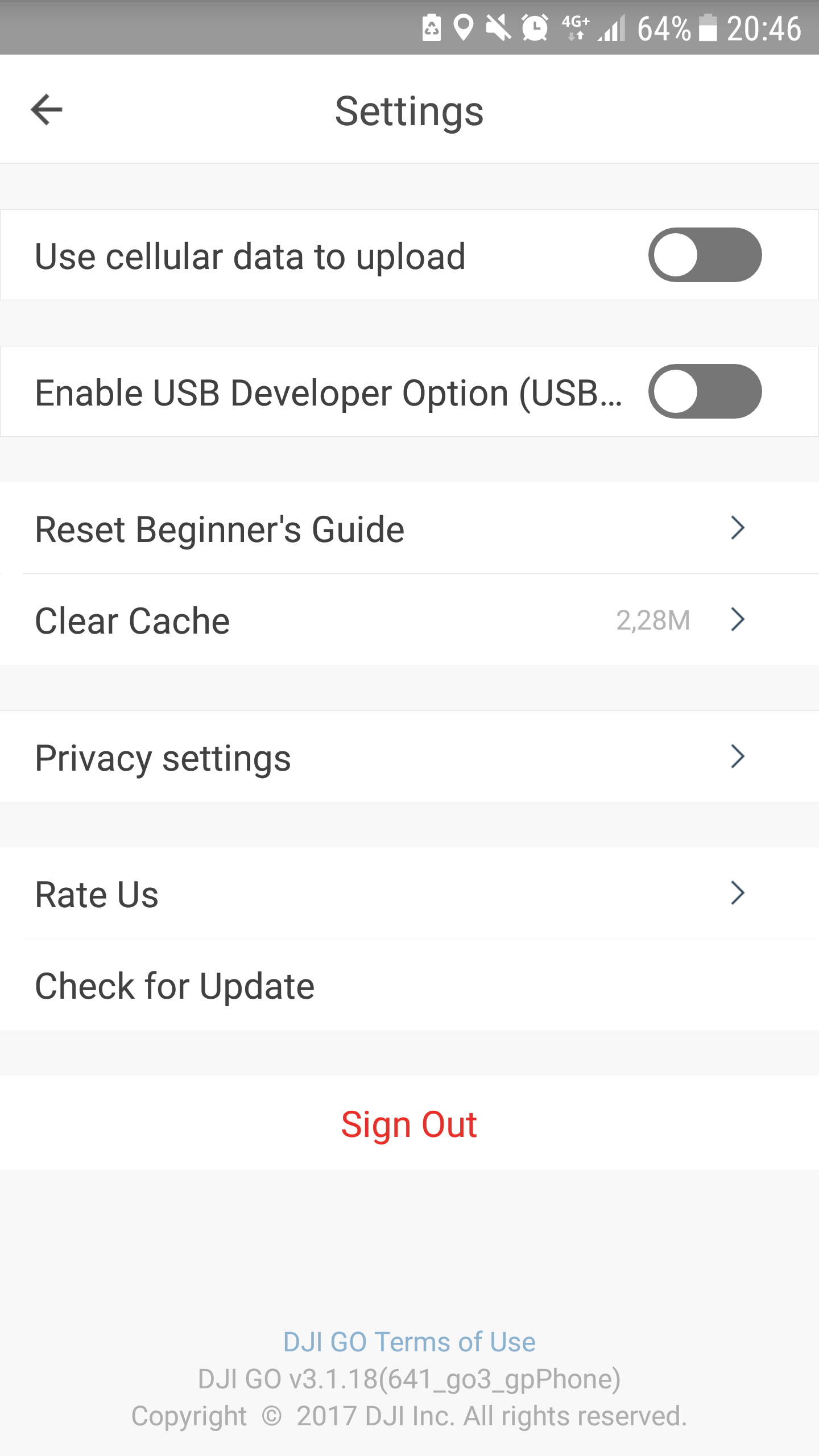

Andy, if you use app such as "wifi analyzer" to check what frequencies there are, bare in mind, that if your connection between AC and RC is made trough 5ghz in the app "wifi analyzer" you will only see 2.4ghz SSID of the RC As soon as you choose the 2.4ghz frequency inside the DJI GO app, and the connection between the AC and RC is made through 2.4ghz in your "wifi analyzer" app you will only see the 5ghz SSID of the RC and 2.4ghz is not there anymore . I tried that and that`s how i found out, that you cannot see the frequency that makes the connection between AC and RC if they are connected. Last night i did what the Russian site suggested for going back to FCC mode and keeping it but a don`t have the chance now to test it outside.
1. Used 3.1.22 DJI GO app and FakeGPS procedure to switch to FCC (11 channels in 2.4ghz range)
2. uninstalled it, deleted all the folders related to it, including the here maps one.
3. downloaded the 3.1.18 app from the link that they posted and installed the app. I think it` s some kind different from others, because it just started extracting the "resource package" without needing to connect to DJI servers.
4. i started the DJI GO app, logged in and did not see the wifi switching window- Fake GPS was OFF

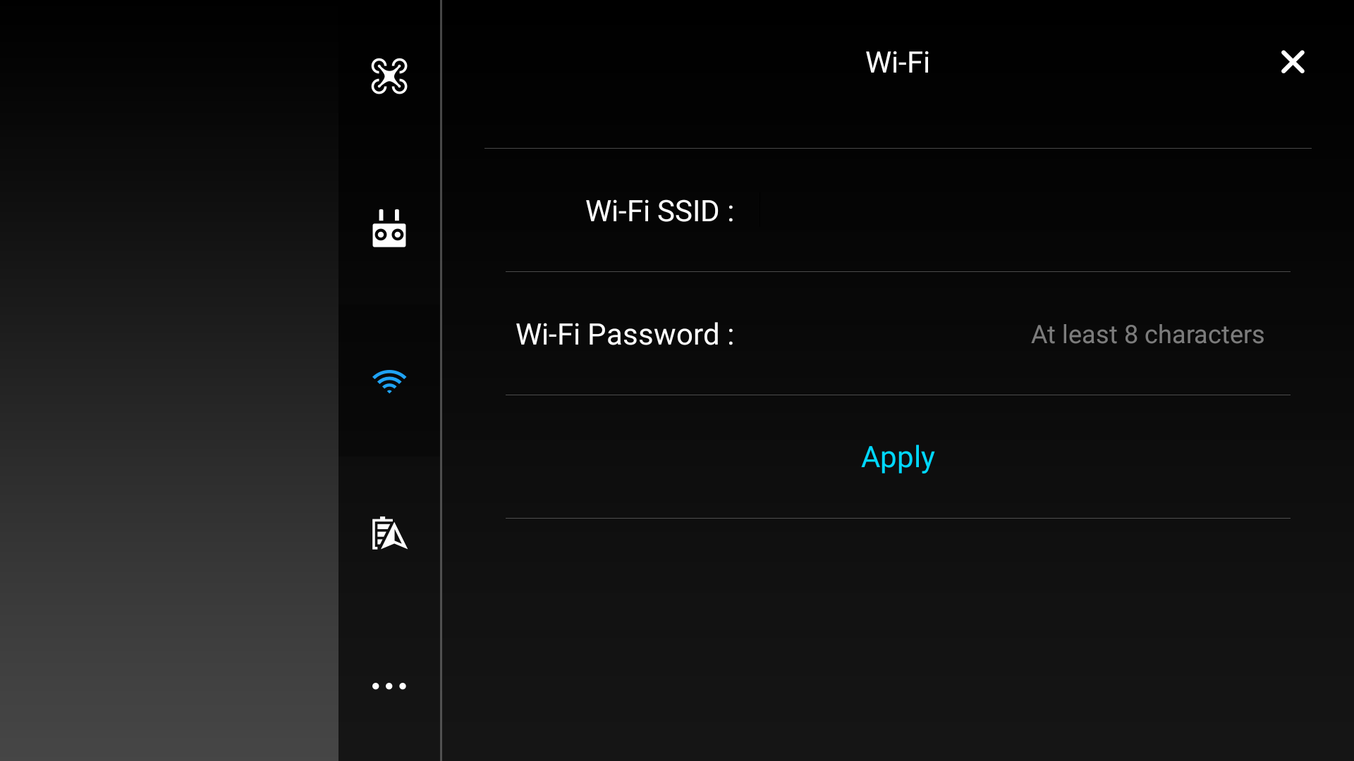

The bad thing is that there is no frequency switching option it that version (3.1.18) so i cannot be sure what is going on.... I assume that the connection between the AC and RC is now 5ghz because i can see the 2.4ghz in the "wifi analyzer" app.
I am using the 3.1.18 version of the app and there is indeed frequency switching option, also can and does switch to CE mode...
Well...i don`t have the option to switch between 5 and 2.4ghz

Yes, in my case the same window to switch WLAN settings will pop up when I lose connection with the AC and it reconnects, just the same way like it does with other versions of the app.
It's strange that you don't have the frequency switch option, i understand you have it with other versions of the app so its not related with phone ability to use 5ghz and can be related to some "mod" to the app?
