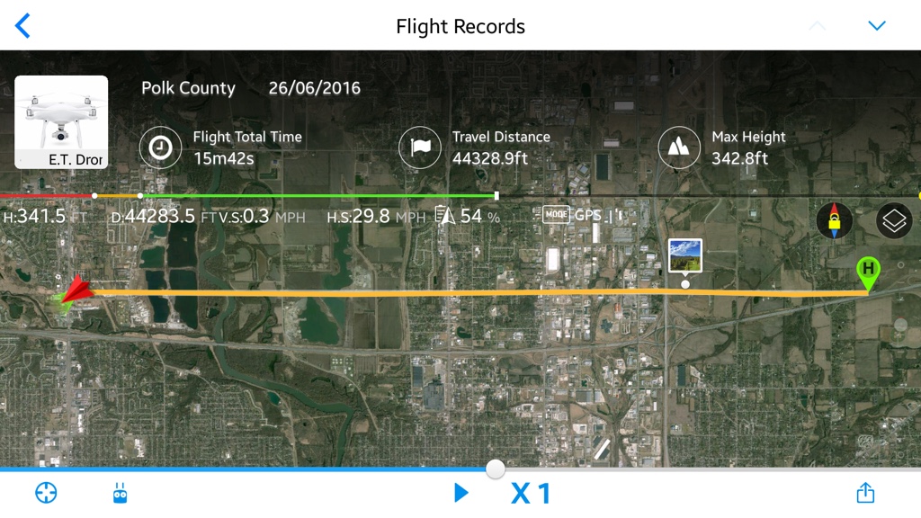

Did you try the P4 controller with simple windsurfers and the nearly 600ft AGL you flew on that flight? Hard to imagine it couldn't go farther unless it is defective and needs to be replaced.
How far does your P4 controller reach with the boosted ItElite Antenna set up?
Yes and yes. That was with a windsurfer on the stock P4 controller. Failsafe RTH was set to 750 feet. Flying at 100 feet, control signal was repeatedly lost at 2,500 feet, and was not restored during the ascent to 750 feet, until it started flying back toward home, when the hypotenuse of the triangle formed by the elevation and the base distance away from me was significantly less than 2,500 feet. Elevating the aircraft only worsened the control signal because the drone to controller distance was thereby increased. P4 stock controller was abysmal, even with a windsurfer that I get over 3 miles out of, when used on an unmodded GL300A with my P3P over the exact same terrain. YMMV.
Already have two GL300A modded P3 controllers, so no need to mod the P4 controller, so I can't answer your last question. Using the DBS-02 with boosters on the GL300A is the bomb when paired with the P4. Rock solid out to almost 6 miles!
