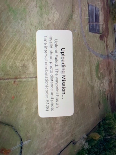

Here's a phone pic of the error message.

Never had an issue with that myself. Since the mission is set for straight lines, curve size values are ignored. Unless there is a glitch in the software some place. Haven't seen that effect anything before. The OP stated the mismatch error, but I don't see where an upload failure would be.
Seeing more detailed info on the error, I do agree that probably is not the related to the error message.
