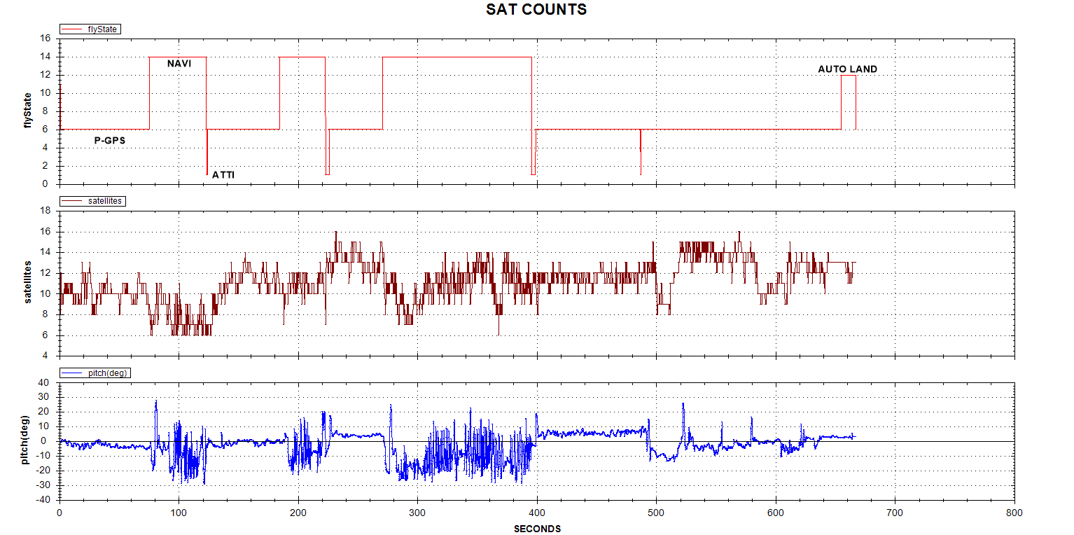

You only linked to one flight, however at initial look you may have a GPS issue of some sort. The aircraft switched to ATTI several times, then back to P-GPS then To NAVI. Your satellite counts were all over the place. Nothing really consistant. I suspect that the NAV HEALTH dropped to below 3 at those intervals. There is not enough data here to provide anything certain. Below you will see the Sat Counts vs the Fly State. If you wish to pursue the aircraft file, see the link below for instructions. Of note, there is another thread with a similar issue, as of now un-resolved.

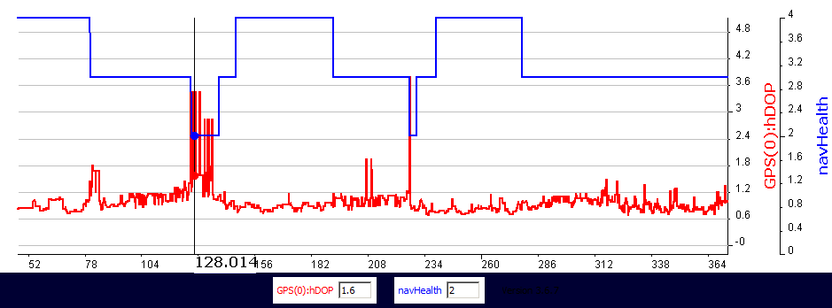

@BlueVista ...That appears to be the correct flight. There is undoubtedly an issue with the GPS of some sort. The dropouts are correlate with the Nav Health dropping below 3. Let me see if I can get a more detailed answer for you when @sar104 or @BudWalker have the chance to take a look. Below is just one of the dropouts. There were 3 if I counted correctly.

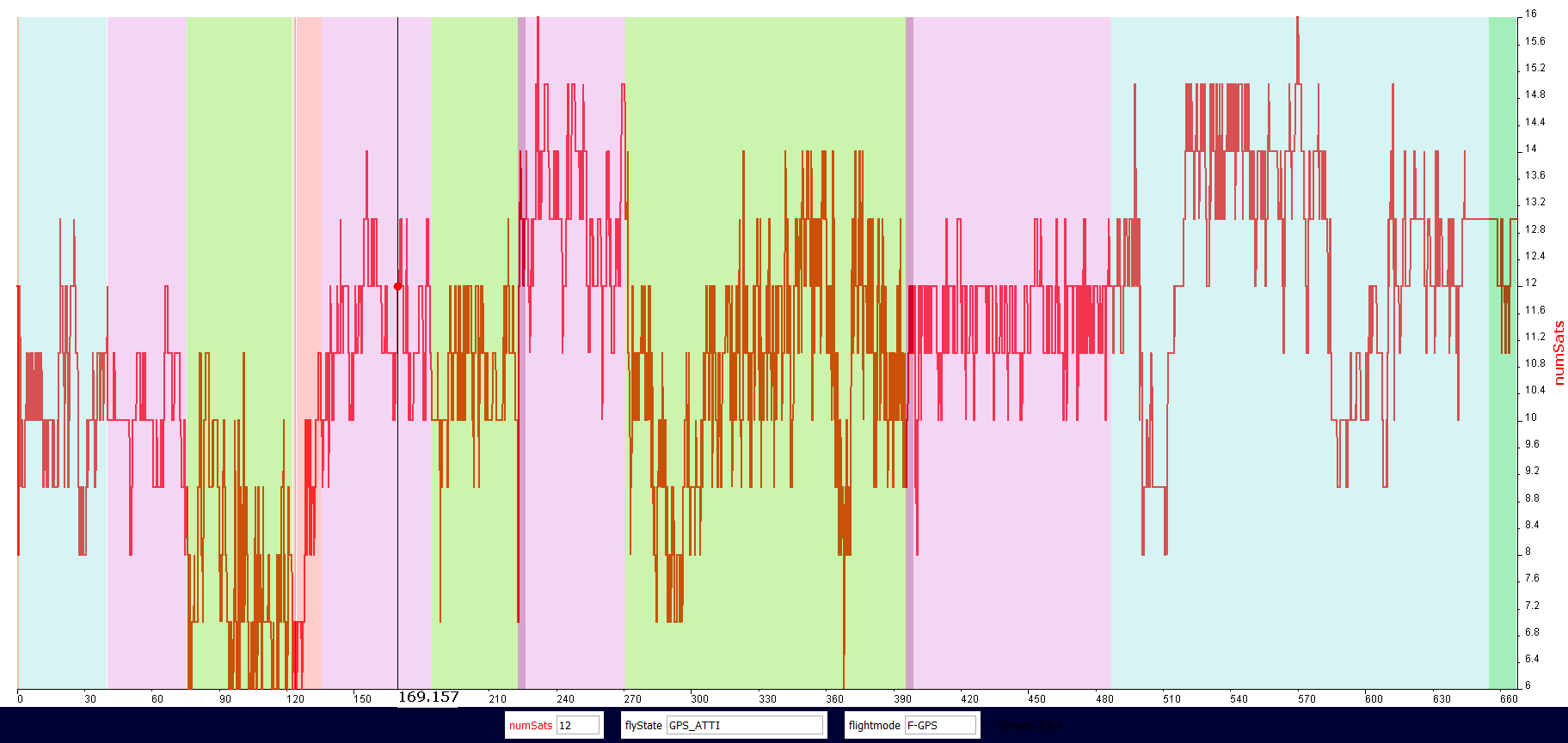

For comparison purposes, the first graph below is the sat counts from the flight with the dropouts. The second graph is from your good flight. Both from the device file, but note the similarity.
DROPOUT FLIGHT
112314
GOOD FLIGHT
112315
Looks to me like the sat count is marginal and there are occasional problems. An increase in the hDOP causes the navHealth to drop.

As @BudWalker mentioned your Sat Counts are marginal at best, as I noted previously. Just to eliminate a variable and see the results. Try flying a quick manual flight in a different area than the above. As a test, simply fly up to around say 150ft or so and hover there. Watch your device Sat counts while you hover for a few minutes.Then after that flight, upload the device file from that flight. Personally, I would be willing to say at this point that the results will be similar. However, that is what testing is for.

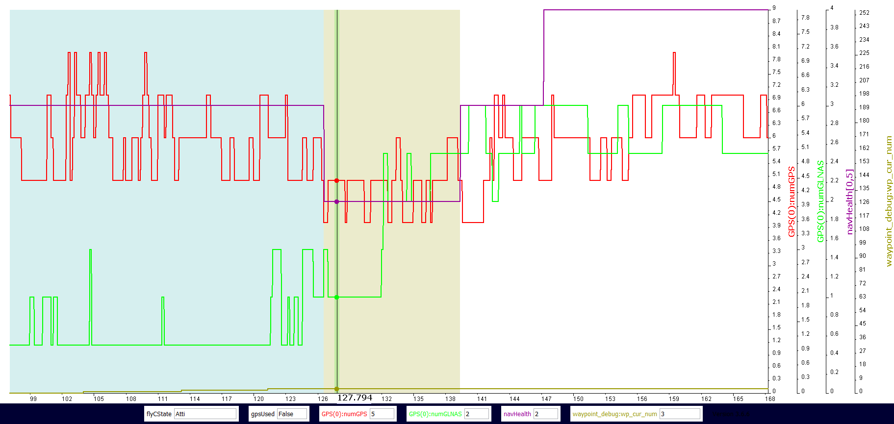

I looked at FLY102.DAT - Bad one... 19-06-27 . It shows the same problem described in post #16. The satellite count was marginal and occasionally the horizontal Dilution of Precision (red) would increase. This then causes the FC to become less confident in the location that it is always computing. That confidence level is shown in the navHealth signal (blue). When the navHealth dips below 3 the FC will then switch to ATTI mode because it can't use GPS to compute location. I suspect that the mission is aborted when this happens.
