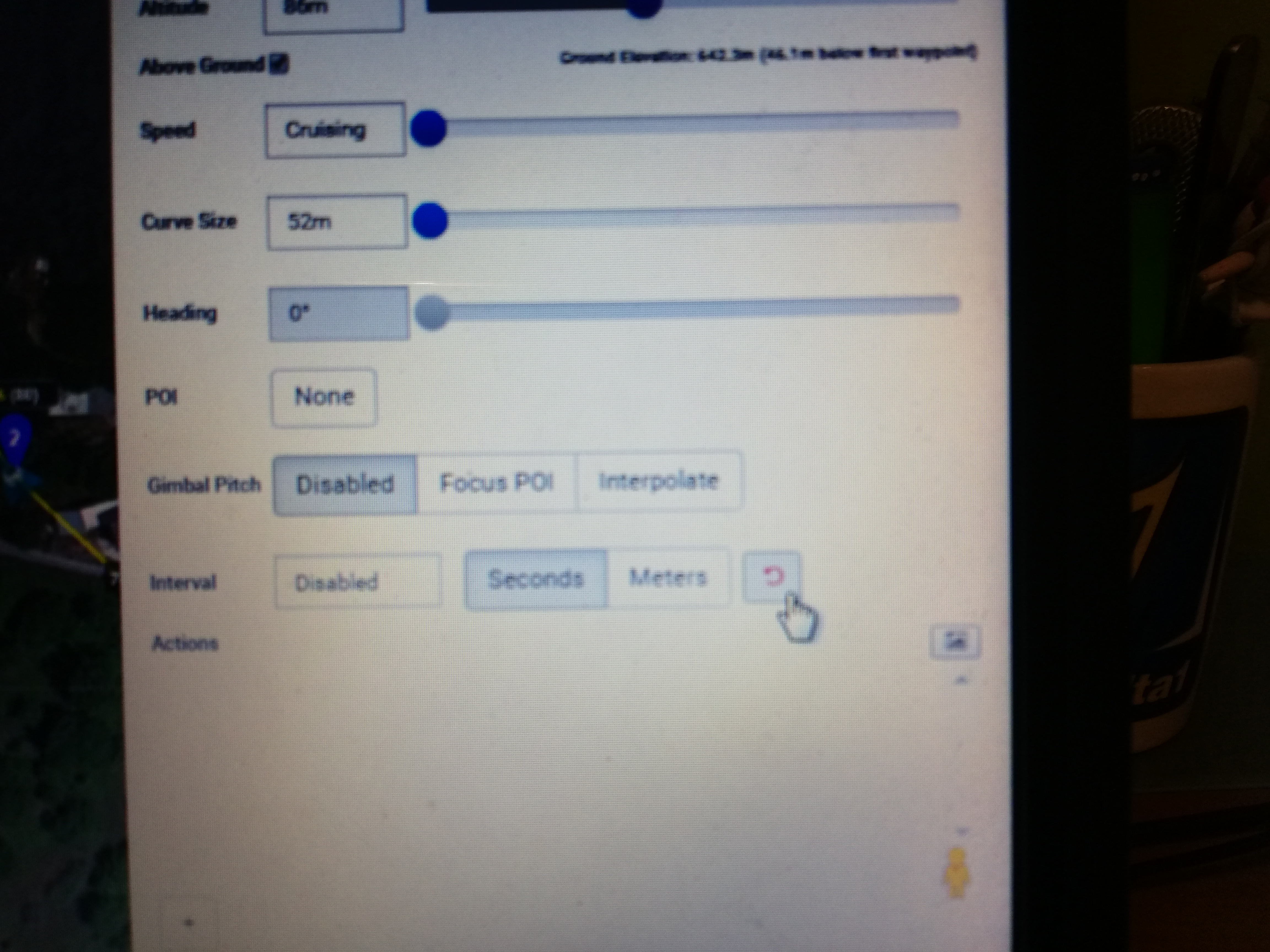

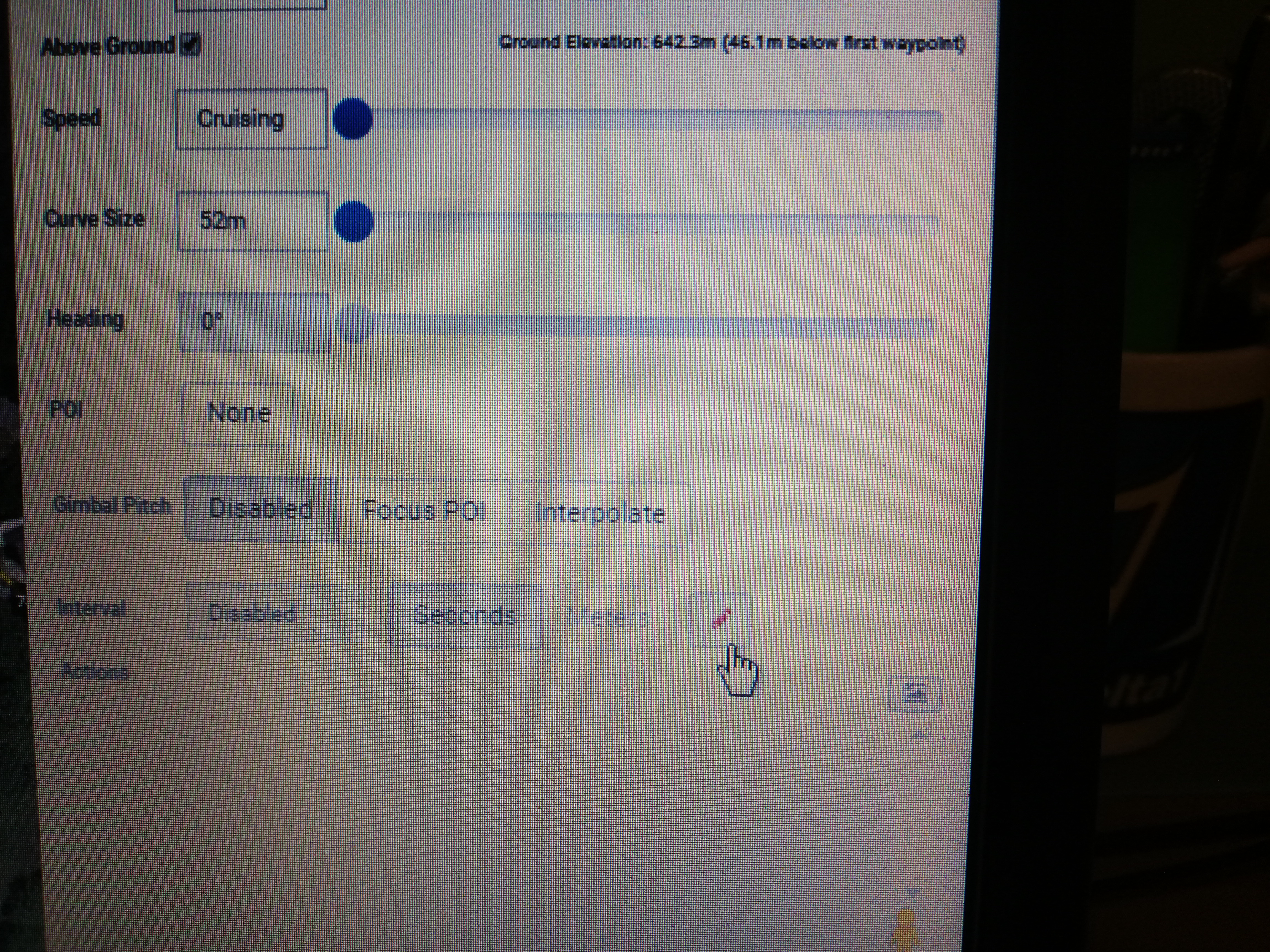

I’m unable to launch a waypoint mission that fails to upload, citing error code 5128 with description of a photo time/distance mismatch. None of my waypoints are close together. The flight speed is under 10 mph and all I’m doing is turning on the video recording ( no still shots). Can’t find info on that code. Any help appreciated. RDR
This is the solution: when creating the mission on the hub, check that each waypoint has the option flagged in the "interval" section as in the first photo, not as in the second photo
