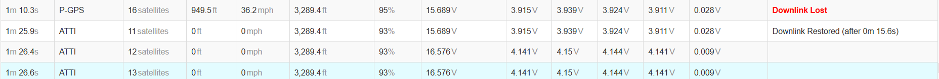

here is the flight log, see that battery is ok and i was high in the sky, far from any objects, a bird maybe?
DJI Flight Log Viewer - PhantomHelp.com
how can this be possible? the drone to fall like a stone in this way??

At 1m 10.3s ... link lost ...
1m 25.9s .... link restored ... but it shows that ATTI mode is still active ...
If you were out there and ATTI mode was active - then the AC is basically unstable and could easily if you are not aware drift or change altitude such that it can crash.
ATTI mode requires that YOU the pilot provide full control to maintain all aspects of the flight ... the Flight Controller will only assist with command interpretation to the ESC / Motors.
The home distance is over 3200ft ... which I suggest in the urban environment you were taking off in is too far with a WiFi machine. Once it went ATTI - you were too far to get a display and had no idea of what was going on. Sorry - my honest opinion.
Nigel

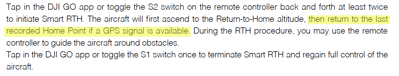

Actually its a little more than that. The manuals for P3's indicate that even in ATTI mode if there are sufficient Sats and Home Point has been recorded - it will still RTH.
I assume the P3SE will do same ...
Page 10 of Standard manual
Page 11 of Adv and Pro manual
The flight log shows that more than enough sats and link was restored - problem was that means RTH will NOT kick in and because hes unaware the AC is in ATTI mode ... he cannot do anything to save it.

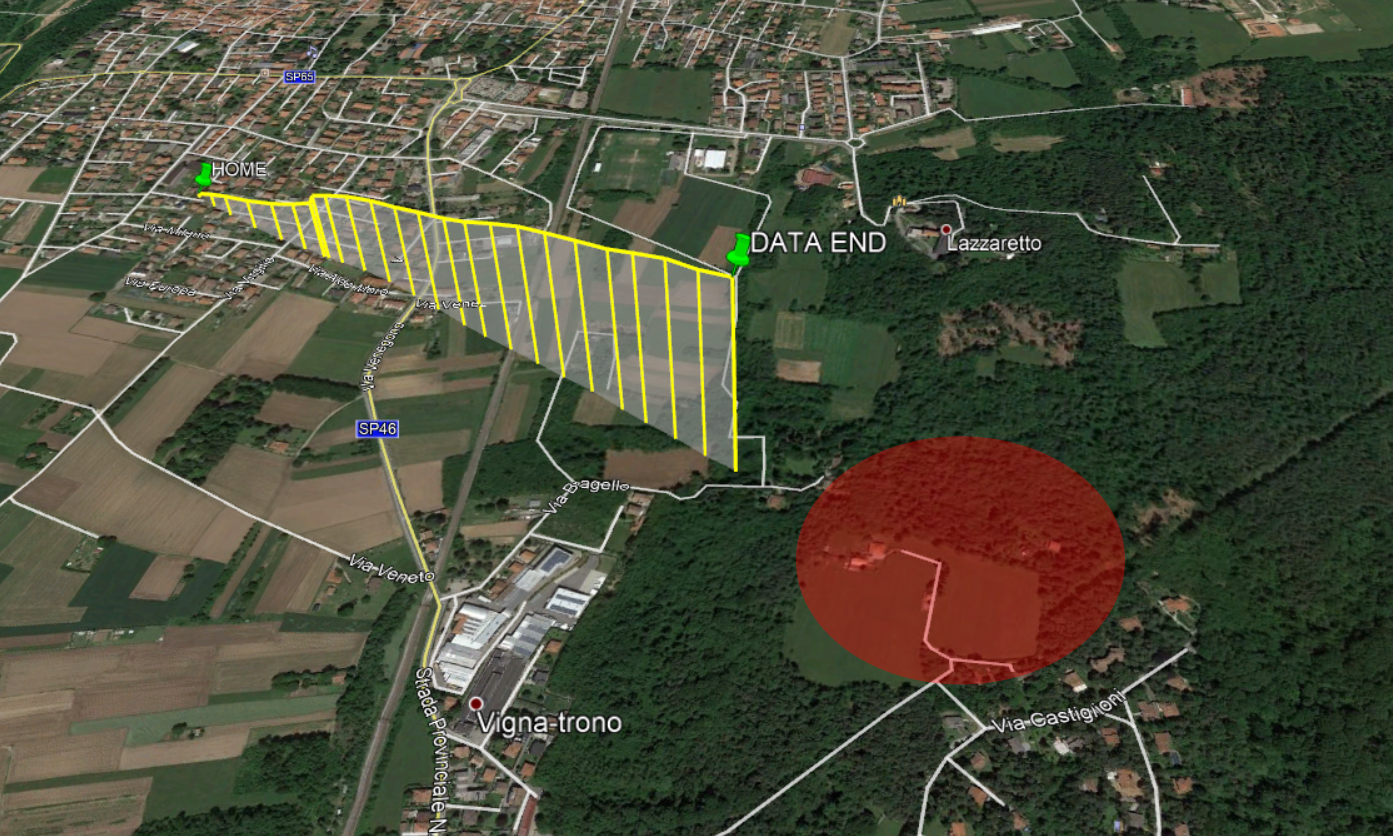

There is nothing in the data to indicate any sort of issue, other than as much as I hate to say it, "wreckless flying" IMO. Assuming that this was a bird strike, or some sort of mechanical failure on the aircraft, ignoring the RTH aspect. This may be very difficult to locate. I didn't take the time to do all the speed and distanace calculations other than your last speed and altitude, which was "WAY TOO HIGH AND FAST".....You would have had an angular fall which would put the aircraft far from the last recorded position. Taking a guess, possibly in the circular area below or farther.

Those last lines in the log are the 'killer' ... he loses link - and the AC drops to ATTI ... he regains LINK but faiils to go back to P-GPS ... speed etc. show it stationary ... and we all know what happens with no input when ATTI ... its anyones guess where it ends up.
I agree that is what it says, but it makes no sense to me as to how the aircraft can RTH, even with a recorded home point without GPS lock to know where it is in the first place. Just because the home point is recorded on the aircraft, does not mean that it knows where that location is without a reference. Anyway, the SE manual reads slightly different.
Wow, thank you very much for this! It seems like a very big area to search and there are some private properties I fear, tomorrow I’ll go with a few friends and look the area, in any case thanks for this graph

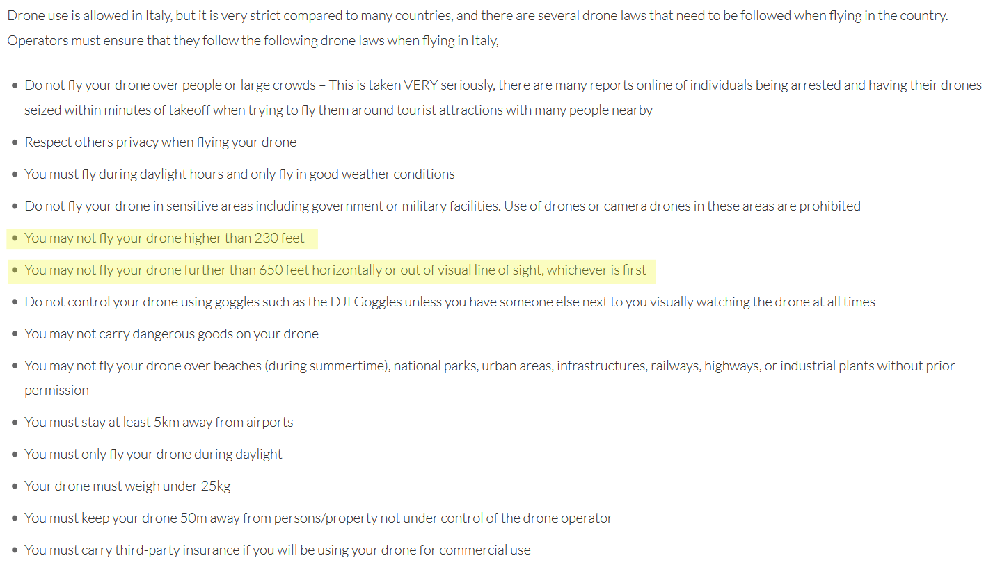

Just to clarify, It was the altitude that was disconcerting. Understandable if you are flying in mountain areas, but where your were flying far exceeded the altitude necessary for safe flight, winds can really pick up at that altitude and be dangerous to your aircraft. I am not sure of the altitude limits in Italy, but I fairly sure it is well under that.
In specific, note the highlighted below:
If you check his Log ... it shows more than enough SATS locked in ... but because the AC regained control link - it stayed there in ATTI mode.
If he had lost control link ... with the 16 SATS - it would have returned home ... there is no warning of no compass or anything ... its showing fine ...
