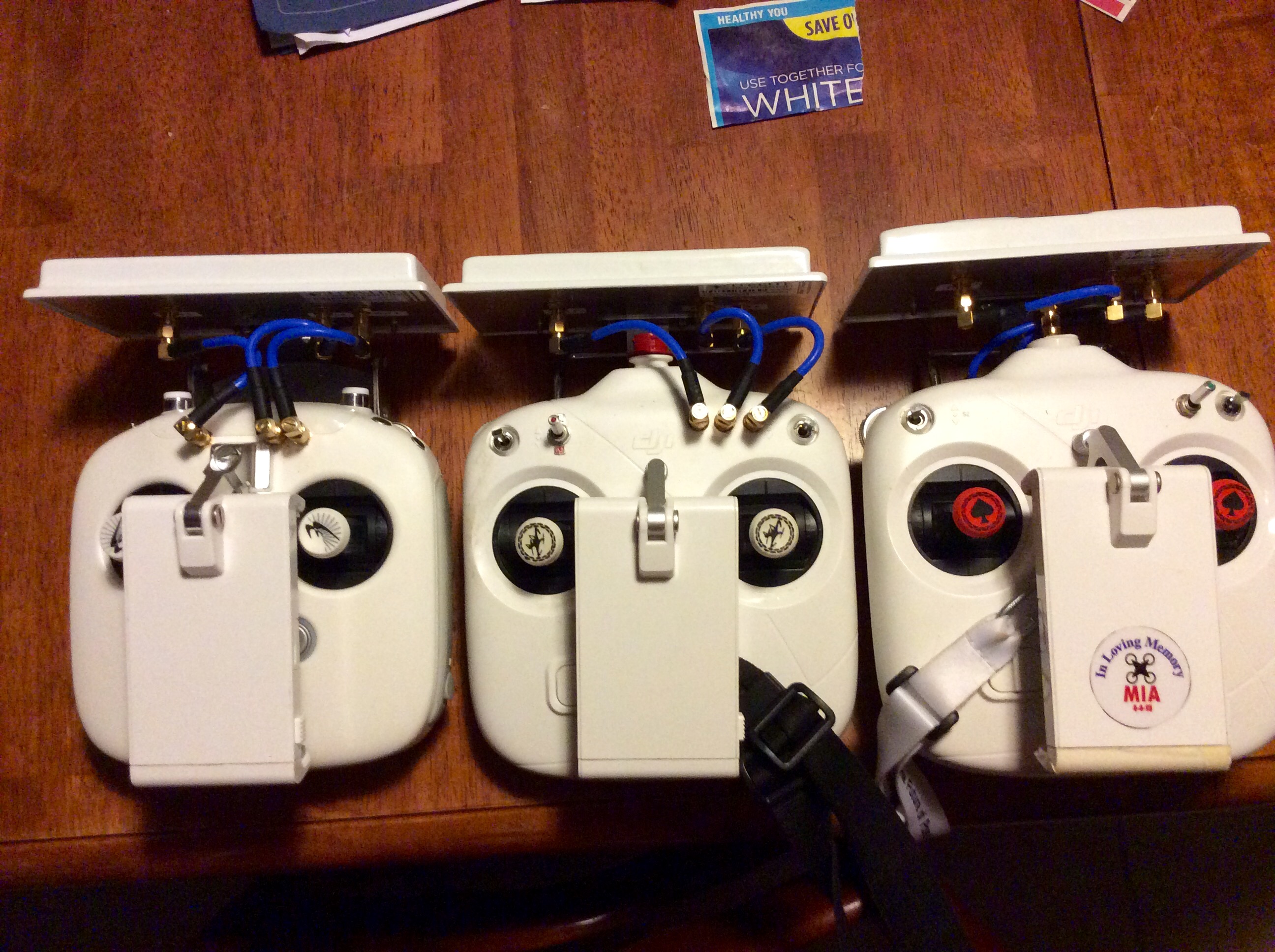

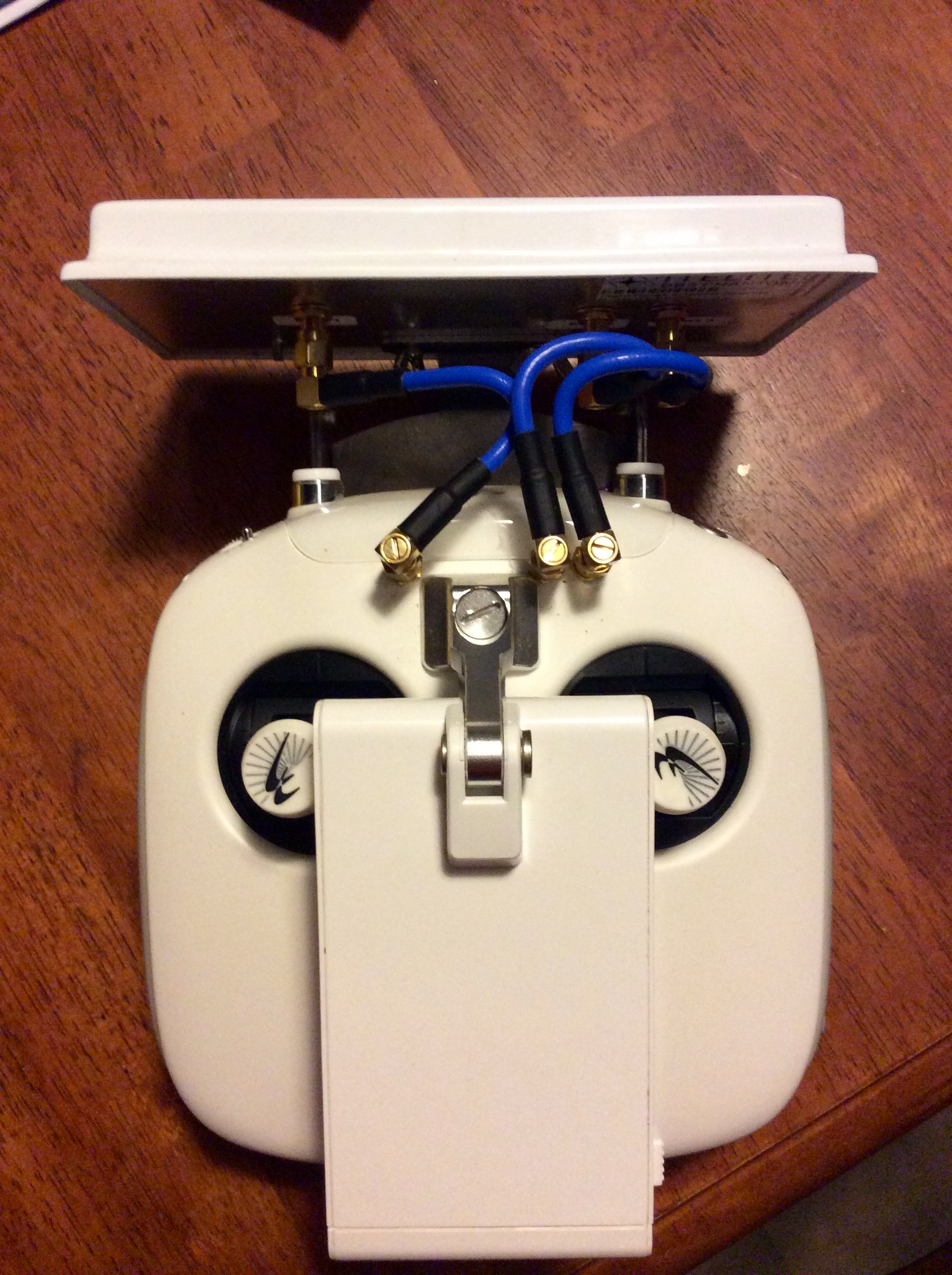

This is my 4K and I cut the bracket down b.jpg so it would be the same height as my others c.jpg the one on the right
is my P2V TX . I just have the extender mounted to the bottom

Nice clean setup. So no booster right? You probably don't need one in Mississippi... Is the RG402 blue SMA cable make any different than the original one from dbs?

No boosters and yes the blue ones got me more distance here .
