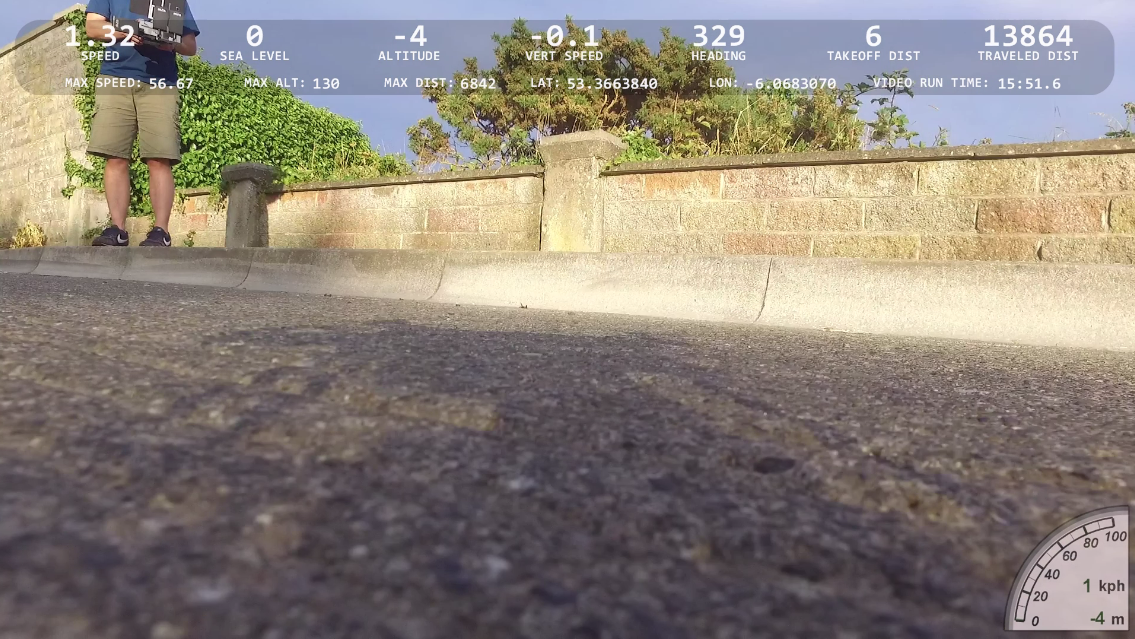

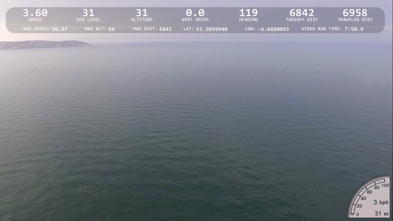

Nothing like you see on youtube where miraculously a P3S goes 10 miles (LOL) BUT; Did manage over 1600+ Metres (5300 feet). Tested during one of my YouTube vlogs out at a dam, clear of obstructions;
10 miles - Surely the standard battery would not last that distance?
Above distances in metres
Today achieved 13684 metres 44,895 feet total - landing with 8% - at an almost constant 53-54kmph. Unless additional batteries have been fitted. A ten mile distance is beyond the capabilities of the standard batteries and seems almost beyond belief
10 miles - Surely the standard battery would not last that distance? Today achieved 8.4 miles / 13.51 km / 44,360 feet total - landing with 8% - at an almost constant 53-54kmph. Unless additional batteries have been fitted, this distance almost seems beyond belief

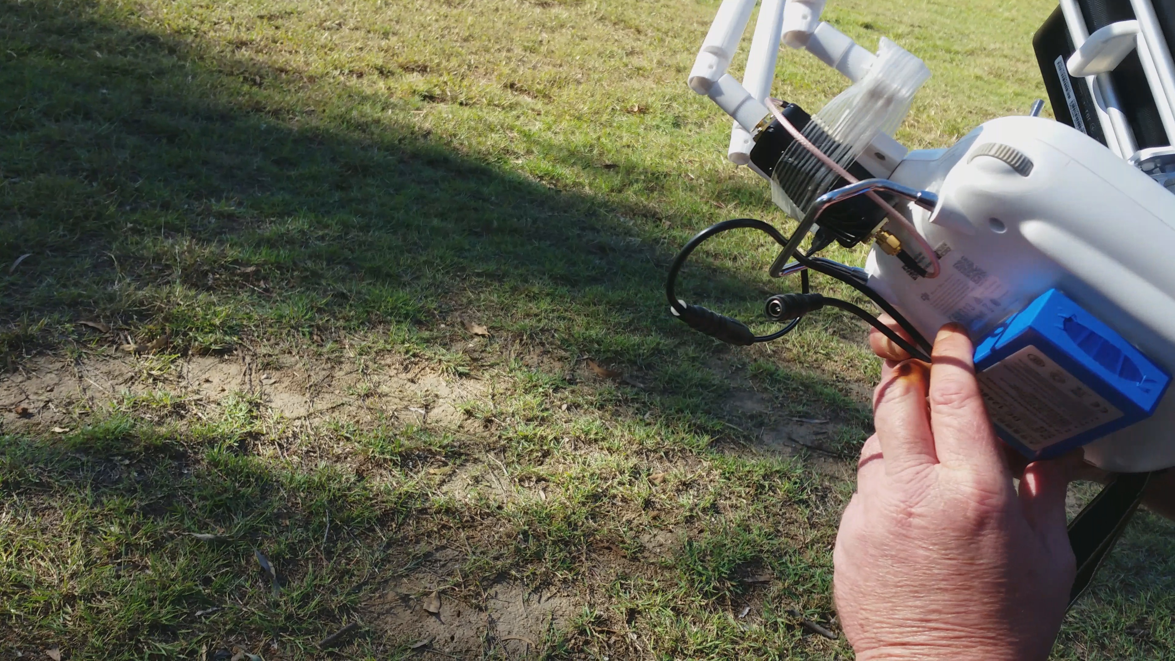

If you pay travel then you have a deal - configuration below - Magic Power plus Sunhans x3 plus replacement of internal cables with shielded ones plus Alfa APA M25 x3 - you can do the same and achieve the same outcome

If you pay travel then you have a deal - configuration below - Magic Power plus Sunhans x3 plus replacement of internal cables with shielded ones plus Alfa APA M25 x3 - you can do the same and achieve the same outcome - people dont experiment enough these daysView attachment 101107 View attachment 101109 View attachment 101110

Had tried Argtek which was total junk then tried Itelite DBS which was very overpriced and resulted in too narrow a signal band which is impractical in anything other than straight line use. Then tried Alfa APA M25 and 2x Alfa APA M04. This took me out to 5.2km. Then I tried 3 x APA M25 and havent looked back since. I never ran out of signal on the way out using Alfa M25. Battery is the sole limiting factor on distance The return journey is another story as the video antenna is located to the rear of the drone in the area of the battery housing causing intermittent signal loss. A great drone once you figure how to get the best out of it.

6842 metres linear distance out
13684 metres total linear distance return
