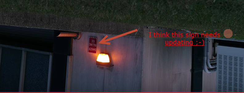

Im just a newb so forgive my crude description but a few things came into play here and the flight log/record In the app only tracked it so far as you can see from the pictures I uploaded early yesterday show, it just disappears at the edge of the park on the waterfront after taking the great advice on what I needed to do to track it a lot deeper was to get into my phone which tracked it to the exact spot that was circled in a picture posted by a very helpful forum member . I'm sure I had OA enabled because I was testing it out because n a football field on the stadium lighting poles last weekend and it worked fine but I didn't lose GPS and I wasn't in RTH either so it don't really matter much but I'd really like to understand everything that happened yesterday and maybe DJI will shed a little light on it to as to the cause of it .
I'm still having a hard time believing I recovered it .
