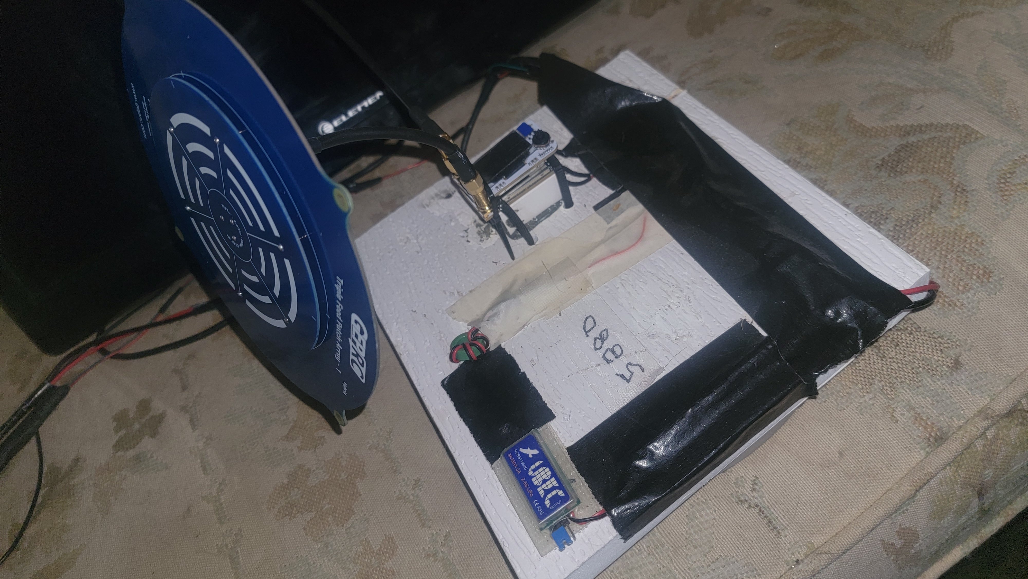

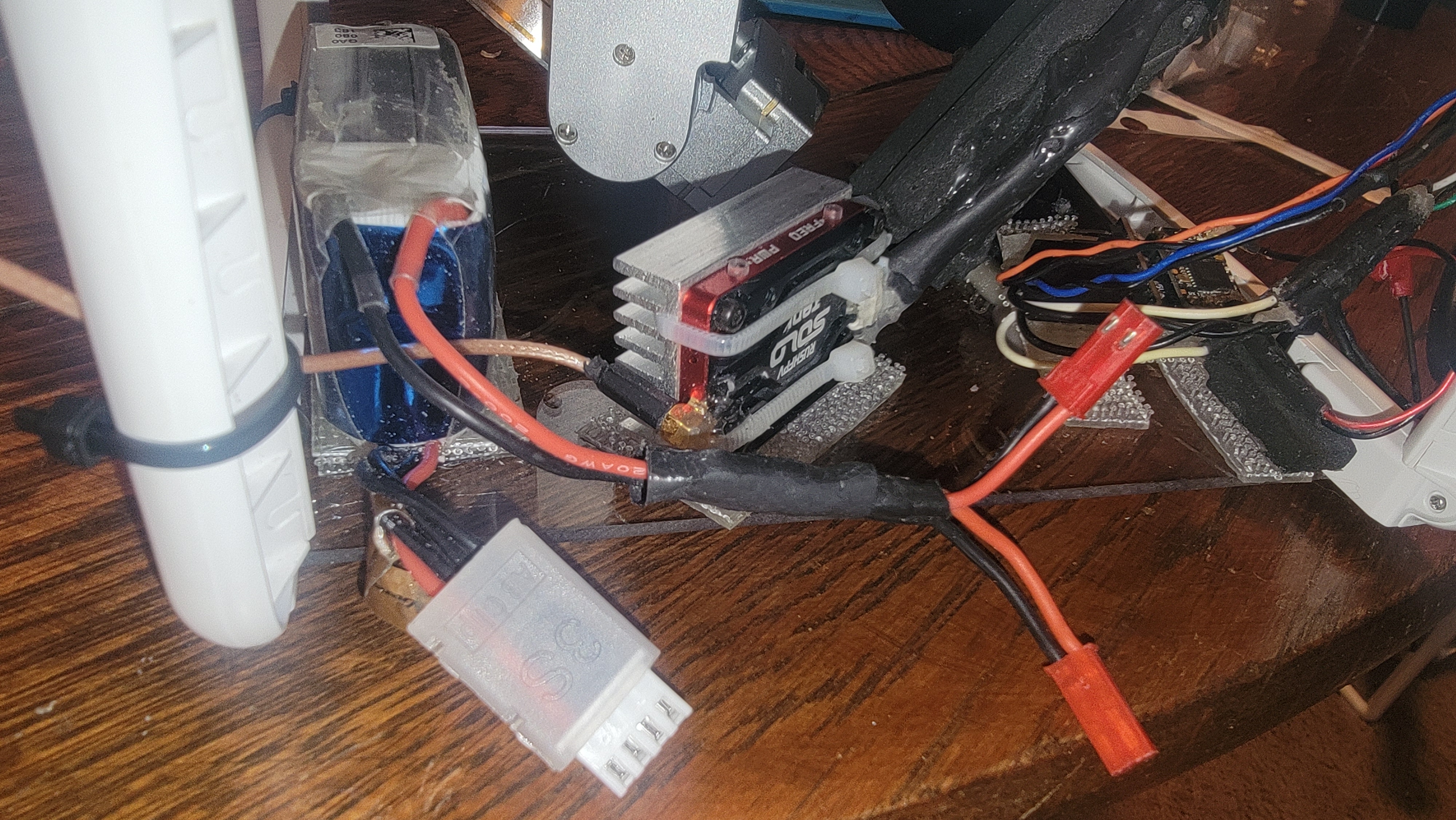

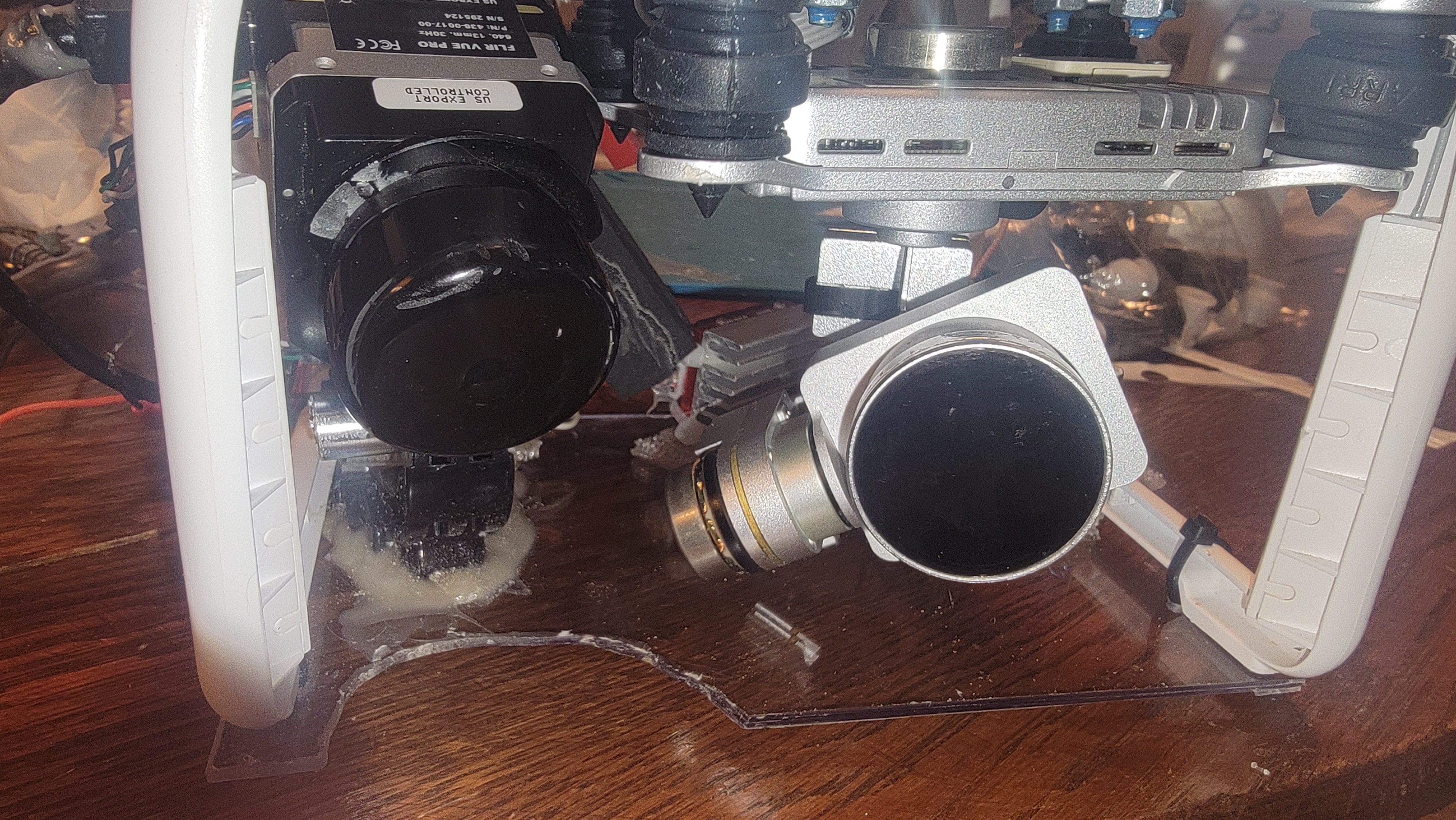

Tiny Blacksheep NANO pcm handles the cameras settings with a Mamba Crossfire RC. The 4 switches across the top do the 8 camera settings. Various settings are programmed with the Flir app. Flir documentation calls for MAVLINK, but I get GPS data from the drone app so i didnt go with it. Flir GPS data is only encoded on still photos, not on video file. I can screenshot the app to record GPS in a SAR situation. The video transmitter is TANK SOLO mounted on a heat sink. The ground station is a RAPIDFIRE diversity goggle module only, no goggles, wired to a large monitor. Flight time is reduced by approx 20 %. I'm in hill country so range is limited. Have not tested video range on flat ground.

Other data is missing, such as the battery and satellite data, so it's just not the video feed. I'd remove the camera from the gimbal and see what happens, but I don't want to mess with the flat cable.

Both apps work fine when the gimbal and camera are on the drone.

Good info. It appears that you can remove the camera but keep the gimbal and have proper app flight functions. Saves weight and makes room for a different camera.
