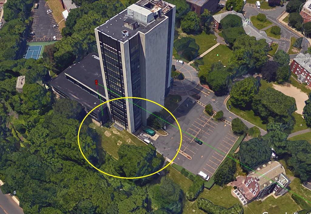

Ouch. That hurts to watch. You can see the nice flight out then it loses the signal and stops. Waits three seconds, turns around and then we all see "The Building".
Arrrrrrgh.
The detective work by the guys here is very impressive for sure. Nice job in tracking it down and once again, thanks for posting the video.
Hopefully more people will get the idea to make sure the RTH altitude is "correct" after viewing this.

My tip is as you gain altitude from take off point, do a 360 degree turn as you climb before you move forward and make a note of the height of the tallest building as you climb. From this point open the menu setting on dji app and providing your judgements are reasonable then add another 30 foot to the height and use that as the return to home height and off you fly. That way you will know worst case scenario you will avoid the buildings etc.
That sounds like a great idea , I think I'm gonna be taking babysteps for a while after today , the RTH didnt really do what I thought it would do which is follow the same path I took to get there . I have no problem admitting I have a lot to learn
For me this is the way forward as I would rather know my return to home (rth) height is clear of all obstacles, even better that as there is a bug in the rth feature at least when the craft is flown below rth height it also will not climb above this height and waste vital battery if at distance.

As you know by now, a higher RTH altitude setting would have been appropriate. But still, looking at your return trip it appears that OA just flat failed. According to the manual the unit should have stopped and climbed vertically to clear the building. Are you certain you had it activated?
As to the split video, there is apparently still a 4 GB individual file size limit even though exFAT will support larger file sizes. Unless you meant 'does it always split up into parts' when it hits a building, in which case the answer is often yes.
well said, theres a lot to learn. while its always good practice to set your rth height, it would have been nice if it did follow its path out for sure...
also it might have been too dark for object avoidance.
At least the battery didn't pop out!
The proper RTH altitude is 'higher than anything in your return path.'
