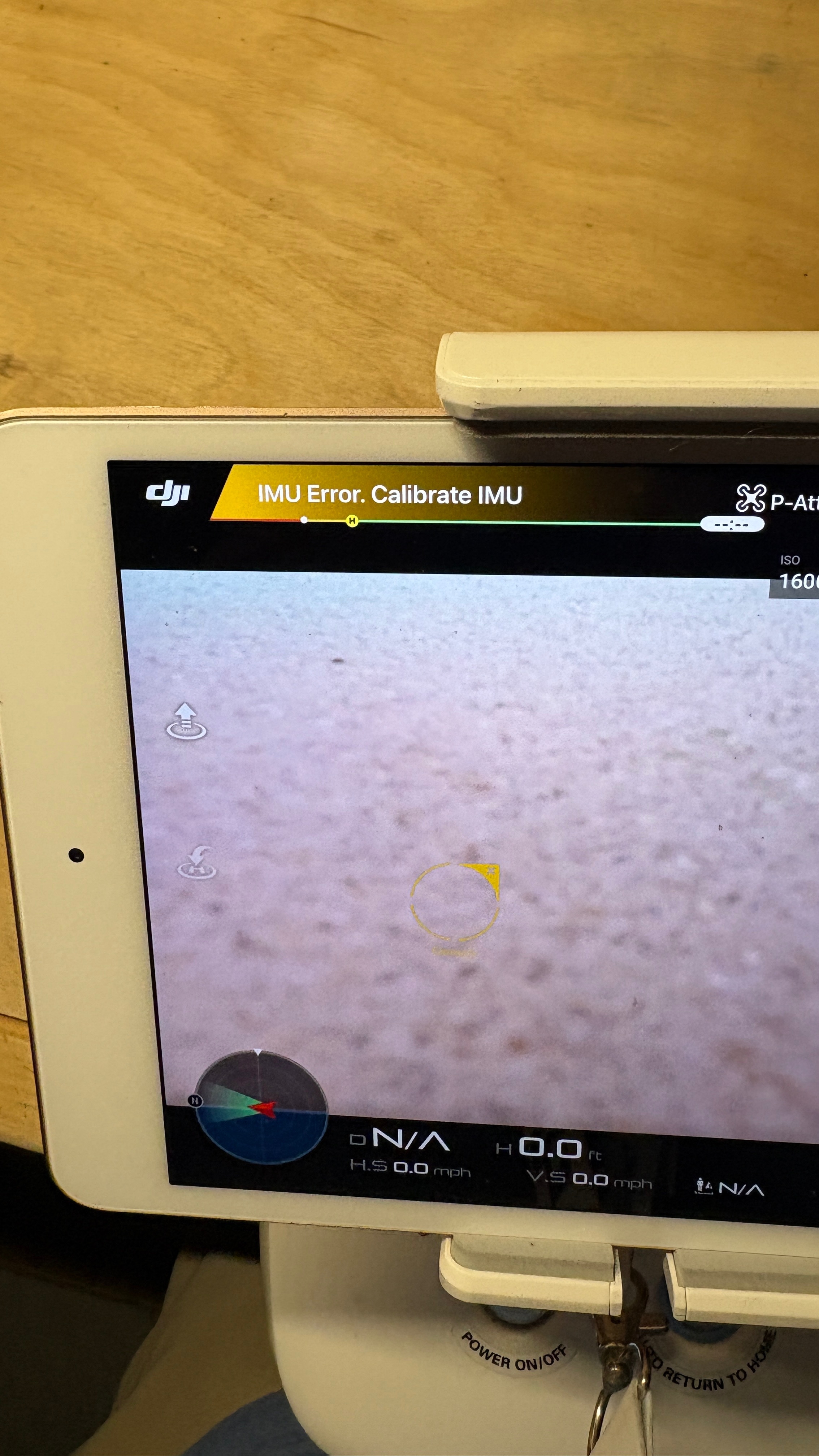

So have a Phantom 3 Advance. Bought in 2016 and it only has 15 hours on it. I am anxious to fly it more but deal with IMU error for the past year and sometimes it flies and sometimes it does not and no matter how many times I calibrate it is a hit or miss or I put it away until another day. So I am hoping her I can find the permanent solution and start flying again or just move on to a newer model. It is in excellent condition except this. Anybody have any ideas? Appreciate any and all help.

I think there is a lot more info available regarding the IMU then that screen. I have been out of it for awhile.

What are your gyro mod values on the sensor screen? Is Gyroscope Mod around 0.00 and Acceleration Mod around 1.00?
If they are out of whack, perhaps the accelerometer is stuck. Tapping on the IMU has worked for many here on the forum. Maybe you'll get lucky as well.
I'm also assuming that you are doing the calibration on a perfectly level surface.
