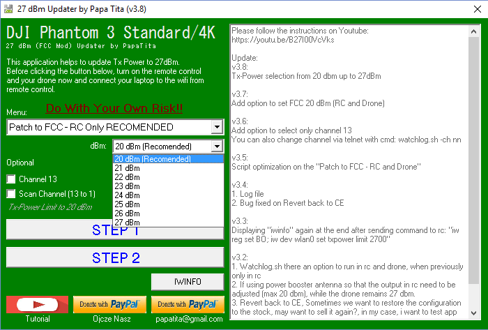

Sorry I created new thread to answer many questions about application windows DJIUpdate.exe, this app used to raise Tx-Power 2.4 GHz up to 27 dBm.
With new mod 2.4Ghz then video/live streaming so the better, minimize lag and unexpected effects became more far-reaching.
The application works with inject script (watchlog.sh) into the device and then run in djiled.sh
View attachment 63914 View attachment 63915
Additional features (DJIUpdate v3.6):
  1. Unlock channel 13
  2. Automatic Channel Scan (13-1)
  3. Change Channel Manually (1-13)
  4. Limit 20dBm (for user signal booster / amp).
  5. Revert Back to CE (restore to default / Stock)
  6. FCC Mode (20 dBm)
  7. Tx-Power selection from 20 dBm up to 27 dBm

Technical discussions about how the mod please ask to existing topics: Phantom 3 Standard range mod , let's do it together...

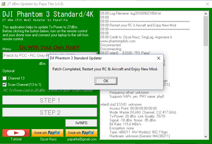

Hello all!
I want just to check that I have done everything correct.
Here is 2 screenshots of telnet.
192.168.1 (RC) and another is 192.168.1.2 (AC)
I'm good to go(fcc)?? I live in CE area.
Doesn't that "country US: DFS-FCC" mean that it uses FCC power to 5.8 GHz also?

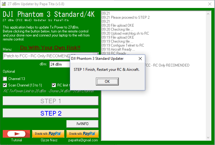

step 1 add telnet command, then telnet test performed at step 2. therefore after step 1 should be restart.
Step 2 fail, maybe you are too fast running step 2 when connection to wifi is happening.

I keep getting error "Cannot telnet to RC". I've tried it several times, including reboot etc., but still no luck. What am I doing wrong here?
P3 4k and keep getting this error. following all video steps. Something different for my bird? Ran fine on my P3s. Have not updated firmware from box.
Hello all!
I have the same thought with you, i select region US and double.check with telnet again, yes it is written US, but still i lose signal 5,8ghz under 500-600M , i'm also searching how to check the 5,8ghz dbm
