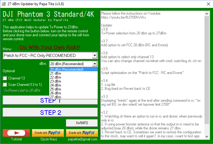

overheat because of this:

Before using scan channel or channel 13 should be tested first whether the support channel 13, like this:

DJIUpdate versi 3.8:
- Tx-Power selection from 20 dBm up to 27 dBm
** This may be the last update.
PapaTita, Thaks a lot for the update! I was testing the new version and I have a doubt, if I change the box to scan channel 13 to 1 the text on the right textbox shouldn't change to SCAN="Y" ? in my version it will always display SCAN="N"
