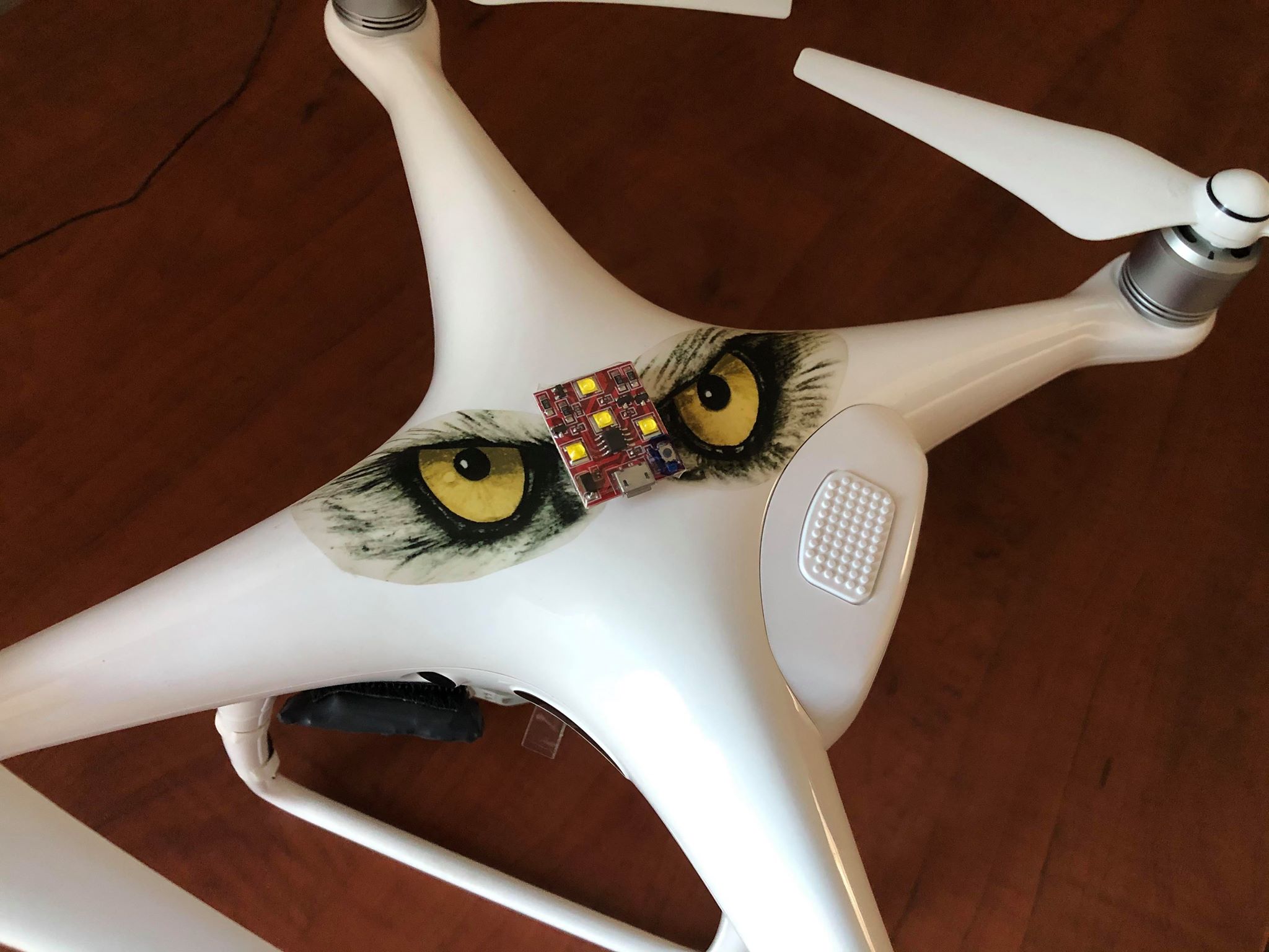

Smack in the middle. Doesn't interfere with my GPS, but I wouldn't mount anything larger. I found some clear velcro (hook side) that holds really well. The eye decals had been previously added also as a bird deterrent, since most birds that I have observed in nature prefer to attack from the rear and above -- mainly when their prey isn't looking at them. My work sometimes takes me to remote locations, so I need my drone to be as bird deterrent as possible. I agree the P4P has very limited locations to mount a strobe that doesn't interfere with the vision system.
I know someone is probably going to ask where I got the eye decals. I happen to be a graphic artist for an environmental firm (hence the drone flying) and had some clear peel-off sheets that can be put through a color copier/printer. I found those menacing hawk eyes via a Google image search, printed them on a peel-off sheet, and applied them as a decal to give my P4P a "Don't even THINK about it!" look.
