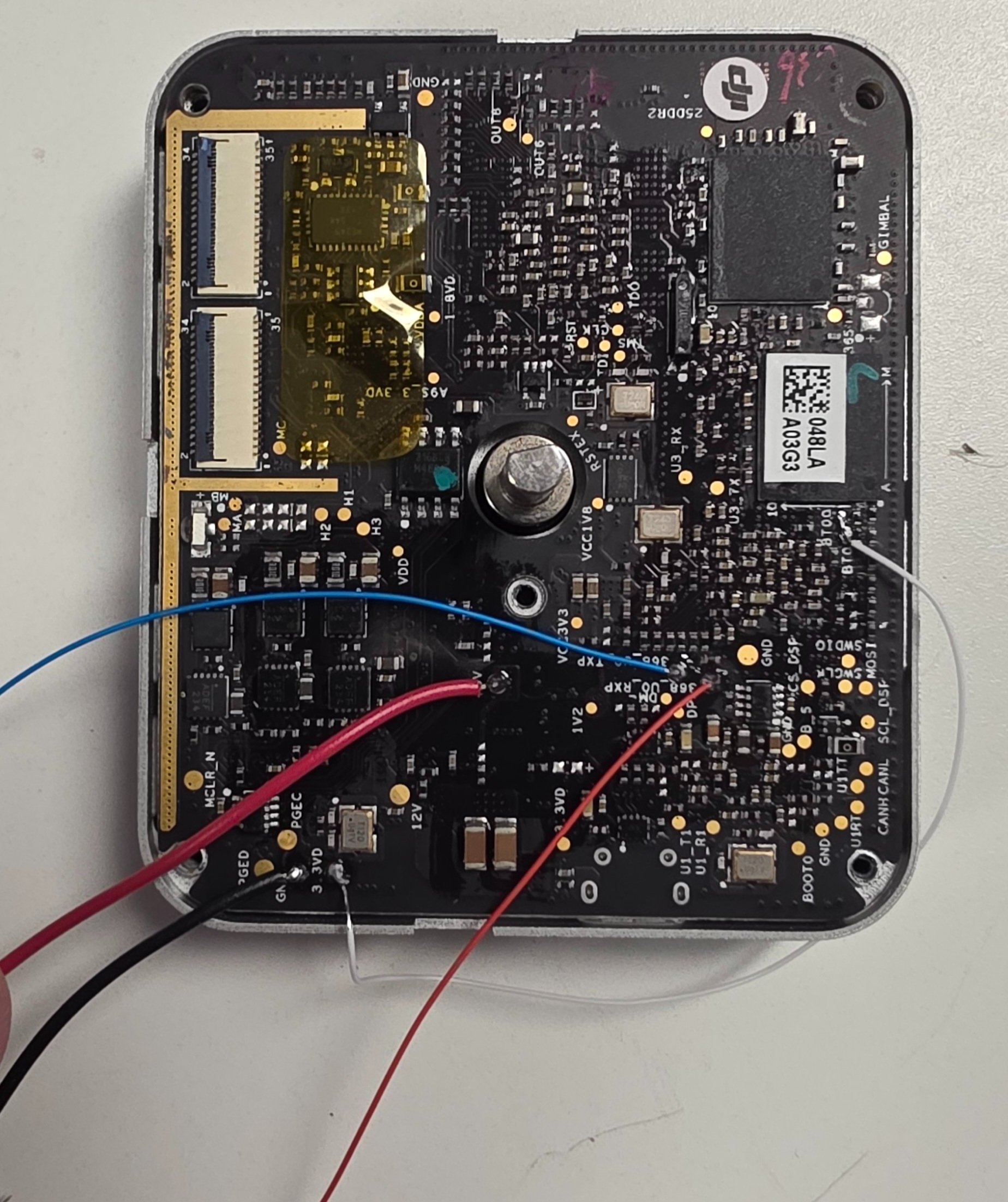

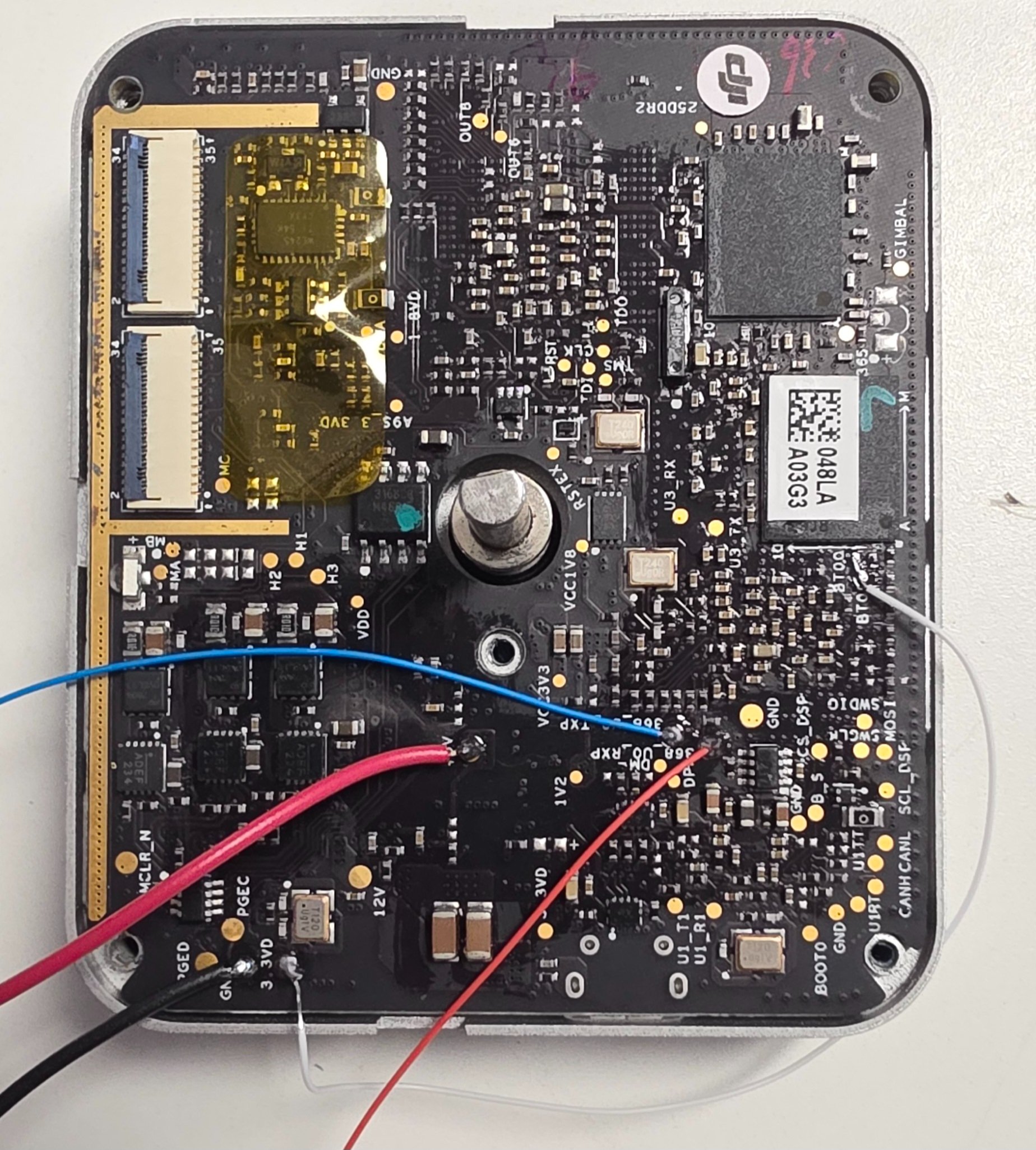

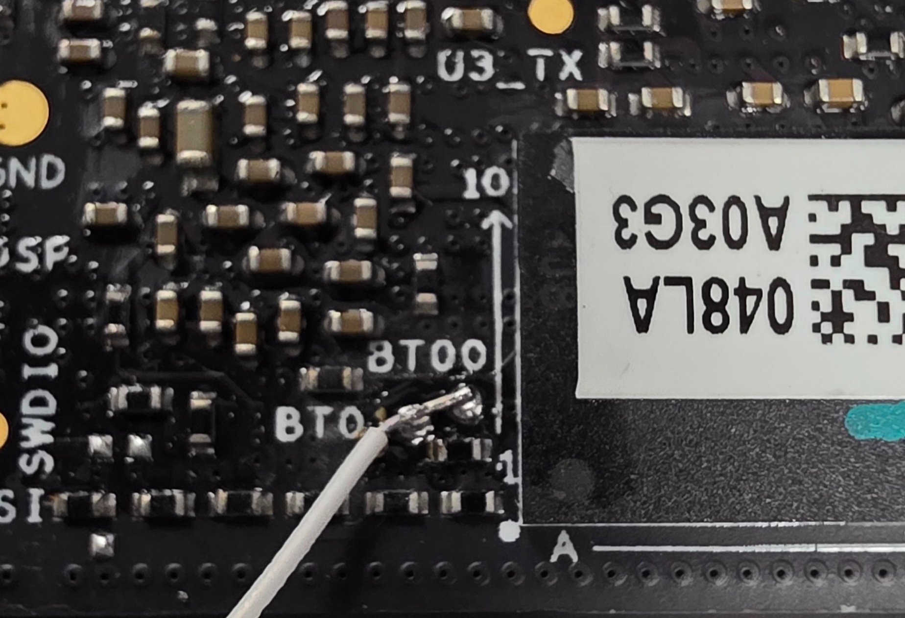

ok, I connected the wires to the Gimbal Top board, BTW mine is the P01069.07.
I've used an ST Nucleo board as USB to TTL. I've run the following command twice:
sfh -nandflash -v -p "COM33" ubl1.img u-boot.img
The first time I've got the BOOTME message, the second time at the end I got the following BAD message:
Sending the UBL image
Waiting for SENDIMG sequence...
Target: NAND_open() failed!Starting UART Boot...
Target: BOOTUBL
Please help understand what I should do to repair this issue.
Thanks a lot in advance!

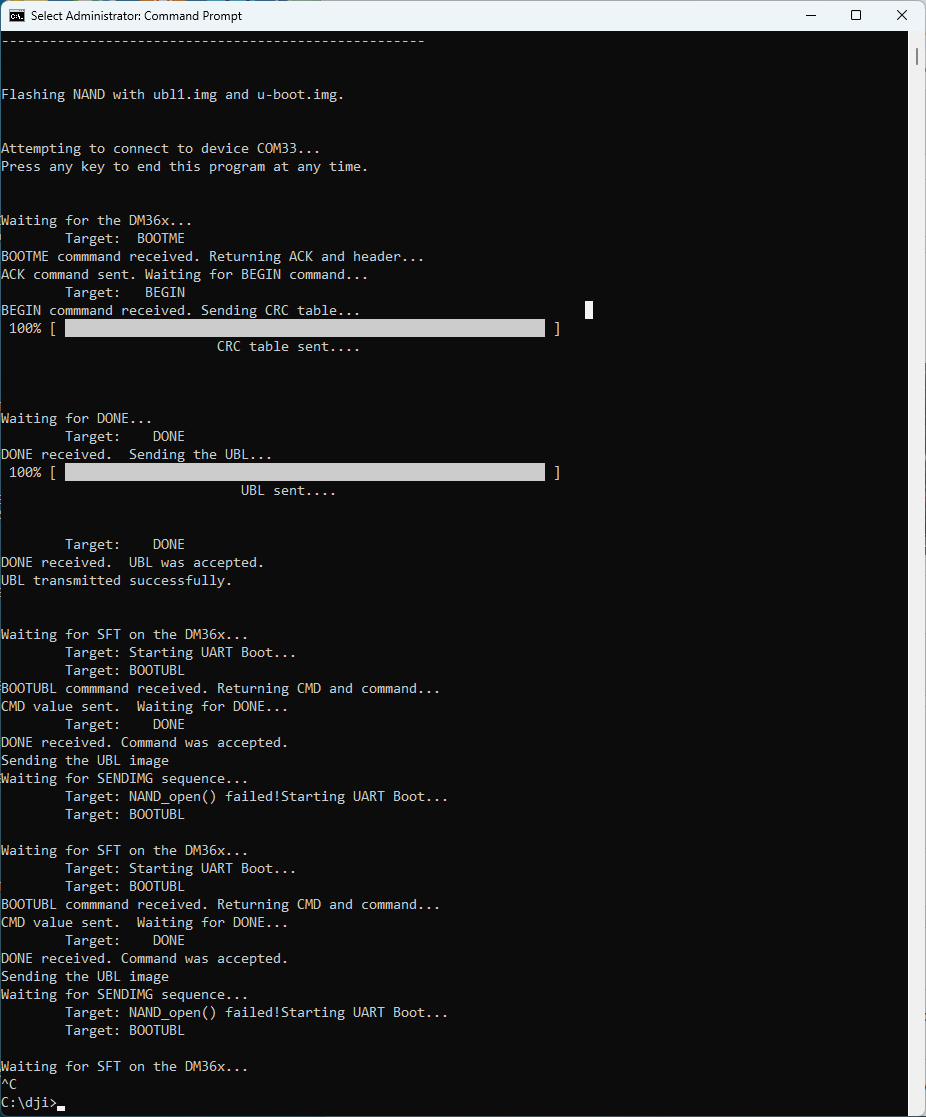

Here is the log from the command prompt:
TI Serial Flasher Host Program for DM36x
(C) 2009, Texas Instruments, Inc.
Ver. 1.50
Flashing NAND with ubl1.img and u-boot.img.
Attempting to connect to device COM33...
Press any key to end this program at any time.
Waiting for the DM36x...
Target: BOOTME
BOOTME commmand received. Returning ACK and header...
ACK command sent. Waiting for BEGIN command...
Target: BEGIN
BEGIN commmand received. Sending CRC table...
100% [ ]
CRC table sent....
Waiting for DONE...
Target: DONE
DONE received. Sending the UBL...
100% [ ]
UBL sent....
Target: DONE
DONE received. UBL was accepted.
UBL transmitted successfully.
Waiting for SFT on the DM36x...
Target: BOOTME
Target: BOOTME
Target: BOOTME
Target: BOOTME
Target: BOOTME
^C

Target: BOOTME
Target: BOOTME
Target: BOOTME
Target: BOOTME
Target: BOOTME
Target: BOOTME
Target: BOOTME
Target: BOOTME
Target: BOOTME
Target: BOOTME
Target: BOOTME
Target: BOOTME
Target: BOOTME
Target: BOOTME
Target: BOOTME
Target: BOOTME
Target: BOOTME
Target: BOOTME
Target: BOOTME
Target: BOOTME
Target: BOOTME
Target: BOOTME
Target: BOOTME
Target: BOOTME
Target: BOOTME
Target: BOOTME
Target: BOOTME
Target: BOOTME
Target: BOOTME
Target: BOOTME
Target: BOOTME
Target: BOOTME
Target: BOOTME
Target: BOOTME
Target: BOOTME
Target: BOOTME
Target: BOOTME
Target: BOOTME
Target: BOOTME
Target: BOOTME
Target: BOOTME
Target: BOOTME
Target: BOOTME
Target: BOOTME
Target: BOOTME
Target: BOOTME
Target: BOOTME
Target: BOOTME
Target: BOOTME
Target: BOOTME
Target: BOOTME
Target: BOOTME
Target: BOOTME
Target: BOOTME
Target: BOOTME
Target: BOOTME
Target: BOOTME
Target: BOOTME
Target: BOOTME
Target: BOOTME
Target: BOOTME
Target: BOOTME
Target: BOOTME
Target: BOOTME
Target: BOOTME
Target: BOOTME
Target: BOOTME
Target: BOOTME
Target: BOOTME
Target: BOOTME
Target: BOOTME
Target: BOOTME
Target: BOOTME
Target: BOOTME
Target: BOOTME
Target: BOOTME
Target: BOOTME
Target: BOOTME
Target: BOOTME
Target: BOOTME
Target: BOOTME
Target: BOOTME
Target: BOOTME
Target: BOOTME
Target: BOOTME
Target: BOOTME
Target: BEGIN
Target: CORRUPT
Target: BOOTME
Target: BEGIN
100% [ ]
CRC table sent....
Waiting for DONE...
Target: DONE
100% [ ]
UBL sent....
Target: DONE
Target: Starting UART Boot...
Target: BOOTUBL
BOOTUBL commmand received. Returning CMD and command...
CMD value sent. Waiting for DONE...
Target: DONE
DONE received. Command was accepted.
Target: BOOTUBL
Target: BOOTUBL
Target: DONE
Target: BOOTUBL
Here the pictures of the soldered wires

Code:
NAND_open() failed!
This is a hardware issue between DaVinci chip and the NAND chip.
Looks like your only hope is this instruction, then:
You can try reflowing the chip (putting soldering paste around and heating it up so that maybe it will re-settle on the contact points), and if that won't help then the only option is NAND replacement.
Code:
NAND_open() failed!
