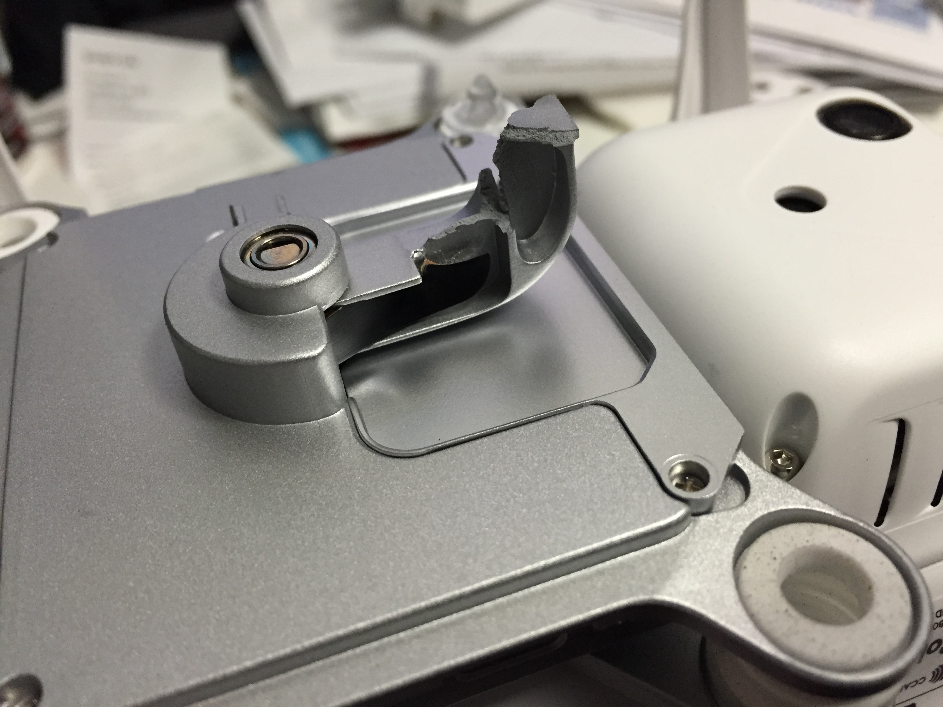

Yeah, I am really disappointed. I planned a trip to the mountains tomorrow and was going to use my Phantom 3 Professional to capture some awesome video. I took her out today to make sure everything was set and running well. It was a beautiful day and everything was running fine. I've been practicing flying specifically from viewing the screen and my skill has been getting better and better, as well as my confidence. And then I got sloppy...
I was flying my bird around a track and mis-judged my speed going into a turn. It went wide and hit a tree branch at about 15 feet high. It fell to the ground and my stomach sunk. I made the long walk of shame over to my phantom and saw that the gimbal had cracked off. Everything else was fine. I put the drone on the ground and restarted her and she flew perfectly. I just have no camera anymore. I've included some pics of the damage.
So now what do I do? My whole day of plans for tomorrow is screwed. I'm probably going to end up buying another Phantom until I can figure out what to do with this one. Can I fix this? Can I replace the gimbal? I read that this is a very popular problem for those who have crashed their phantoms. It seems as though the gimbal breaks at the same spot.
Any advice is appreciated. Thanks for taking the time to help out.
View attachment 25811 View attachment 25812 View attachment 25813

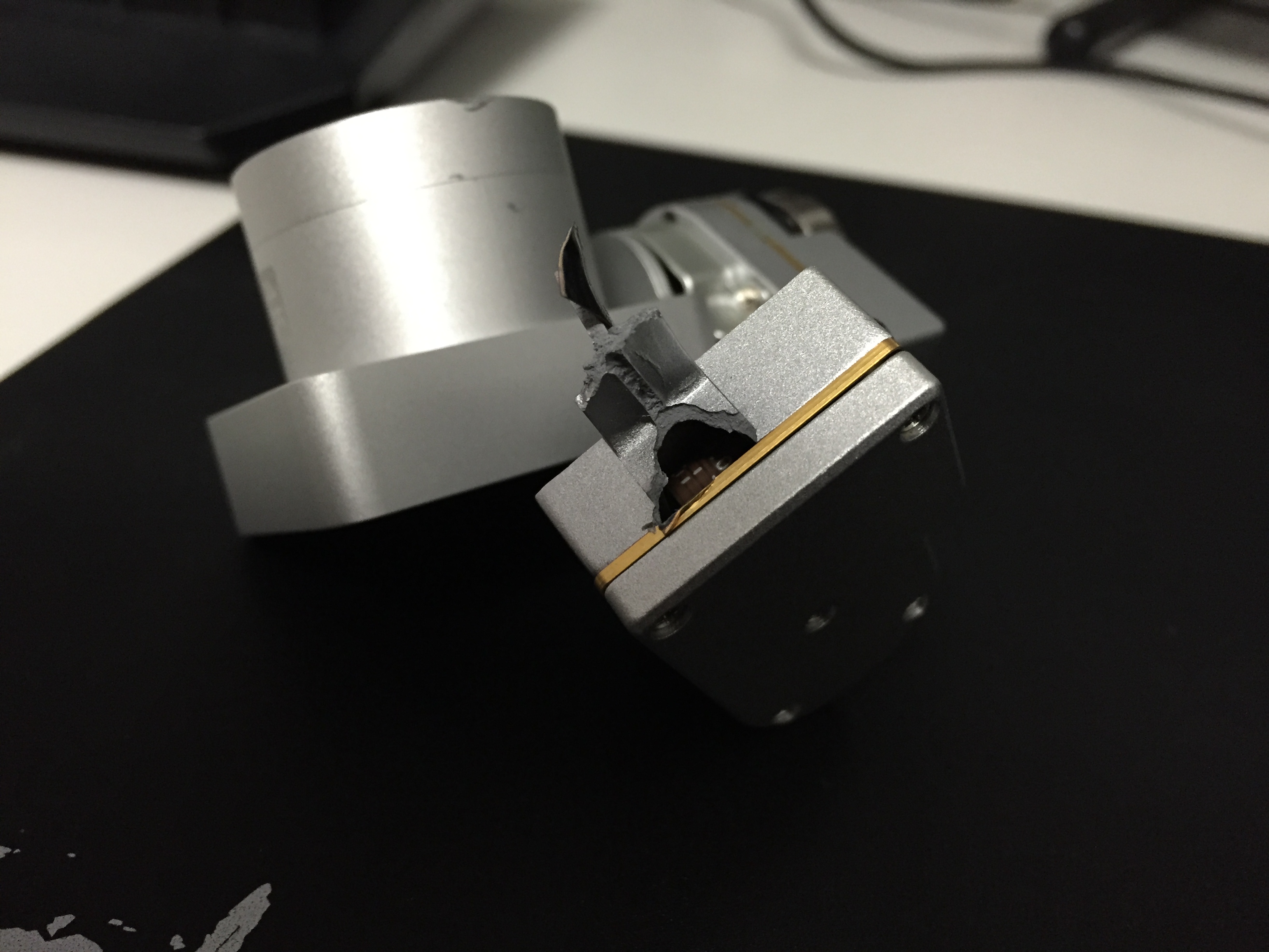

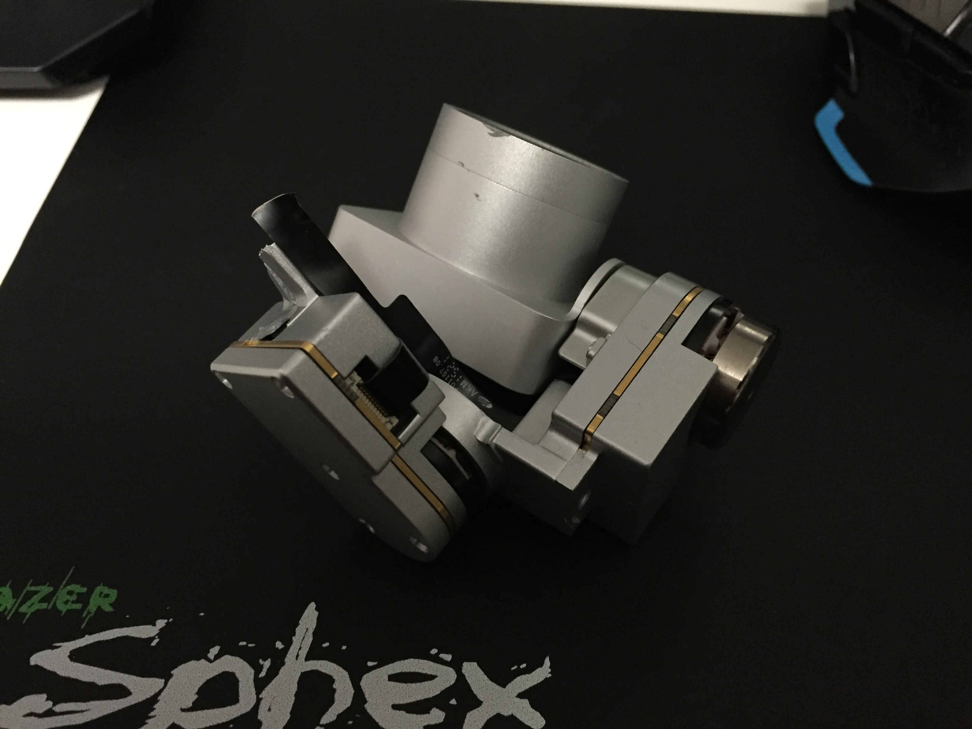

I ended up with the exact problem, the gimbal broke off at that common area. However my ribbon is all intact and still attached.
Motors are still working and I can fly. However I can't seem to see any image from the camera. System status shows gimbal gyro error and needs me to send to DJI technician.
My question is, is the camera off because the gimbal gyro has a problem?
For example, drone start up->gimbal check->camera turn on
I really need to know because at this point I have no idea if the camera is gone.
My dealer says the bracket might be available next week so I'm thinking of just replacing it and then recalibration the imu and gimbal. And hopefully the camera turns on.
Sucks that I crashed it only 2 days after I bought it. I don't know how to tell my wife!
Anyway, here's a link to my video that I created on my very first day with the drone:
See my beautiful Singapore!
By the way this is how the broken gimbal bracket looks.
In the 2nd picture I used a thin strip of masking tape to hold the parts together to see if the gimbal startup calibration would work and turn the camera on.
However it did not even move one bit.

Garry, come and join us at Universal Drone Singapore. Search our Group on Facebook. We can help you to fix your gimbal (it is repairable) and give you some tips about flying in Singapore (I see you flew in Chinese Garden that is not really allowed, but some of us are flying there from time to time). Anyway, we can share advices and we also have our FlyMeet.
