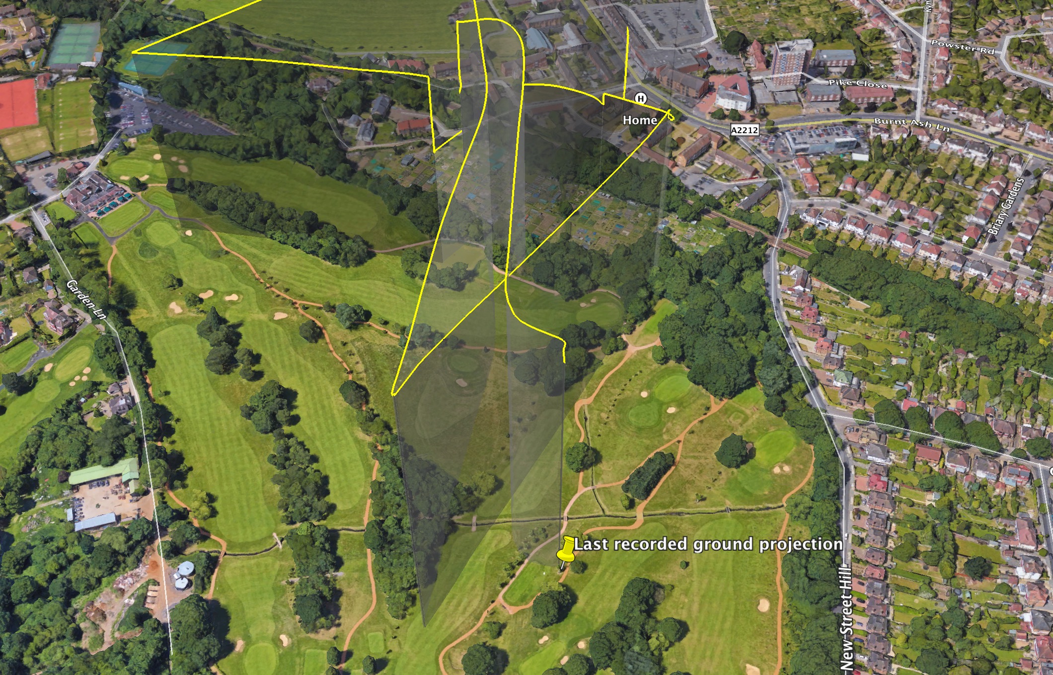

These are the last two flights recorded in the DB set that you uploaded, both flown on Feb 27, and DJIFlightRecord_2018-02-27_[14-46-59].txt corresponds to the flight that you previously linked to in AirData. It ends quite abruptly at an altitude of 172 m, with no indication of any particular problems. Assuming that is the correct flight, presumably the downlink disconnected before the crash, because you have video from the aircraft of that event. Does the end of that track look like approximately the correct crash location? If the aircraft was disconnected when it fell then the only available data will be in the .DAT file on the aircraft itself.
Reactions: Neon Euc
Spot on. Thanks sar104. Here's the odd thing. The SD card recorded the footage of it falling, and yet stopped recording before it hit the ground. At first I thought it could be the battery cutting out causing it to fall, but then it wouldn't record as it fell so I am mystified on this. How was my stick inputs? Did I accidentally cut the motors? Sorry for asking as I know its a bit of a hassle but I would love to know if this will be human error which I will accept if it is
There is no evidence in the log of any problematic stick inputs, and even a CS would not have stopped logging. Can you get the DAT fie off the aircraft? That will give the definitive answer.
