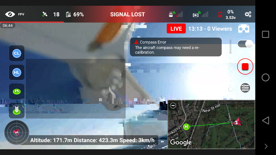

Its really bizzare... This is the screen shot I took as it crashed. You can see the horizon in the background badly tilted
The other thing is, even tho it says signal lost on that screen shot, I know the battery didn't get disconnected as it was still turned on and bleeping as I found it 10 mins after the crash. And it recorded the crash pretty much all the way through on the SD card. Would love to see what DJI comes back with. Just as a last resort... Was my stick input OK? I didn't accidentally cut it out in mid air or anything did I? [emoji33]
Its really bizzare... This is the screen shot I took as it crashed. You can see the horizon in the background badly tilted View attachment 95673
Now I'm confused again. That screen shot is not consistent with the log (DJIFlightRecord_2018-02-21_[14-31-25].txt). The log indicates the maximum distance was 369 m and the maximum altitude was 133 m. And the crash itself was not recorded in that log.
OK - the AirData link that you posted above is to a different flight again which does look consistent with your screenshot and has some signal issues. Unfortunately you did not enable sharing of the log file, so it's still hard to diagnose.
