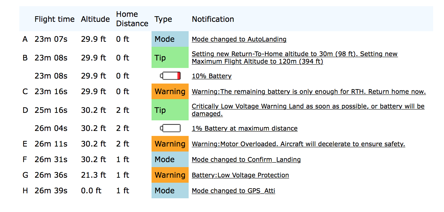

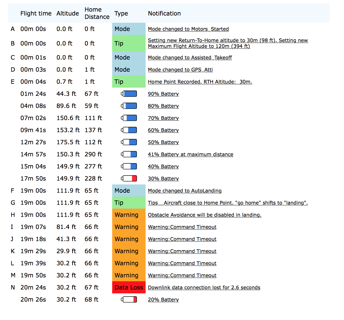

Sorry for the delay - but I pretty much didn't touch the drone until today.
Aircraft: 01.05.0600
Remote: 01.04.01.00
App (iOS): 4.2.12
Also, I uploaded my flight log to airdata, which I haven't used in a while. It looks like the troubled flight got divided into two logs. In the first flight I took off with a full battery and was getting ready to land around at around 30%. The drone was 65 ft away from me when I received the Command Timeout warning. The log then shut down after a memory loss at 20% battery and then a second log started from the time the drone was not responsive until it auto-landed, luckily on a roof nearby that I could access. Uploaded to screenshots here.
I am probably going to take it for a quick flight soon. I'll recalibrate the IMU and compass. I can say that I was standing behind the village power lines while maintaining eye contact with the drone, when I was moving to land it I walked below the power lines to the street, it could be that I was moving in an area with higher reception area compared to where I usually fly in that area.
Cheers!

Hello,
POI, as it relates to the issue you had initially reported regarding a loss of control of your P4P.
It has been suggested, and I concur, you may best opt to re-flash your present A/C f/w version to preclude this issue from possibly occurring once again.
" An ounce of prevention is worth a pound of cure".
To maximize success in your efforts, first format the A/C SD card, then follow the normal procedures to update the versions of f/w in both model and radio controller as you had previously. Afterward, you may want to perform all necessary calibrations suggested, particularly after performing various updates. eg. IMU, Compass, Camera Gimbal, & Radio Controller calibrations, as necessary.
Hopefully, by taking these precautionary steps you may then prevent any future issues similar to what you had experienced.
