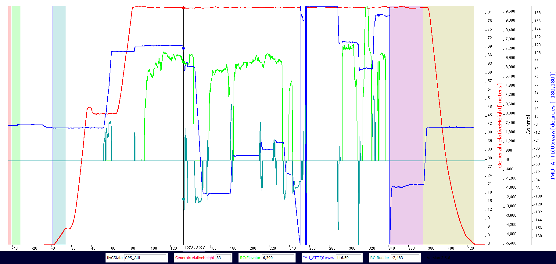

Can someone please look at my DAT file to see why my drone wont fly straight
Oct 2, 2019
42
5
31
I have tried everything possible and I can't get this thing to fly straight. Calibrated the IMU, Compass, Remote, changed propellers, Calibrated gimbal, Camera seems to be looking straight.
This was my latest flight.

@blong10 ..First, you have too many rudder inputs in this flight to clearly see drift. You need to try another flight, but this time make sure of the following: 1) Very light or no wind ( Check you local conditions and notate those ) 2) Also keep in mind that wind will increase with altitude, so lower your altitude to ~200ft or less if possible. 3) Fly up to altitude and use ONLY the elevator to fly a straight path. Do not touch the left stick for at least 30-40 seconds. 4) Following the flight, upload your .txt log from the flight to the link here: Log Viewer . Be sure to share a link to that back here.
Lastly, also upload the .dat from the flight as you did above. This way we can look at the initial transmitted data and compare that to the aircraft data for drift.

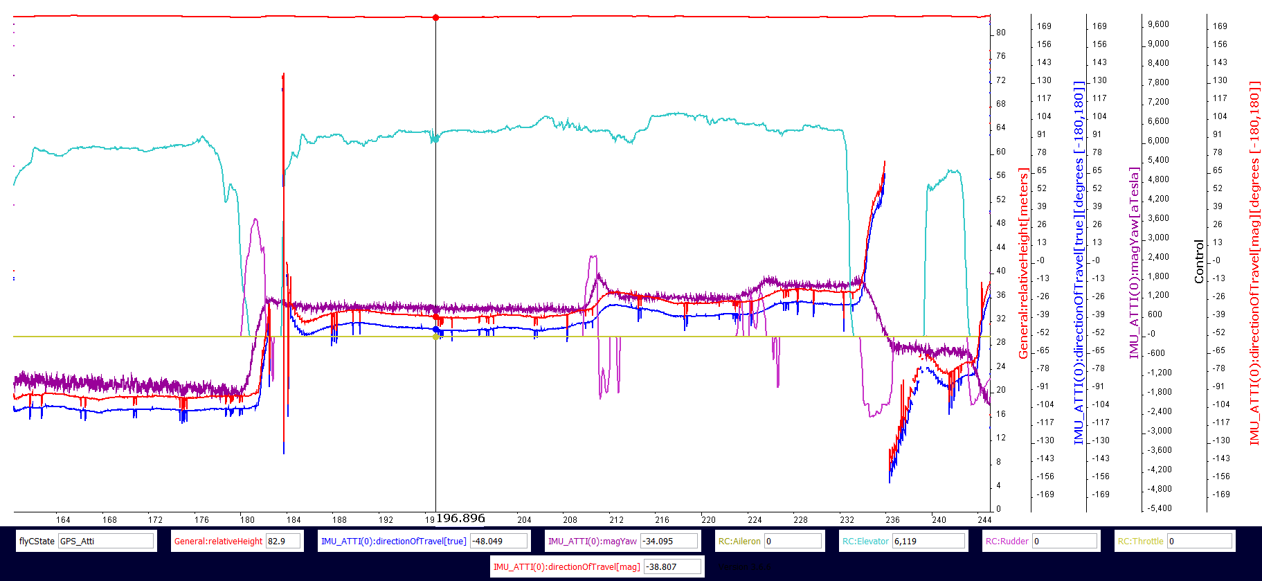

That is possible. I did notice in one section of the flight where the Mag was slightly off, but it wasn't long enough to make a definative drift determination. That is why I asked for a longer duration with only elevator inputs. If you look at the red and blue lines in the graph below, they are a few degrees off, however that doesn't mean a whole lot with all of the other inputs. They could be within tolerance, but that question I can't answer.
