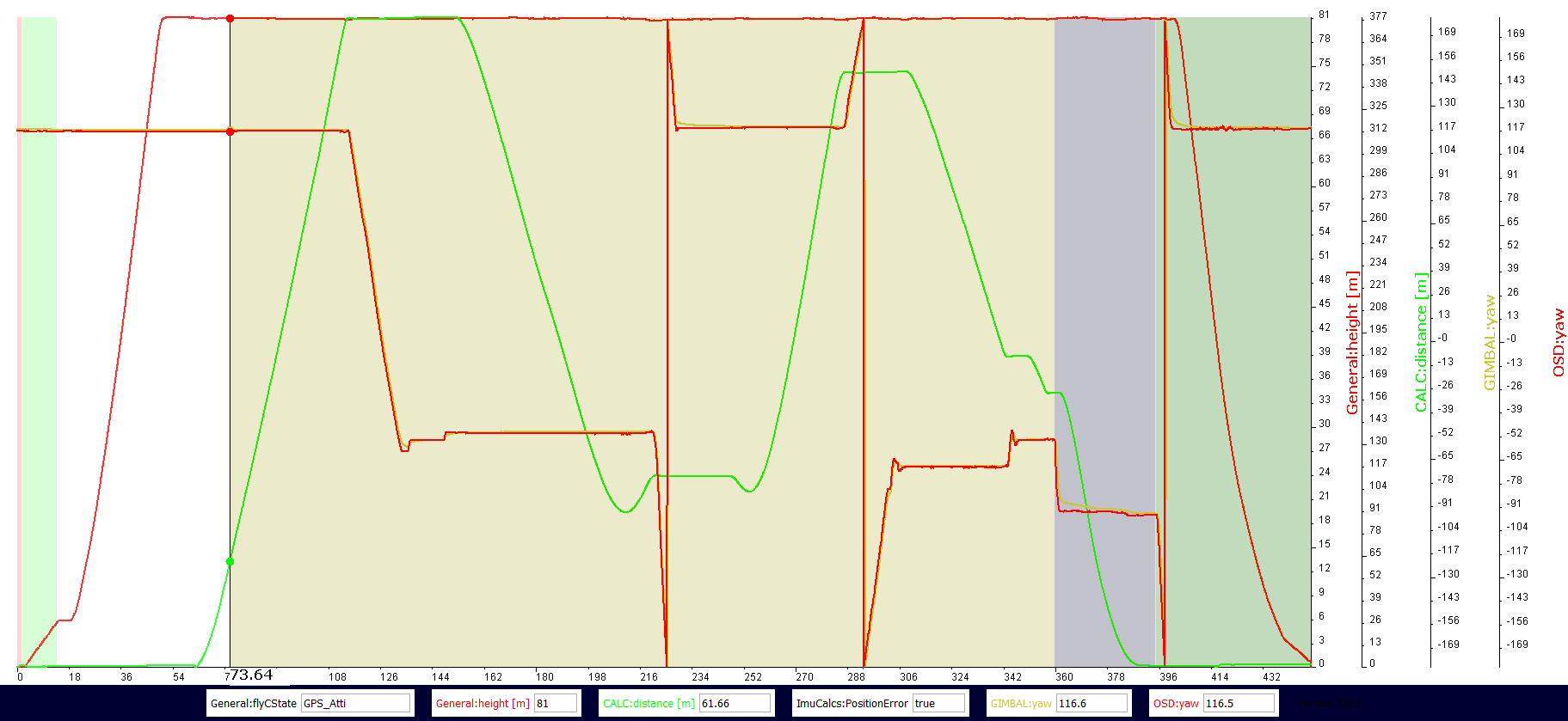

@blong10 Haven't looked at the .dat file as of yet, however this .txt log also showsan IMU positioning error at almost the exact time in the flight as the one noted previously and remained for the entire flight. The gimbal angles appear spot on.

Can't really say. That error doesn't appear in all the flights. Of note, however you may want to take a look at this in the flight log viewer. This link below is your .txt flight profile from the video. Use the slider bar and scroll to the ~2:40 mark as you noted in the video from Post#25. Scroll forward slowly and look at the attitude indicator in the upper left of the screen. You will see that during that time, you were issuing elevator only and the aircraft is rolled very slightly to the right. Only a couple of degrees, and maybe that is what you were seeing.

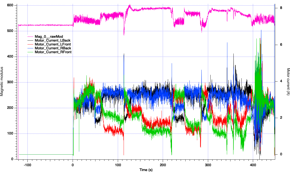

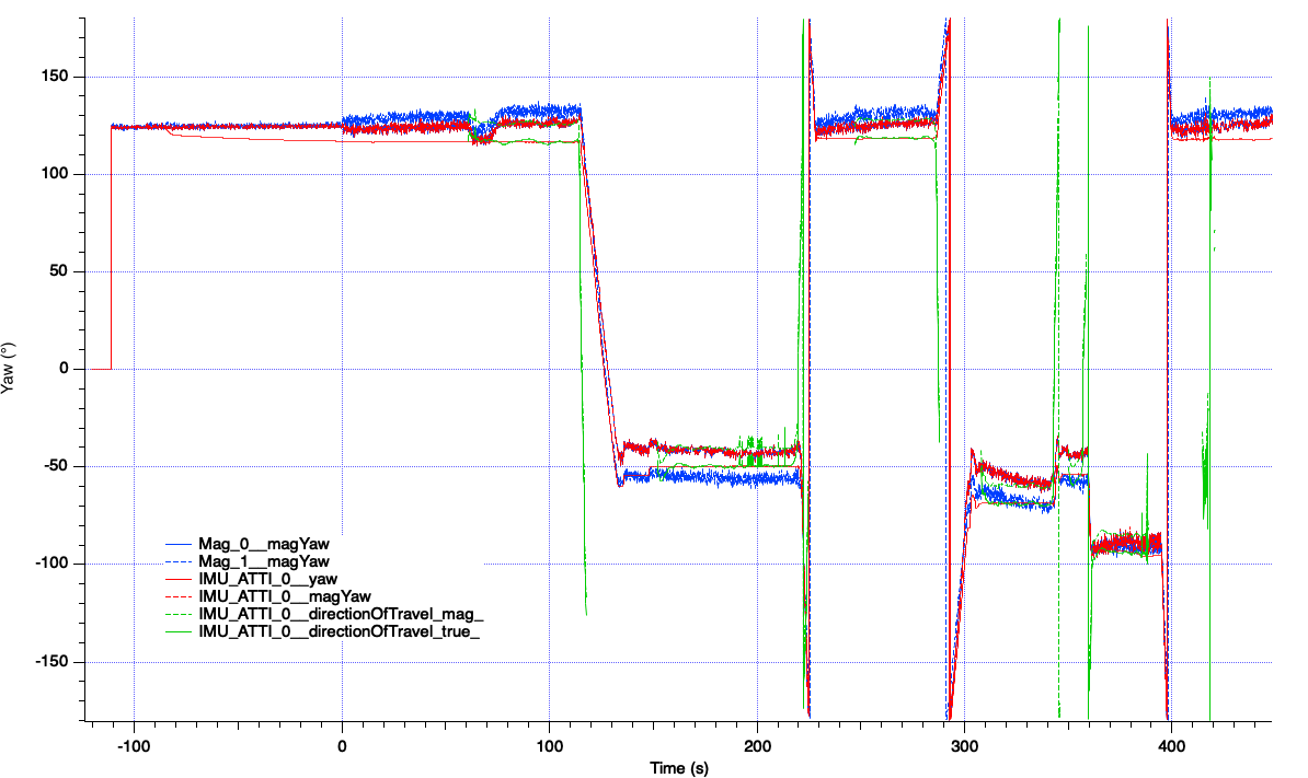

There's a couple of things going on here, but the observed problems are entirely due to incorrect magnetometer readings:

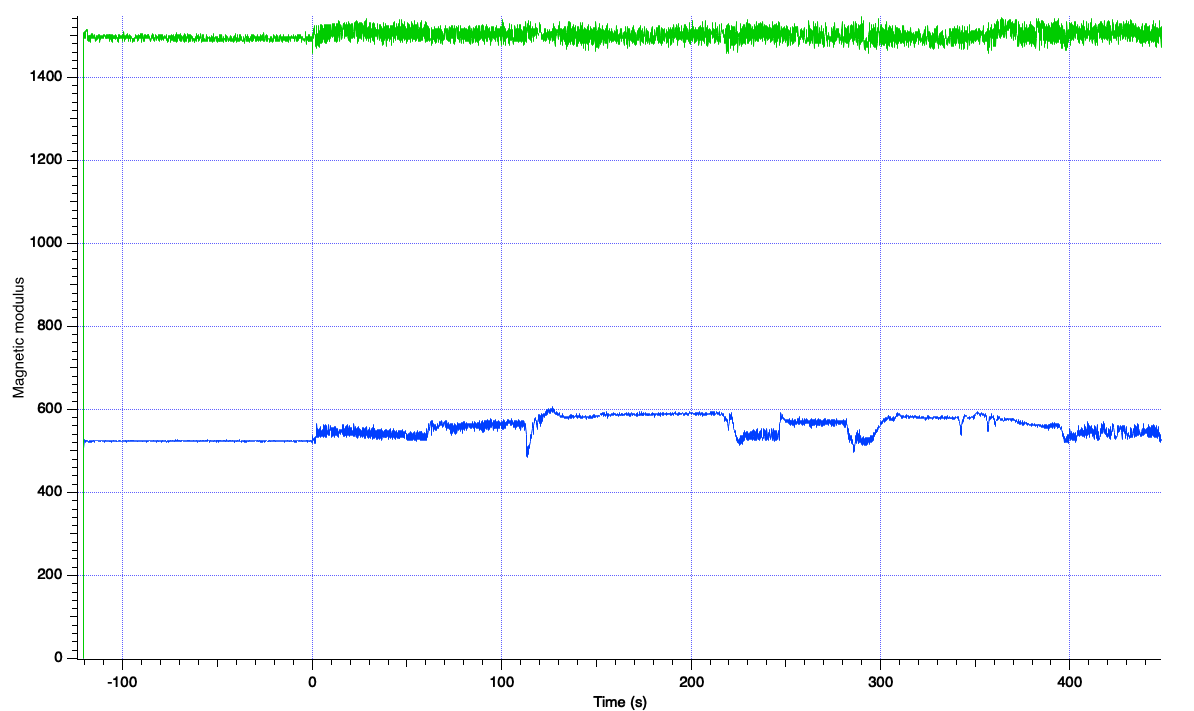

Mag0 has a variable error, while Mag1 looks about right. Unfortunately the FC is using Mag0. Firstly, Mag0, looks way out of spec:
Mag0 magnetic modulus is really low. Secondly, it is being strongly affected by the current to one of the front motors:
That's what is causing the rather variable offsets between track and heading, which line up precisely with the errors in Mag0.
I'll take a closer look later today to see if there are any other subtleties.

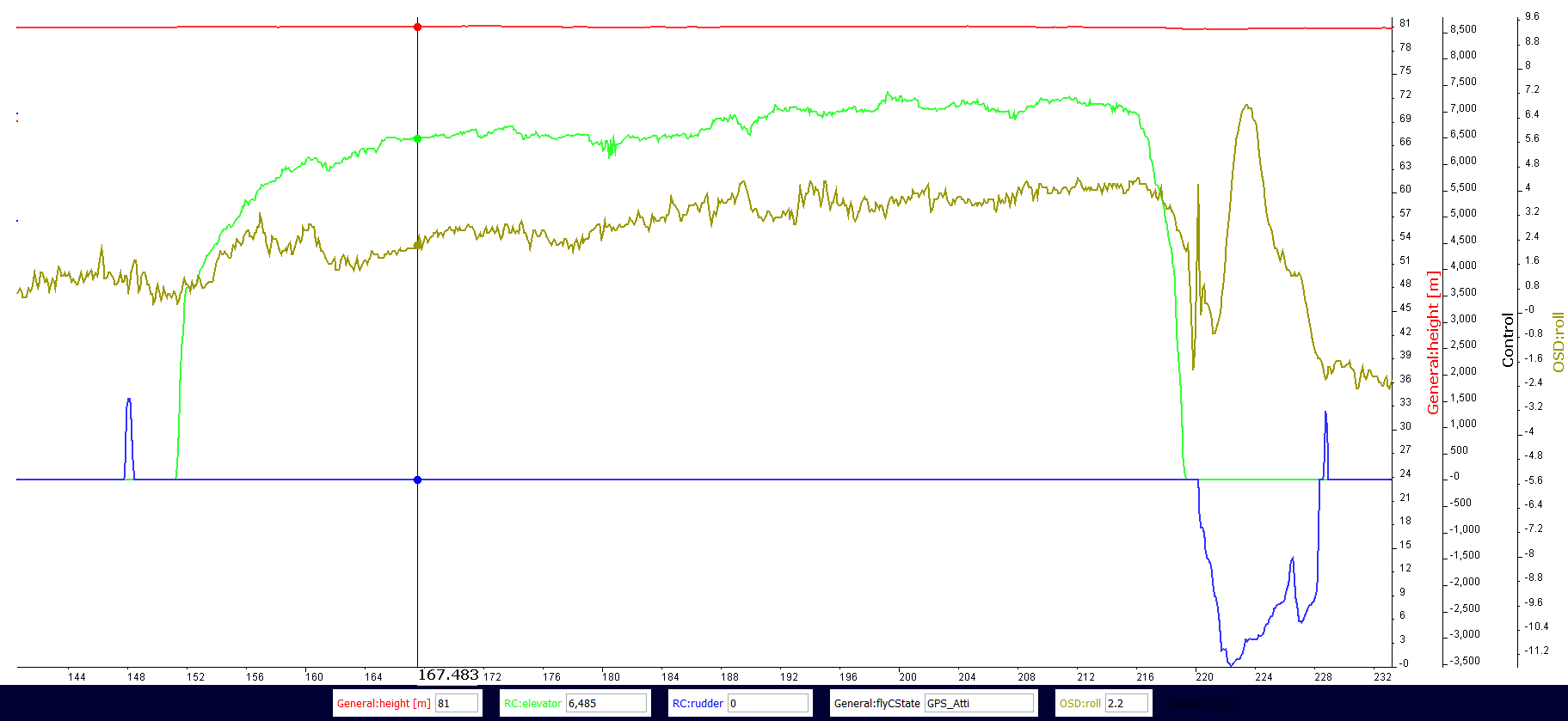

There is a "right" rudder command recorded just before that elevator forward command, explaining that slight right rotation in the video as seen in the sigplayer. Possible blong didn't intend it?

That rudder command was intentional I suspect and is not part of the area I was looking at. I am looking between 167-219 seconds for a straight flight with no inputs. You can see the +2 to 3 degree roll with only the elevator applied.
