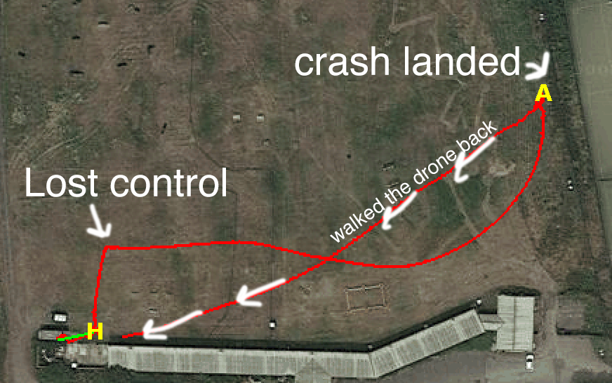

I have attached an image of the first occurrence of this issue and you can see how the drone erratically veers right and then I had to bring it down. The same thing has occurred on subsequent test flights (video - IMG_0121.MOV).

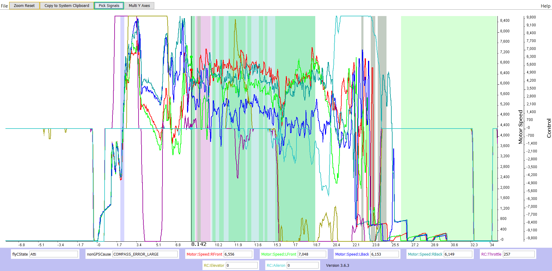

It looks like you have a compass issue. There are compass errors all over beginning approx 8 seconds after takeoff. This could be the result of a magnetized compass, which will never calibrate properly. This is just a quick look at your data but initially that is what it appears to be.
