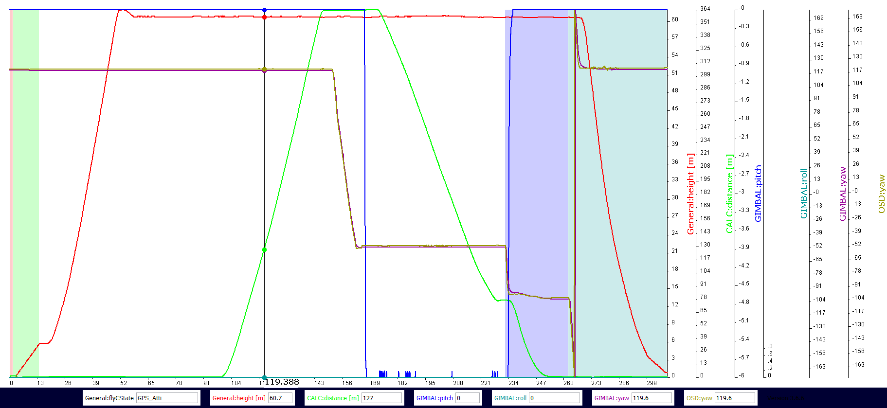

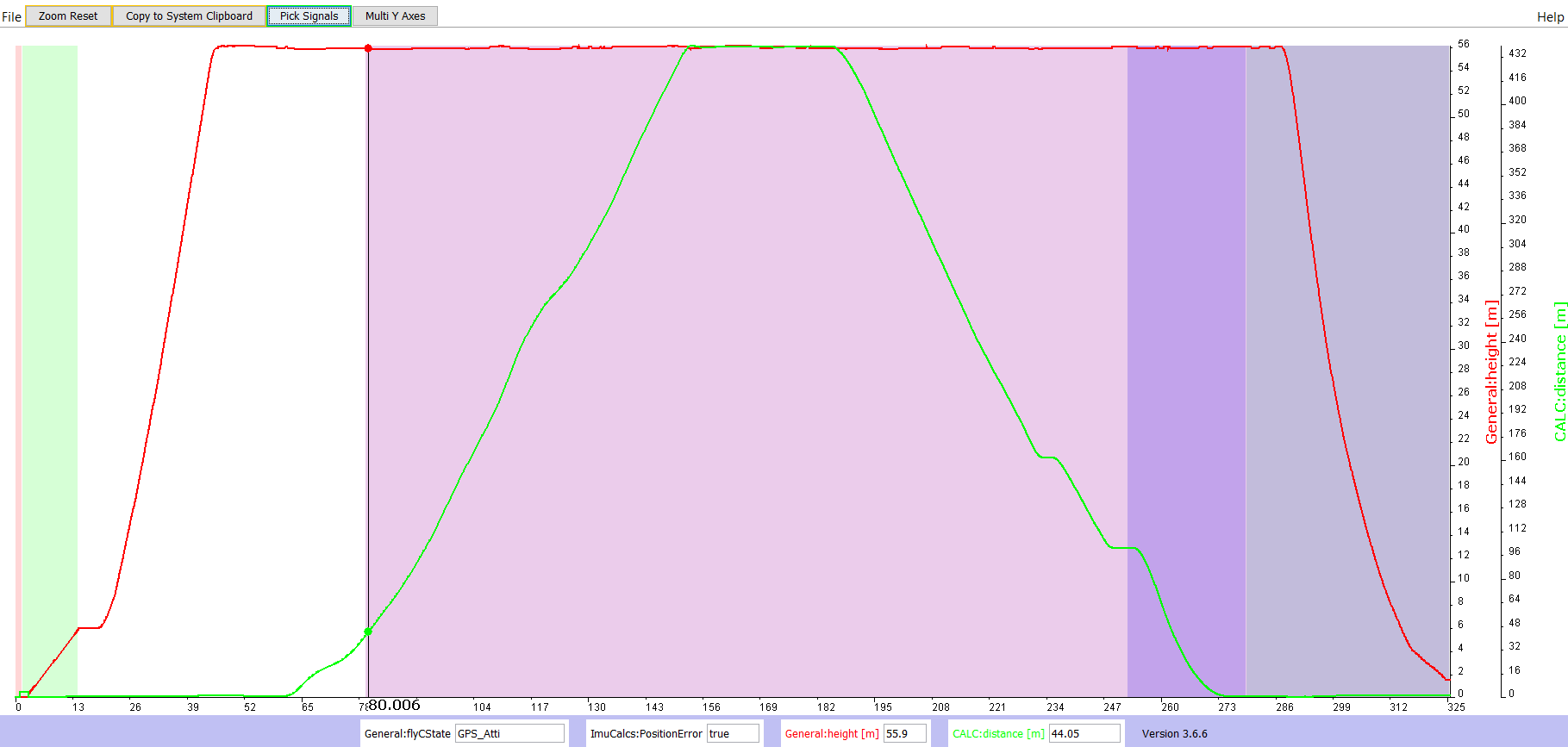

@blong10 ... For notation, the first .txt file you posted, shows an IMU Positioning error at ~80 seconds and remained fro the entire flight. That being said, the second .txt file you posted ( DJIFlightRecord_2019-10-24_[17-29-27].txt ) does not show this error and that flight matches up with FLY489.
I am not seeing much of a deviation in the angles.
Below is the first .txt log that shows the positioning error in shaded pink.

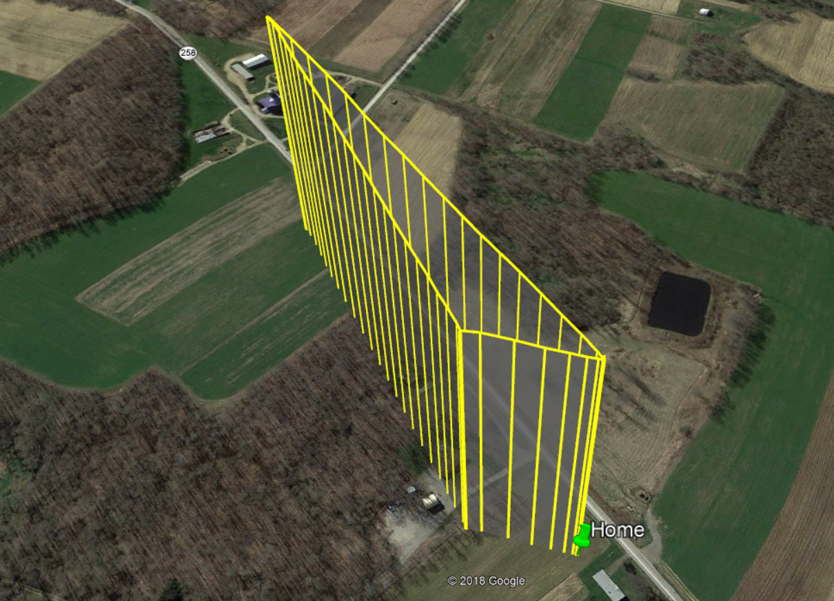

Your flight profile looks straight and even to me.
The gimbal YAW matches the aircraft YAW so I would dought that this is related to the gimbal.

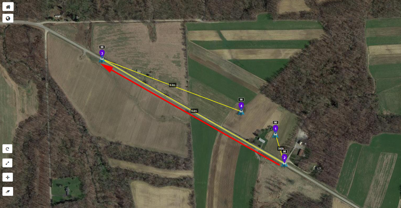

There is another way to do this as well. If it were me, I would fly a Waypoint Mission, either with GO4 or Litchi. That way you eliminate the variable of the RC. If the drift is there ( more than a few degrees ) then you know it is an aircraft issue.

The only issue there is, if I am not mistaken, tap to fly is only "Auto-Takeoff". The aircraft will only lift off and hover. What you need is a long straight run. The road by your launch point certainly looks straight enough as a bearing point. If you look at this quick sample from Litchi, you will see what I mean. From Waypoint 2 to Waypoint 3 is ~ .4miles. That should be plenty of distance to notate any drifting.
