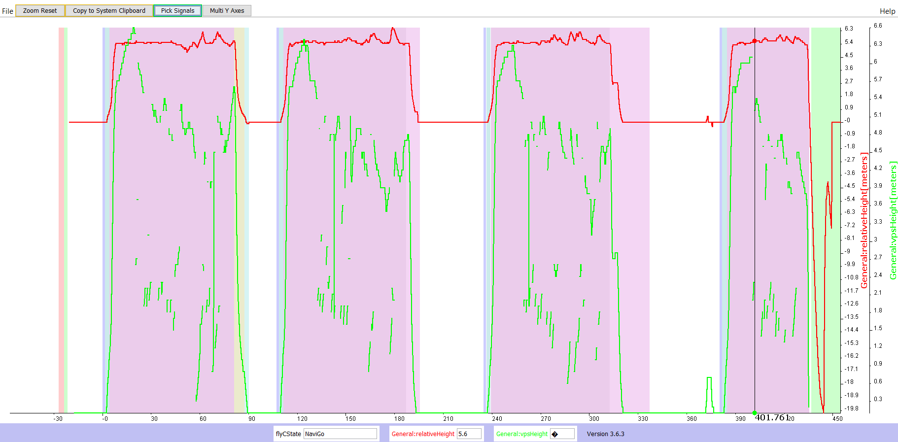

Just a quick look, and bear with me, because this is the first Matrice Data I have seen. But if I had to take an educated guess. This looks like a VPS issue of some sort. If you notice in the graph below, the VPS signal is in and out and very erratic through all 4 flights. I did notice an Autoland command in the first one, and that's what led me to look at the VPS. If this data is accurate, consider your self lucky that it didn't crash on one of the first 3 in this file. I have seen the VPS do some bizarre things before, I will however ask @sar104 if he has time to take a look as well for you.

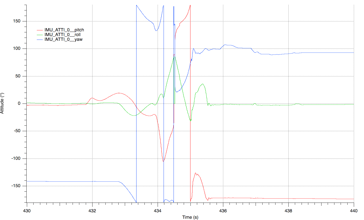

That was equipment failure of some kind. At 434 seconds the FC loses attitude control:
434.084 : 22135 [L-COMPASS][currt cali(0)] find_ref_index_flag = 0|
434.130 : 22137 [L-FDI][CTRL]: fault on , tilt_ctrl_fail
434.151 : 22138 [L-RC]craft ctrl failed!!!
434.297 : 22145 [L-FDI][CTRL]: fault off, tilt_ctrl_fail
434.485 : 22154 [L-FDI][CTRL]: fault on , tilt_ctrl_fail
434.811 : 22169 [L-FMU/FSM]near ground
435.047 : 22181 [L-FDI][CTRL]: fault on , impact_in_air
435.061 : 22181 [L-FMU/FSM]not near ground
435.146 : 22186 [L-COMPASS][currt cali(0)] find_ref_index_flag = 0|
435.172 : 22187 [L-FDI][CTRL]: fault off, impact_in_air
It can be difficult to determine cause and effect, but the attitude data show the loss of control, starting with an uncommanded backwards pitch at 431.8 seconds that appears to have been due to a rapid motor speed excursion. Then it just gets worse.
The VPS excursions are likely just the vehicles under the aircraft.
Possibly so, I neglected to extract the log on this one.....That does explain more....

It probably rules out some possibilities but I'm really not sure what caused the failure. The M200 has a more complex flight control system than the Phantoms and Mavics. There are a lot of data to sift through.
