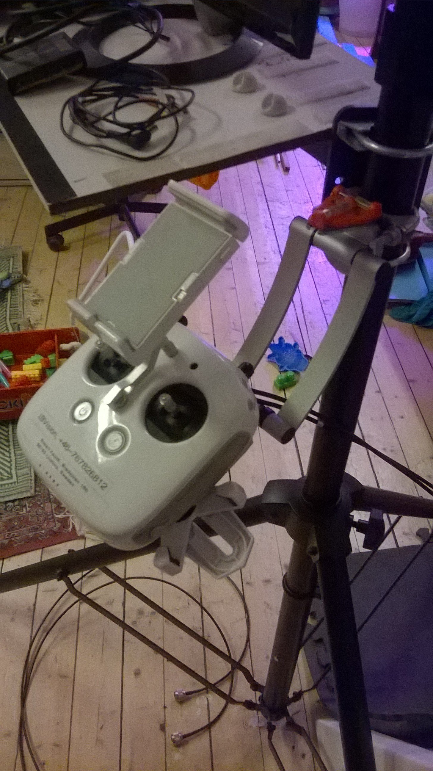

Hi there!
while changing the RC battery I thought to make some optimization of the RC connectors. I took stronger cables and placed the connectors for the antennas downwards. This gives me a lot better balancing when using In the van, home or with tripod. Here some picts..View attachment 79093
Brilliant!

"Short" update on the earlier mentioned N-connector pigtail directly connected to the RC's main-board. I ordered a 1m long MMCX to N-male cable. I will lead the cables through the bottom of the RC similar to where I placed my RP-SMA (see pictures in an earlier post here). 1m is ok for me because I almost always use RF-linx amps with N-female connector. "In emergancy" I could use my other RC or an adapter. I made some movement test with the cable and RC and it works as expected.I finally can sit relaxed with the RC and can concentrate on the 75" screen or headplay display without worrying to break the RC or getting pain in the wrists.Also this irksome screwing on the RP-SMA connectors on the RC is gone. I love N-plugs! :)
1m would be also enough to step out the car and look for the bird myself or turn around, change position,etc.. The cable will be a highflex 7 which is low loss and still felxible enough. Here the link to the cable company: Cable Configurator | Wifi UMTS/3G GSM Antennas, Radio Amateur Antenna, coaxial cables assemblies, radio accessories
Will be interesting to measure how much RX signal is arriving at the RC's main-board incompare to RP-SMA solution.
Maybe I should integrate some of my RF-linx amps on Tx (and maybe Rx) side directly into (or rather half into..spacewise) the RC. With the adjustable gain control it would then act as a superstrong RC. Not really CE conform :rolleyes:... but efficient for the vast forest areas around. ;) The golden Sunhans would maybe fit inside somehow but they got too high tresholds, low Rx gain and a little noisy..
