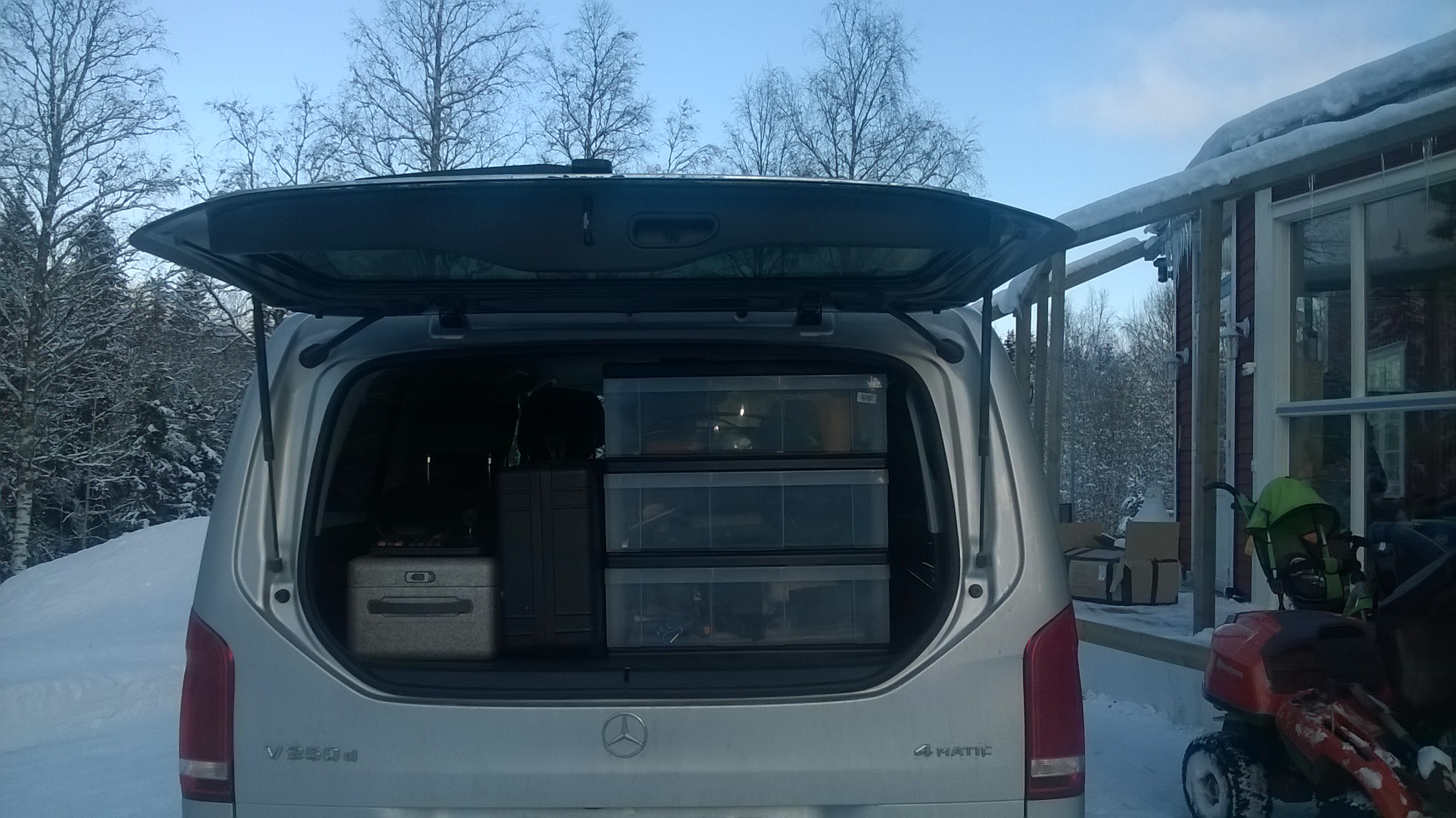

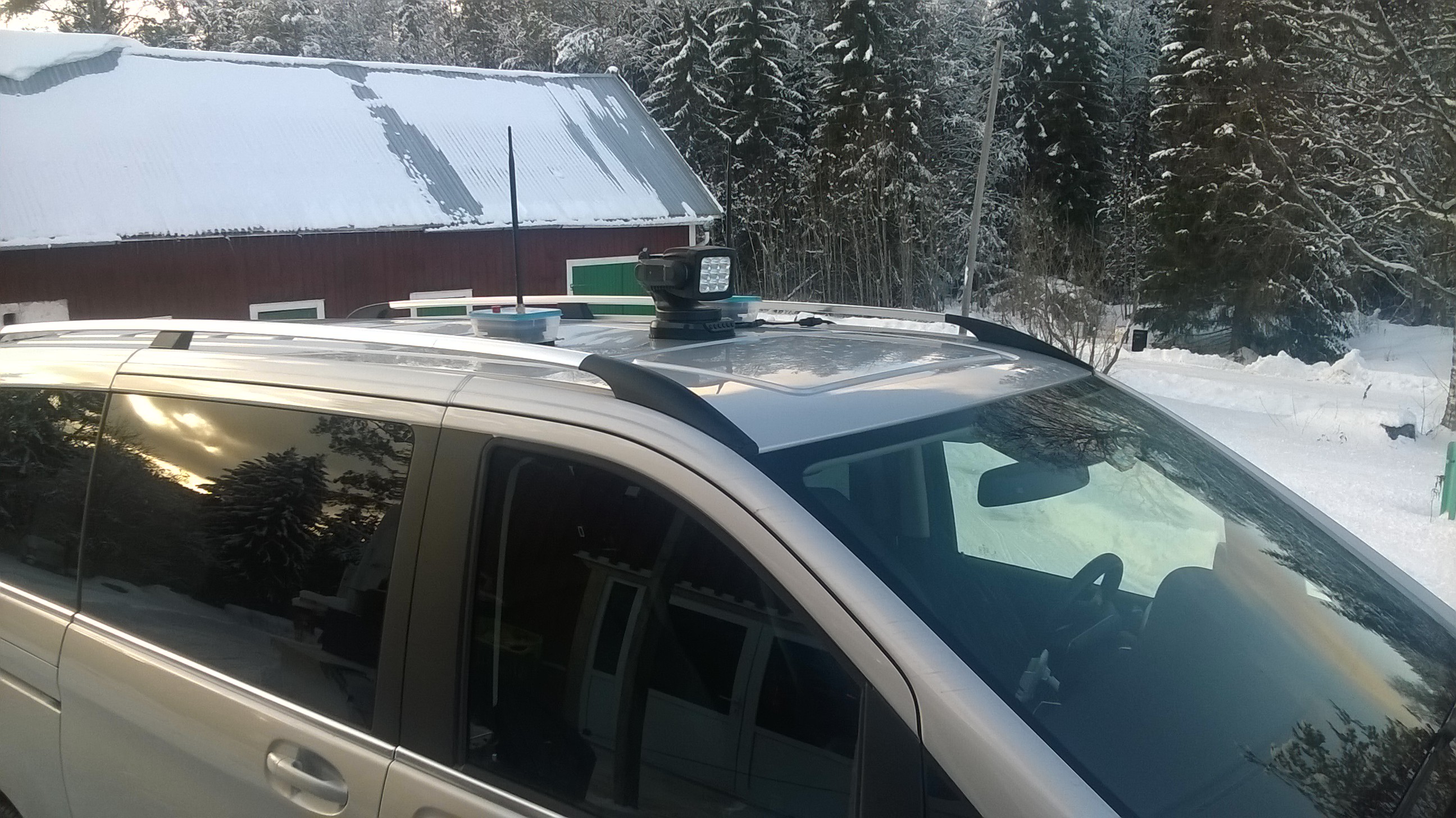

Hi there.. After some time a minor update..
I placed the magnet holders with the antennas on the car roof. To fix the new cable box is next step. This is my most simple all weather car setup. Antennas directly screwed amps in sealed box. Inside the van I got the "command station" :-)
I placed the magnet holders with the antennas on the car roof. To fix the new cable box is next step. This is my most simple all weather car setup. Antennas directly screwed amps in sealed box. Inside the van I got the "command station" :)View attachment 77802 View attachment 77804
