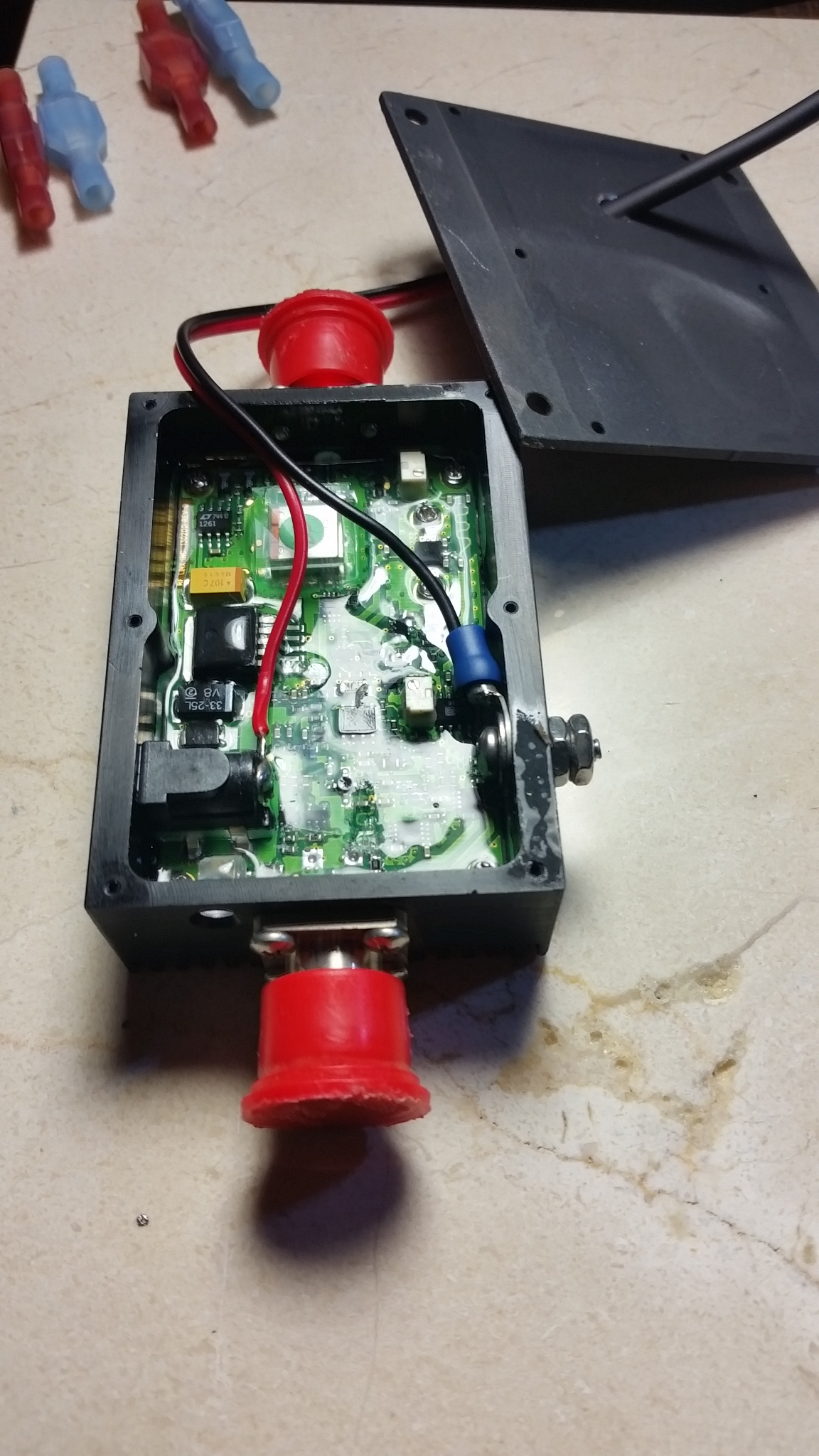

Board is sealed , at least on visible side.
I mean I will seal the gap between the drilled hole in the metal and the power plug. I will do it from the backside of the connector area.
The RF-Linx 20 db RX is desired. BUT, WIFI interference.. will that be a issue? RX listening power is great if interference isn't a problem.
Jack is 0.00 distance from enclosure walls
As "Hack" did, that's the best you could do, But I elected to the safer option of just soldering to the jack/ common ground.
I love clean installs.. this was a crap shoot.
I mean I will seal the sides where the jack meets the walls on the inside. That will also strengthen the jack from coming loose over time. I am in the habit of hot gluing everything. It is a great way to waterproof and strengthen anything.
You will see what I mean when you look. The jack is mated to the walls. Hot glue will not work well.
I recommend a solder to the jack.
Don't know why, but make sure you chip away the pc board line as noted earlier.
Tech support at RF-Linx said to de-solder the resistor to set the amp in "indoor" mode. I didn't want to risk lifting a trace since the resistor connects to the signal input. Also, with all the goop, breaking the connection by scraping away the copper seemed a simpler solution. I'm not 100% sure it's necessary either.
If the tech said to do it. I guess I will do it to be safe.
Maybe no extra hot glue then. I will still drill it since I can be very accurate in drilling depth with a drill stop
