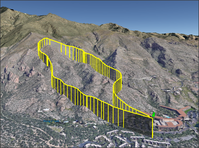

BTW here is that mission imported to google earth. I removed that "offending" WP. Wasn't really needed. I have just recalibrated my sticks using DJI Go. I can't quite see how that would cause a Litchi mission to not run, but for now it's all I got. I will be out in a couple of hours to try again.
Nice, hope you get it to fly. What mountain is that? Maybe fly manually if Litchi wont let you run.
OK I did two things, and now my machine flies! I updated to the latest Mac version of Litchi on my ipad, and I calibrated the sticks with DJI Go. Now it flies and runs missions as expected. I flew that route 2x and another similar one once for a total of 24 minutes of flying over fantastically beautiful scenery, about an hour before sunset. I am cutting it together now and will post it soon. Thanks to all for your input.
