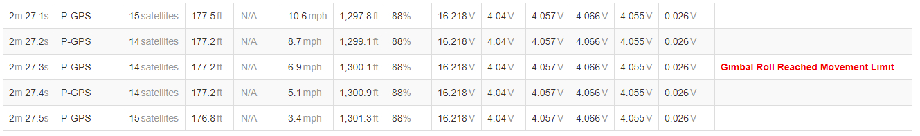

Sounds possible that you got tagged by something but I'll throw this in for consideration. I've had this happen 3 or 4 times over the past few months (manual flight w/ GO4). Restarting the bird always sets the gimbal back to normal. Calibration after each occurrence has no effect. Looking through my logs, the error "Gimbal Roll Reached Movement Limit" can be found. On two logs, I noticed the AC was slowing down rapidly when it happened, so I suspect it's a combo of wind/gimbal angle/(de)acceleration that pushes it to the limit and makes it tap out on occasion. I've seen videos of others where their gimbal recovers in flight but that hasn't been my experience. Not a biggie for my current use but if you're looking at the screen when it happens, it's good for a jolt! :)

The error I mentioned was found by uploading my GO 4 txt log file (same for Litchi .csv) to one of these sites:
PhantomHelp Log Viewer
AirData Log Viewer
The AC's .dat file may show indications of a mid-air contact if one happened but I'm not familiar enough with CsvView/Datcon to further advise.

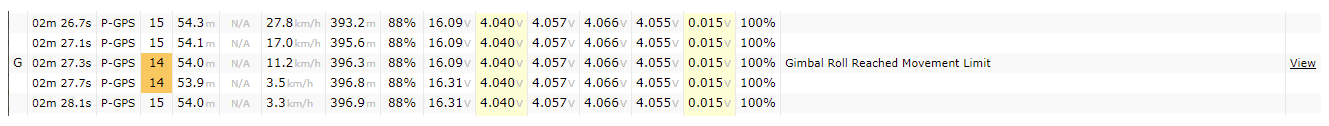

Here's what it looked like for me after the said error happened. :confused:
