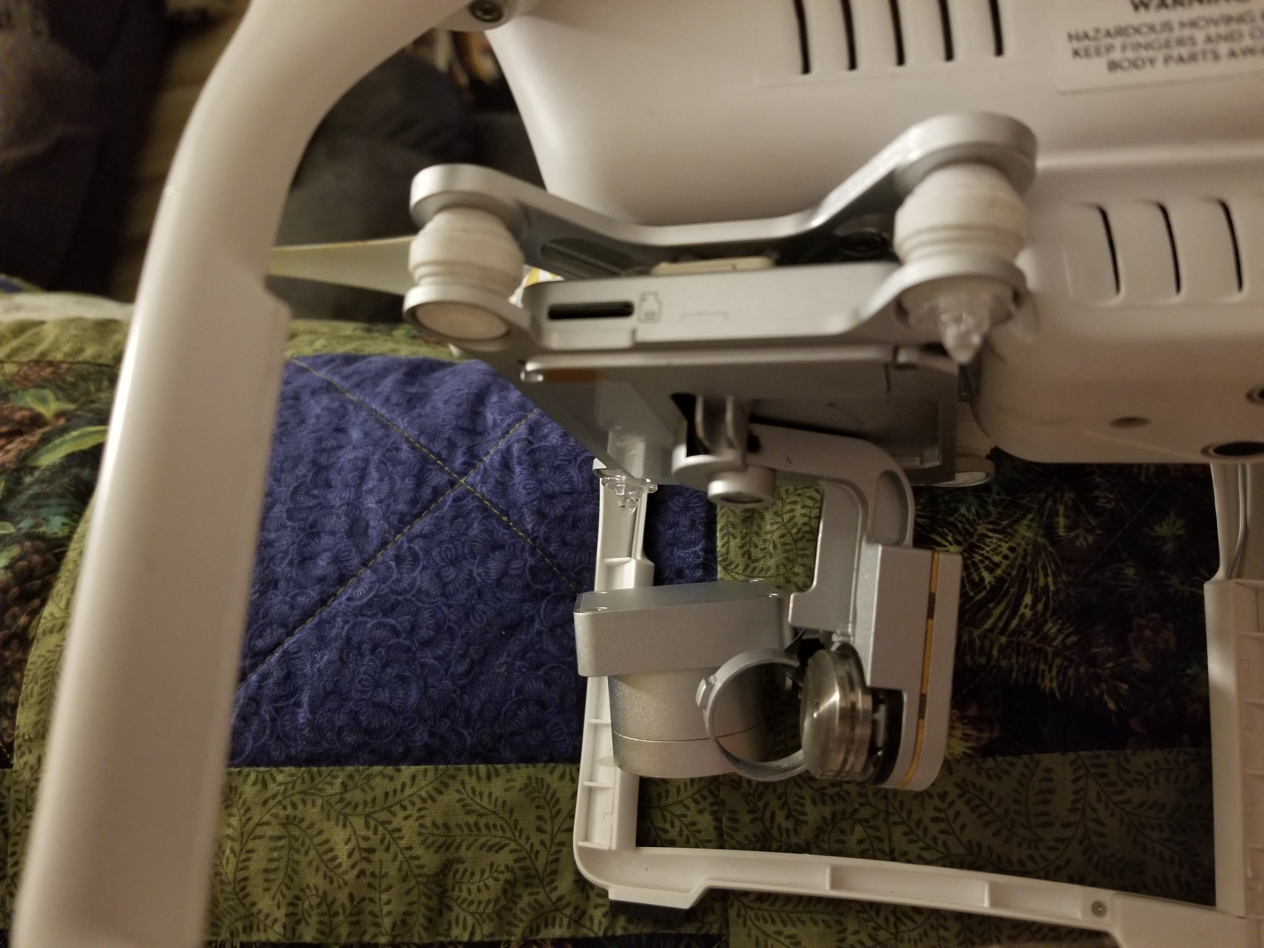

I crashed my drone but it still works fine. Problem is with camera. Camera dangling loose now. There is what appears to be a round metal ring that holds camera steady but now this ring is cracked and not quite sure how to fix? Can the ring be super glued? Any help would be appreciated. Can send pic of camera/ring if that helps. Thank you.

Here is a pic. Hope this helps.
The ring shown goes around the solid round to right of ring, but because it is cracked it will not secure.
Ya,you will need to replace the roll arm and roll motor assembly. I would suggest that you closely inspect the yaw arm and ribbon cable also. The yaw arm bends easily and the cable can fail while still looking intact.

Where can I get these parts?
eBay has a large selection of all parts to rebuild a camera gimbal assembly, just be sure not to order any from China because it may take a long time to get the parts. There are plenty of USA available parts.
Amazon has parts available too, just not the selection that eBay has, and the prices are a bit higher.
