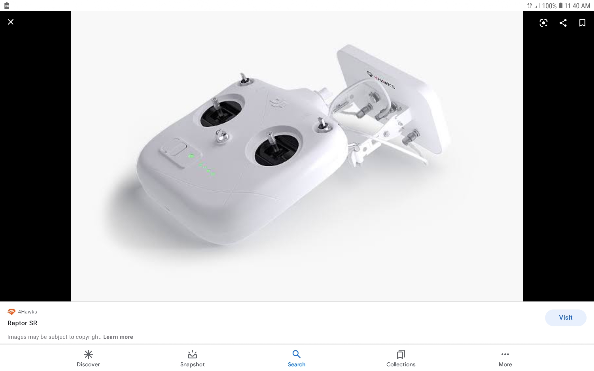

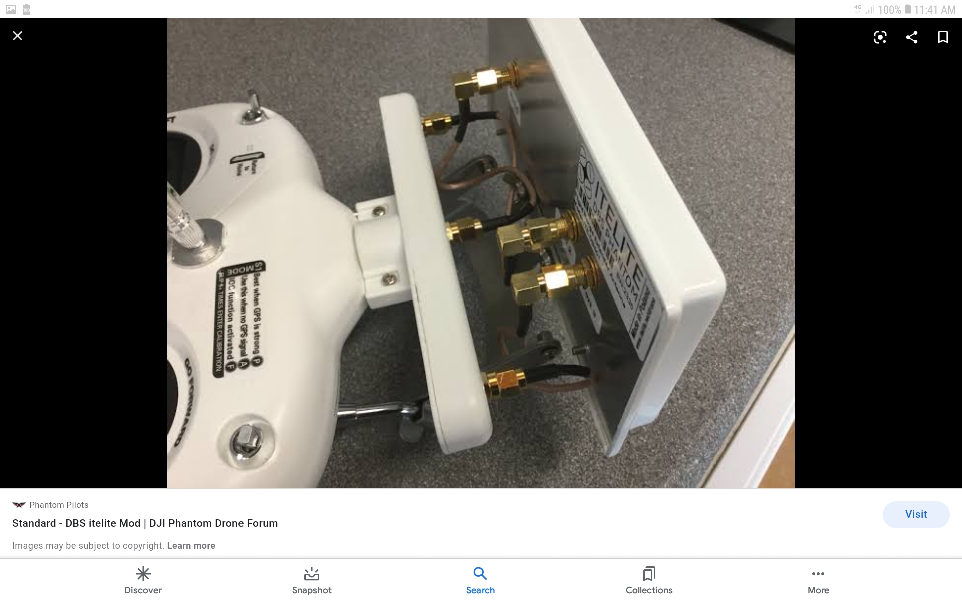

You can only try,its similar to mine but I have 3 tall ones like your centre 5.8,,the panels I find were crap but in saying that,,its wrong for them to advertise 4 times the range when that never happens,,its to hard to say what comes into play ,,all phantoms perform different and are not equal, so it's hard to say a range increase,,,my p4 uses a itelite huge flat panel but only good for so far not that I fly far ,its just good for transmission and trouble free flights wherever I go,,,I think my argtec said something like that but my p3s no good after 1000mtrs,,moral of the story some work some dont,,the Joy's of wifi,,bit of a money game,,I not have one but have read and heard the itelite p3 panel is very good and around same price so have look,,I see if I find pic for you...this 2 sorts but have look ,,better than argtec by far
