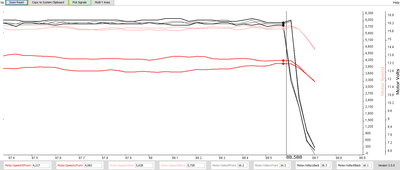

I had a look with CsvView and this is all I found (last few milliseconds before FC stops recording - likely due to power loss):
An abrupt voltage drop followed by loss of motor speed before EOF. Checked all the other obvious telemetry data and found nothing else.
I don't claim to be a subject matter expert here so please have a look as well.
Agreed - I see the same voltage decay, which is very characteristic of a sudden power disconnect:
That voltage collapse to around 7 V (at which point the FC stops) in about 100 ms is a recognizable signature. My first guess would be an improperly latched battery.
