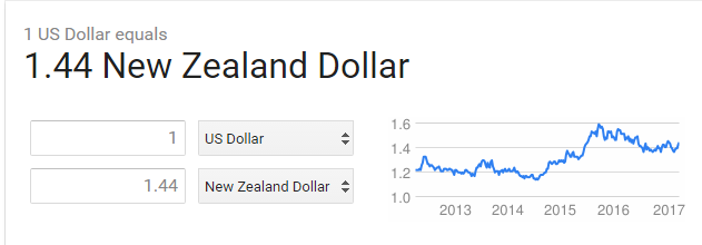

You should look at buying direct from DJI to see what the online price is. That P4P should be about $2159 at today's exchange rate below. $1499USD X 1.44 = $2159
