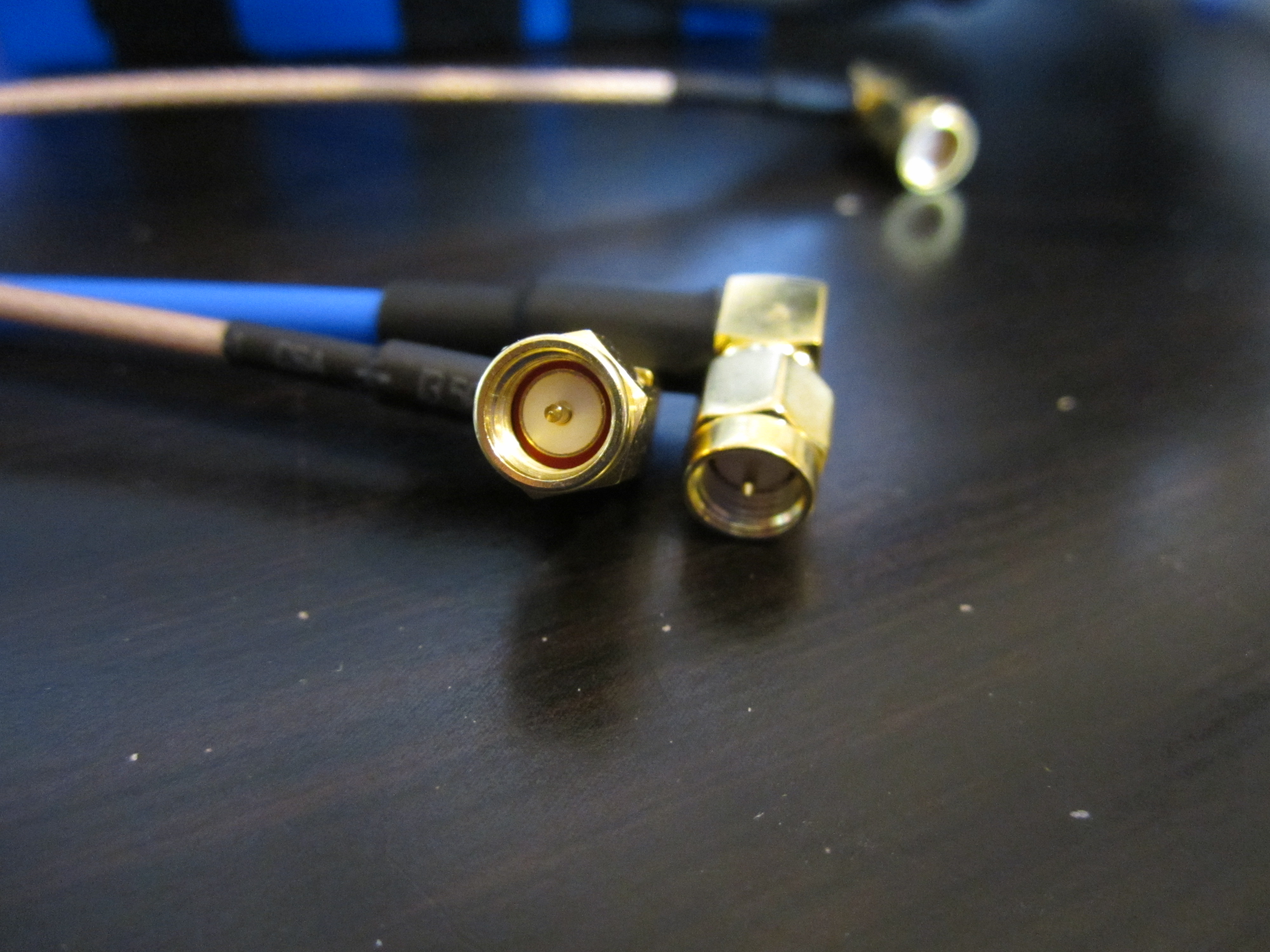

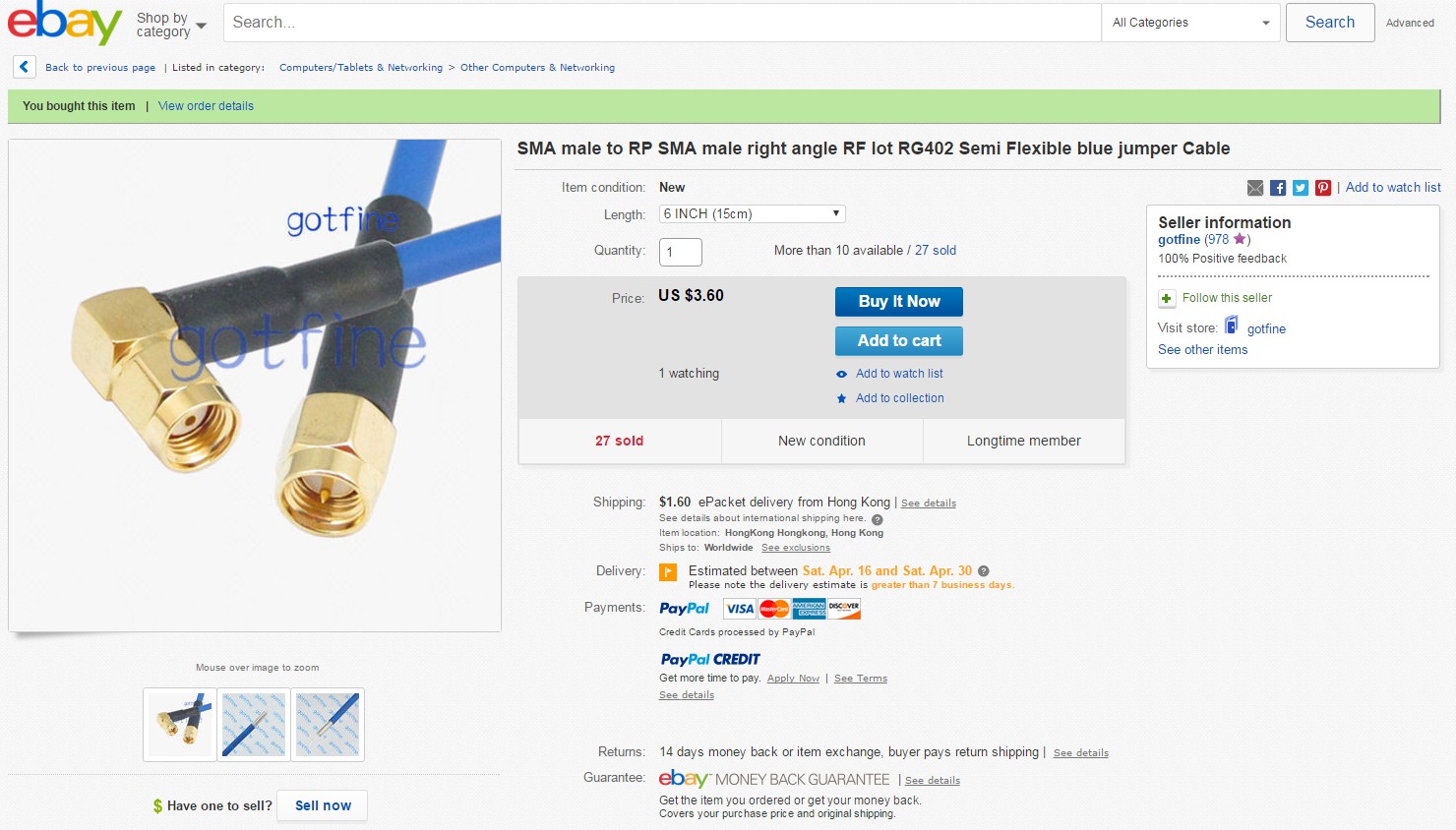

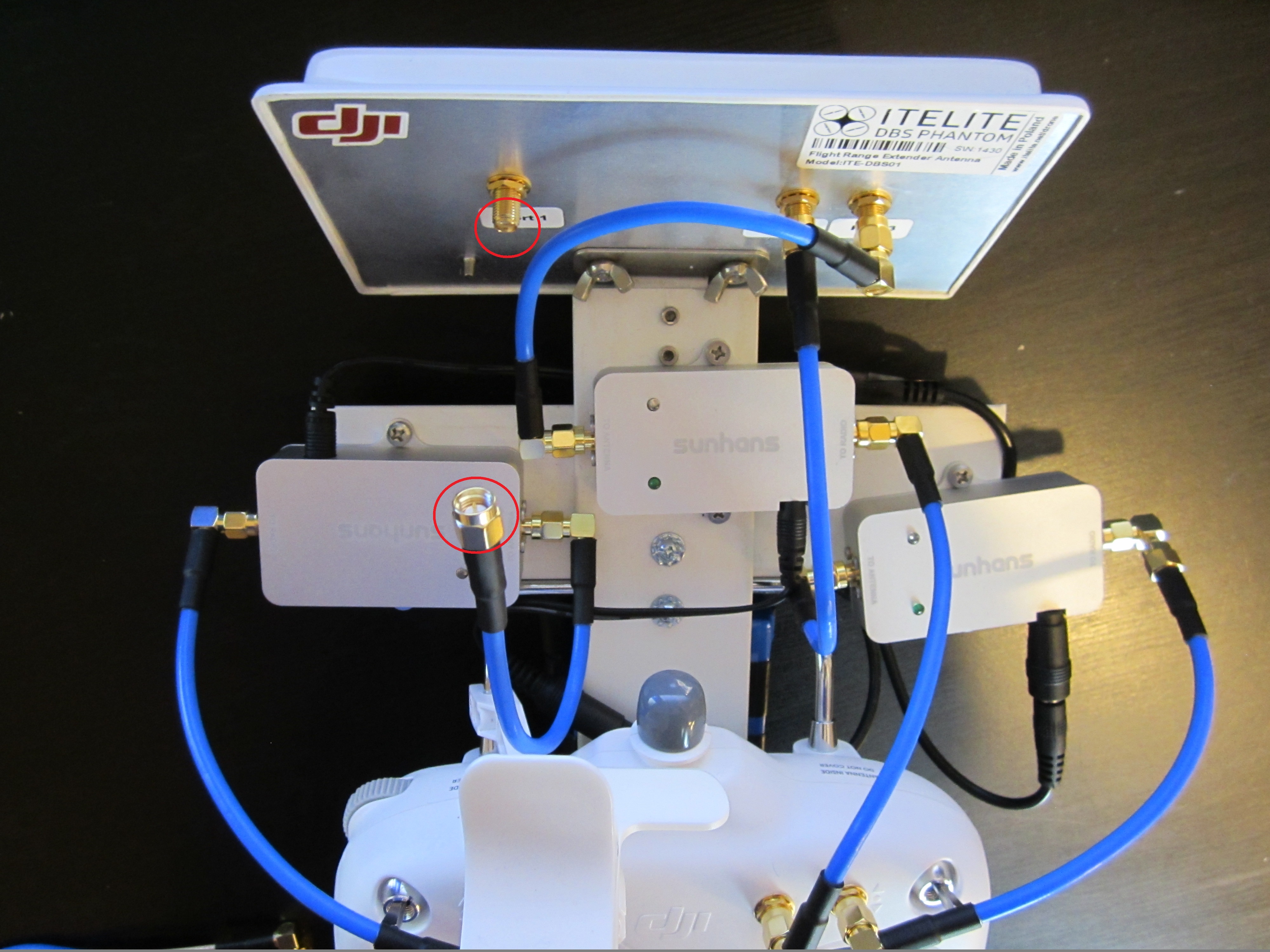

Is that the right angle one you ordered? It looks like it has an RP male on one end which I believe is reverse polarity and almost like a female, you can see on the pic there is no pin in the middle. The pic could be wrong. Is that the exact one you ordered? And it works?
Weather has been miserable here, I just started flying the phantom a week and a half ago and the weather has been the worst. I have a huge field next to my development which is connected to Reid Sod Farm, decent space minimal interference, no problems reaching 6000 feet with the DBS unboosted with still a pretty strong signal w/ video getting jumpy.
Thats awesome! I cant find any place near me with no interference. Even flying over the ocean i still get interference lol.
Yeah thats the exact one i ordered.
SMA Male to RP SMA Male Right Angle RF Lot RG402 Semi Flexible Blue Jumper Cable   eBay.jpeg
As you can see its the same RF plug as the DBS mod & amps cables.
Its regular male plug with pin inside to angled RF Male plug with no pin/hole.
You can also pick up a couple of angled adapters just in case.

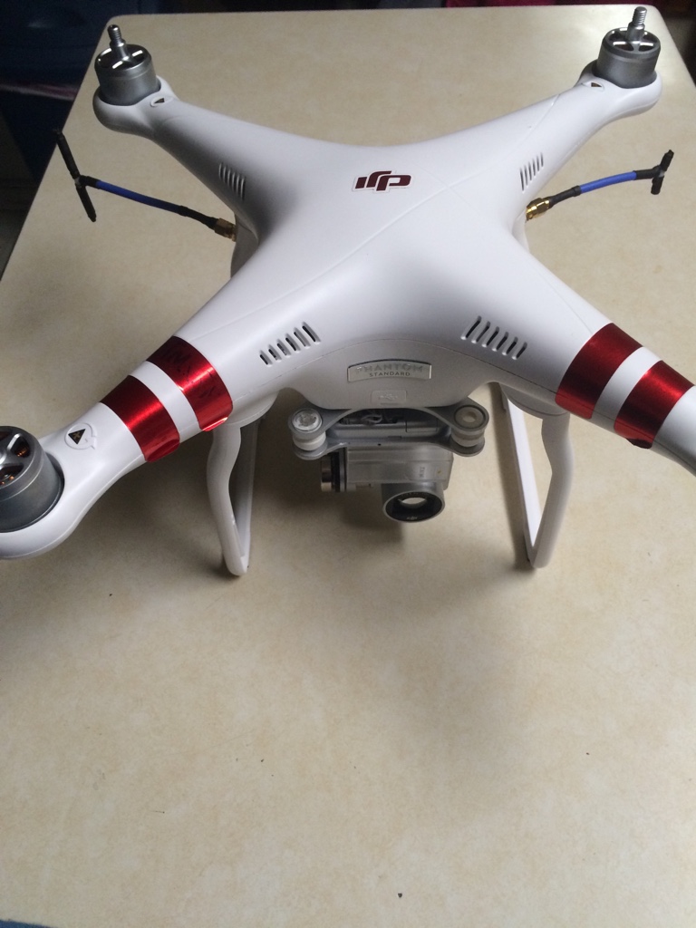

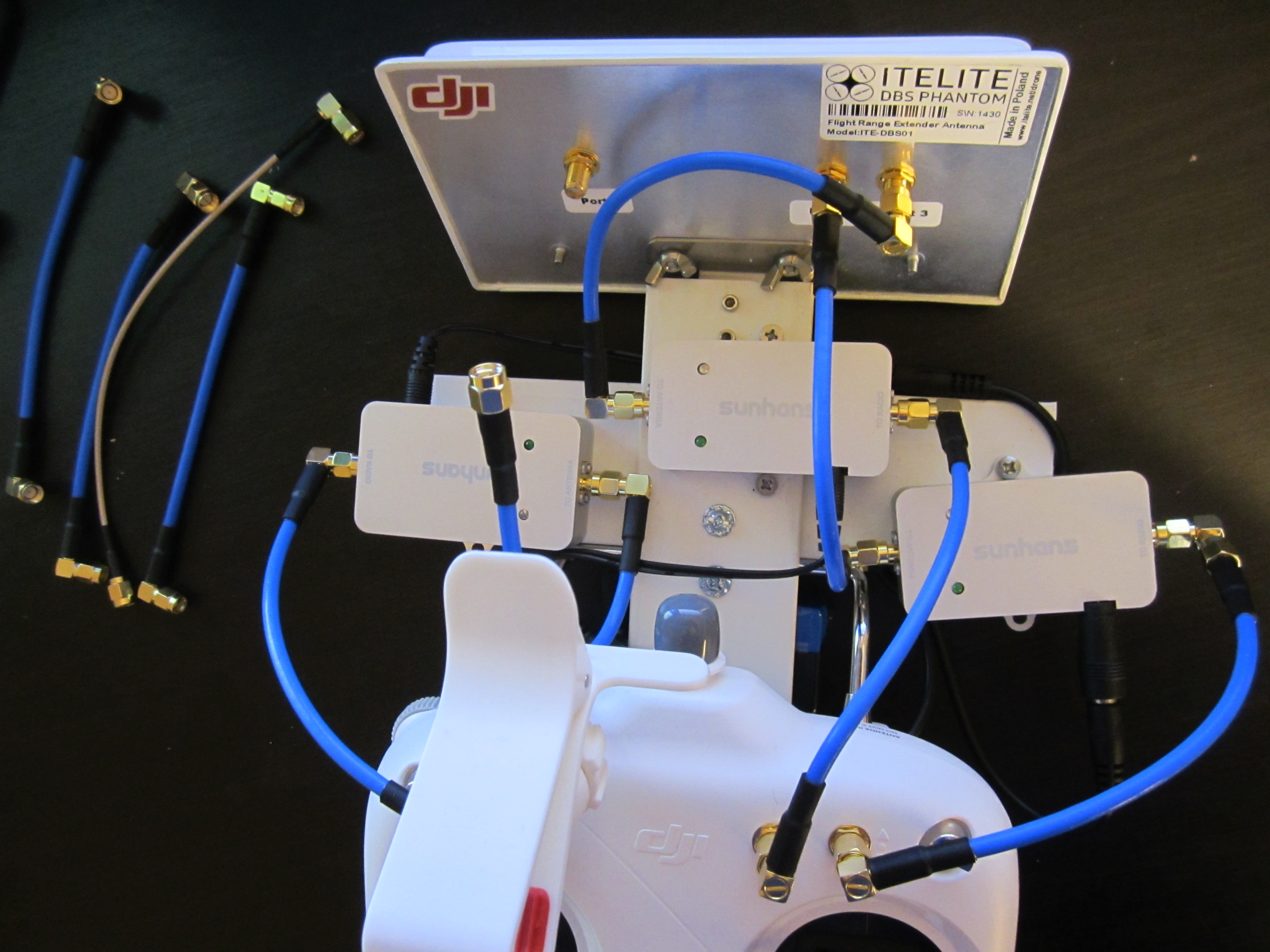

Got the bird modded up for (part3) of the tests. Dipoles birdside ,dbs panel UNboosted,
Although I havent got pigtails yet
I had (2) so I went ahead and did (1) 5.8 and (1) 2.4 figure i'll give it a shot even though it's not all (4)dipoles its worth a test!
View attachment 49782 View attachment 49783 View attachment 49784
Got it, I thought the cable ends were identical.
BTW Guys, if someone's looking for those 'better' blue RG402 cables (originally suggested by dirkclod - thank you!),
that chinese ebay seller ships them very fast. I ordered them last tuesday Apr 29, and got them this morning Aprl 6, thats only 9 days from China to NJ.
He is a lot cheaper that other ebay sellers and has more options.

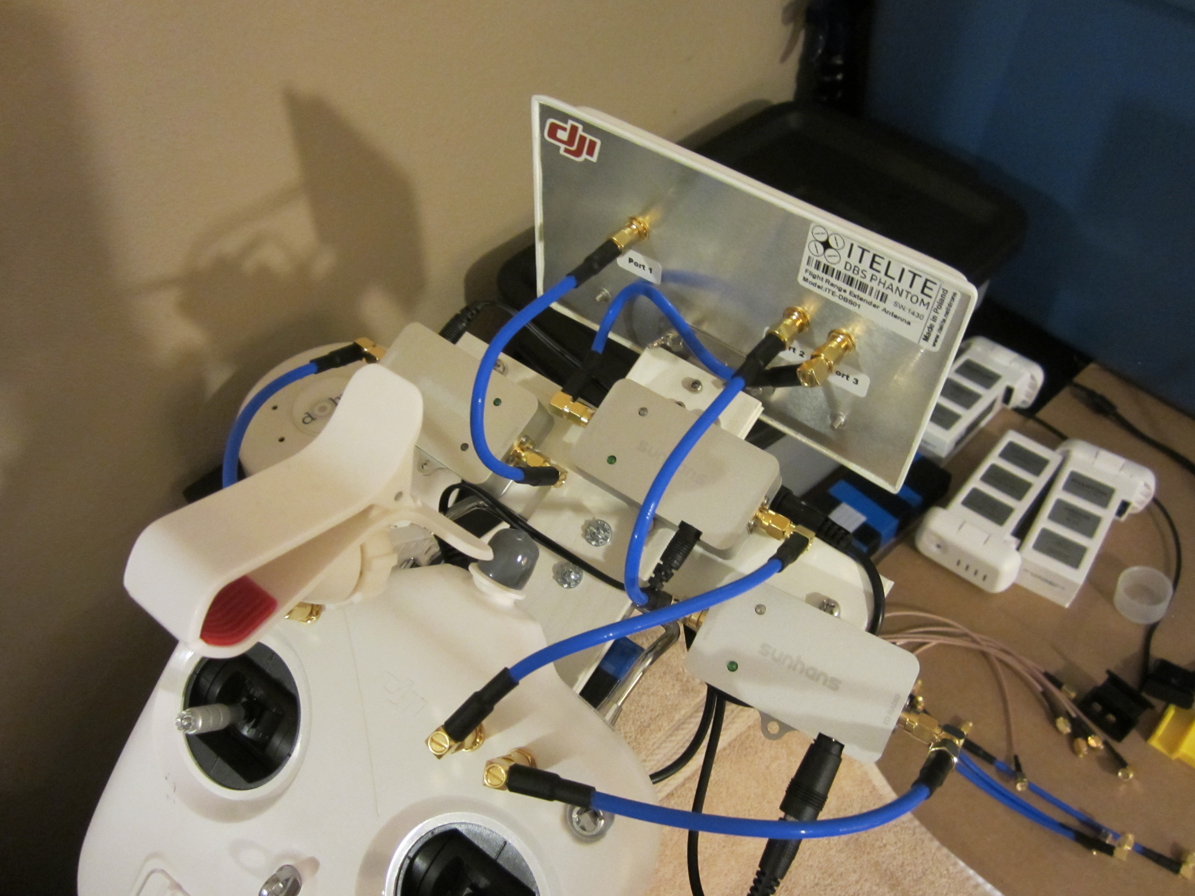

(here is what it looks like - promise not to laugh at my RC, i designed the bracket myself :eek:)
View attachment 49743 View attachment 49744

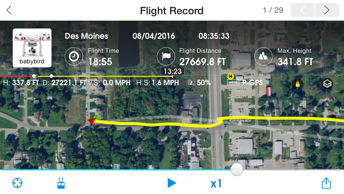

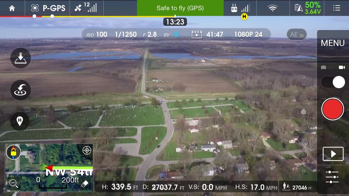

As you can see the test yesterday (dipoles - unboosted) was disappointing.
So for tests sake, I took it to the same flight path this morning, weather was the same, A little less cloudy. But on the DBS controller I hooked the boosters back up. I got a good signal for most of the way out, bars dropping a couple times due to antenna aiming. Took it out to 27,000+ feet turned around at 50%. On the return home my signal wasn't as great,The Wi-Fi signal would go up and down every two seconds causing the screen to display "safe to fly GPS" & then "no signal" it switched back-and-forth between the two so fast that I never lost satellite view and was able to fly that way but my camera view was in and out every other second.this happened for most of the way back which would've been concerning had I not had my satellite view to fly with. I was also getting a "strong interference"message during that time! So I don't know if the strong interference was causing the signal loss or if it was the dipoles. Either way big difference between the 12,000 foot unboosted & and the 27,000 foot boosted flight. By the way my signal was strong I only turned around because of the battery percentage. But I've done that flightpath several times on this windy days, stock bird with boosted DBS, and got 30+ thousand feet with a lot less signal issues. Eventually I may have to just go back to stock bird with boosted DBS
So for tests sake, I took it to the same flight path this morning, weather was the same, A little less cloudy. But on the DBS controller I hooked the boosters back up. I got a good signal for most of the way out, bars dropping a couple times due to antenna aiming. Took it out to 27,000+ feet turned around at 50%. On the return home my signal wasn't as great,The Wi-Fi signal would go up and down every two seconds causing the screen to display "safe to fly GPS" & then "no signal" it switched back-and-forth between the two so fast that I never lost satellite view and was able to fly that way but my camera view was in and out every other second.this happened for most of the way back which would've been concerning had I not had my satellite view to fly with. I was also getting a "strong interference"message during that time! So I don't know if the strong interference was causing the signal loss or if it was the dipoles. Either way big difference between the 12,000 foot unboosted & and the 27,000 foot boosted flight. By the way my signal was strong I only turned around because of the battery percentage. But I've done that flightpath several times on this windy days, stock bird with boosted DBS, and got 30+ thousand feet with a lot less signal issues. Eventually I may have to just go back to stock bird with boosted DBSView attachment 49894 View attachment 49895
