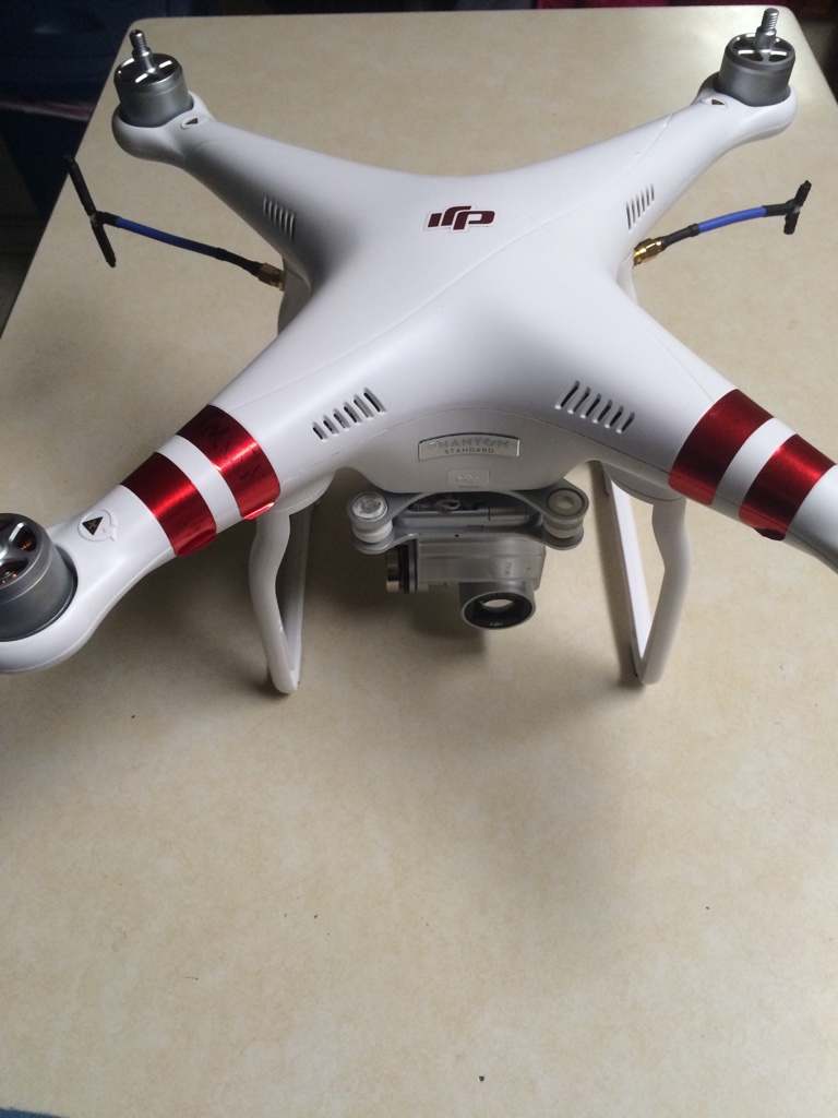

Got the bird modded up for (part3) of the tests. Dipoles birdside ,dbs panel UNboosted,
Although I havent got pigtails yet
I had (2) so I went ahead and did (1) 5.8 and (1) 2.4 figure i'll give it a shot even though it's not all (4)dipoles its worth a test!
Took it out this morning all charged up and excited, it was a calm day for testing. It went out 12,600 feet and was dropping bars and then gaining them back from 2000 feet and on. Return to home kicked in and when it spun around I noticed rain in the Cameraview! It was a zero chance of precipitation! So needless to say I didn't try to spin it back around and see if I can push it past 12,600. And on the way back maybe because I have both dipoles on the rear of the a/c (although that shouldn't matter at 2 miles) I barely picked up reception until is almost all the way back to me.AHH, I HAD A PERFECT FLYING BIRD! This is exactly what I was afraid of. I wanted to follow through with these tests but the stock antennas with boosters took me so far my gut feeling said don't mess with it
And part two to that story. When doing the dipole mods and taking apart the shell, (you know how much trouble the P3 shell can be sometimes) once I had it apart I found screw holes cracked and busted apart (4) different ones!! So I did some repairs before reassembling, but now there's certain places on the arms where you see little cracks and you just know that it's not as tight as before I took it off. AHHH!! I HAD A PERFECT FLYING BIRD!
I had (2) so I want to head and did (1) 5.8 and (1) 2.4 figure i'll give it a shot even though it's not all (4)dipoles its worth a test!
Took it out this morning all charged up and excited, it was a calm day for testing. It went out 12,600 feet and was dropping bars and then gaining them back from 2000 feet and on. Return to home kicked in and when a spot around I noticed rain in the Cameraview! It was a zero chance of precipitation! So needless to say I didn't try to spin it back around and see if I can push it past 12,600. And on the way back maybe because I have both dipoles on the rear of the a/c (although that shouldn't matter at 2 miles) I barely picked up reception until is almost all the way back to me.AHH, I HAD A PERFECT FLYING BIRD! This is exactly what I was afraid of. I wanted to follow through with these tests but the stock antennas with boosters took me so far my gut feeling said don't mess with it
NOOO!!! But you can always go back to stock antennas tho, right?
