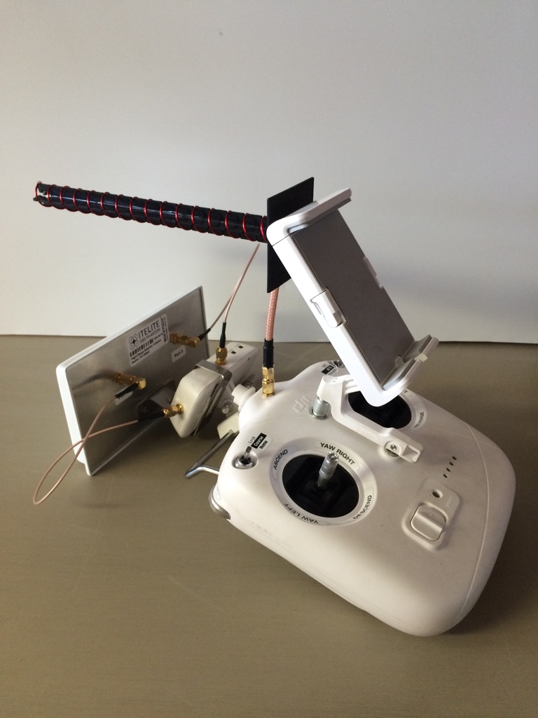

I noted that I DID think the wi-fi signal WAS a little stronger (at least at first) and yeah the dipoles, from all that I understand about them through talking with Tony the creator of them and for my own testing with the P2 series, are not supposed to be facing down like that ever. The signal just doesn't work that way with those dipoles. But it was worth a shot and that may have just as much a reason for the control signal problems as tilting the panel vertical did.
For the Vision series,for distance, I've shared with you guys in the past but I've tried everything and I found the best answer to be a long helical for control and a double 2.4 itelite panel for Wi-Fi
I think I'll test that combo out on the standard tomorrow in the same flight path
Reactions: Mark The Droner
****! What is that, a 16-17 turn? I didn't even know they made them that long! All I got is a 11-12 turn FPVLR.
Ib crazy 15 turn. Its a real good control signal antenna ($50)
But I've also tried it for 5.8 video/audio antenna and it didn't do that great. So I just use it for control antenna, I'll try that tomorrow.because it seems like most of my issues with the standard is the control signal
Note: on the bird w/ that setup i use 5.8 mushrooms & 2.4 dipoles

Wow thats a cool setup!
Why the dbs sideways/vertical??

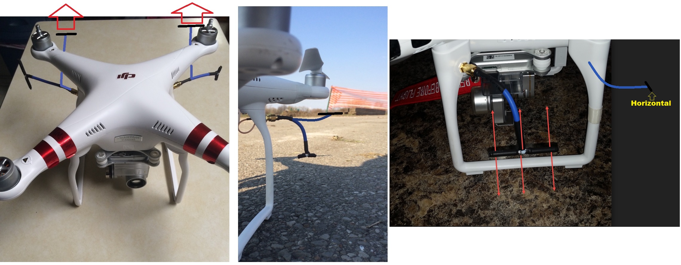

Hey DB! Thats an interesting test.
so ive been thinking, since its not recommended to point antennas down like that ever,
what if you point the antennas in the direction of your RC, and not down towards the ground?
so the antennas are still in horizontal position, but point backwards facing you?
something like in this picture:
Im not sure if its gonna make any difference, but what if does???:eek:
The "tips" of the dipoles ( in theory and design) are supposed to be facing the top and bottom of bird and NOT to exceed 30° from vertical.
So the way i flew it this morning and the illustrations you made are suppose to be a no-no.
