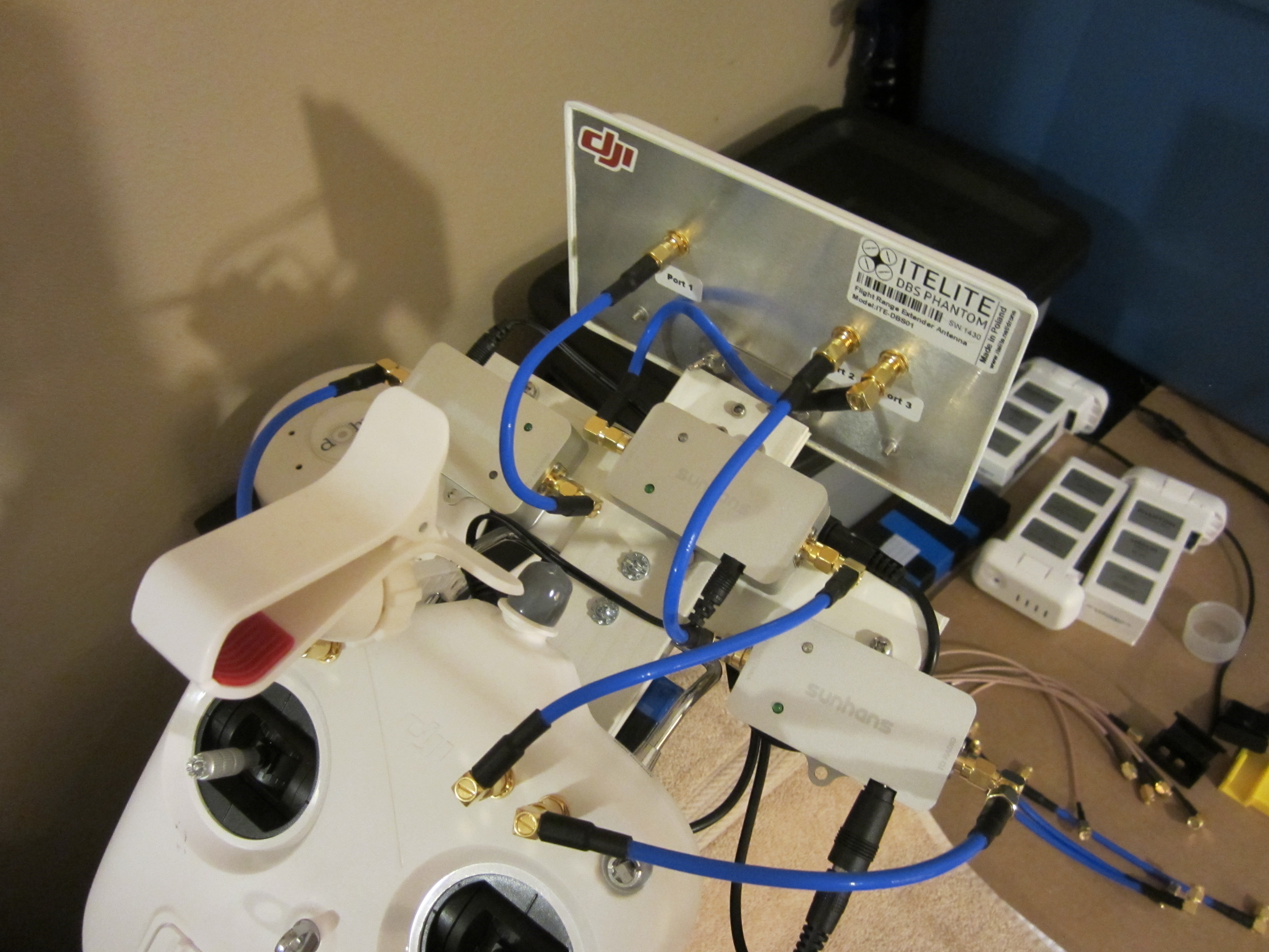

BTW Guys, if someone's looking for those 'better' blue RG402 cables (originally suggested by dirkclod - thank you!),
that chinese ebay seller ships them very fast. I ordered them last tuesday March 29, and got them this morning Aprl 6, thats only 9 days from China to NJ.
He is a lot cheaper that other ebay sellers and has more options.
I hooked mine up today, im gonna try and test tomorrow to see if i notice any difference.
(here is what it looks like - promise not to laugh at my RC, i designed the bracket myself :eek:)
Edit: add ebay links if anyone interested and wants to check em out:
that chinese ebay seller ships them very fast. I ordered them last tuesday Apr 29, and got them this morning Aprl 6, thats only 9 days from China to NJ.
View attachment 49743 View attachment 49744

Hey just wondering, did you get the 6 or 8 inch cables?
I got them all in 6. I think in this case with the wires shorter is better (thats not what my wife says),
so the signal doesn't need to travel longer (i think it makes sense)... the original 8" DBS & amps cables were too long & messy for my set up.
but its better to measure and double check to make sure they are going to be long enough for your set up.
or maybe do 8" from controller to amps, and 6" from amps to antenna
That remote is no laughing matter NJ!
ITS BADDASS! Let us know!
