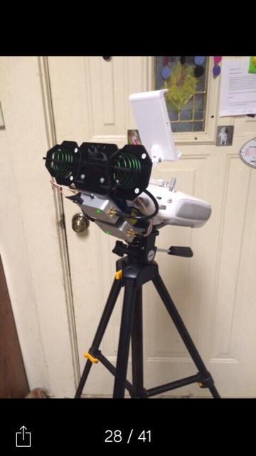

Hello dirtybum- Are you still using a tripod? Not sure if that was you or someone else.
Yep, after 2 miles my AdD kicks in and i start watching birds and squirrels around me so a tripod is the only way i can keep it steady and aim true! (Plus after the controller is fully loaded its **** heavy)
Where did you get that one at may I ask? I might pick one up as well. I know you said aiming steady is crucial in getting distance.
I got that one at the thrift store for three dollars. They have them there all the time, they usually at the top have a little screw sticking up to screw into the bottom of the camera. The bracket that holds my boosters and locks into the controller I screwed a hole in and put a nutsert so I can easily attach it to the tripod. Yeah what you get out so far it's pretty important to be locked in! The signal back-and-forth is traveling along ways so you're either locked in or you're not

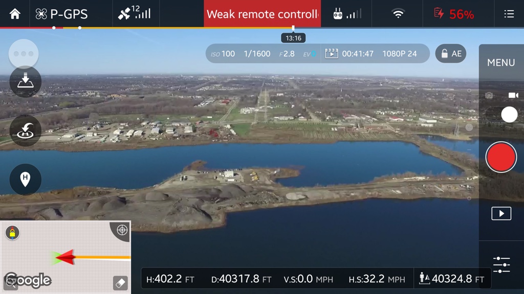

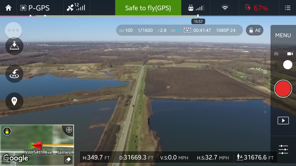

Heres a couple screenshots to show signal strength on my 40,000+ run today w/ stock bird and DBS boosted controller. BTW, just because the screen shows red weak signal its not a sign that all is lost! I see that a lot during the flight but as long as the bars are strong everything is flowing smoothly!

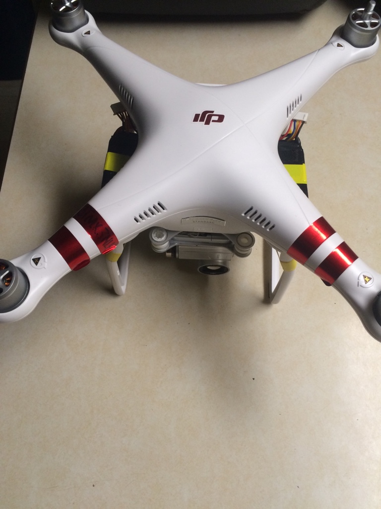

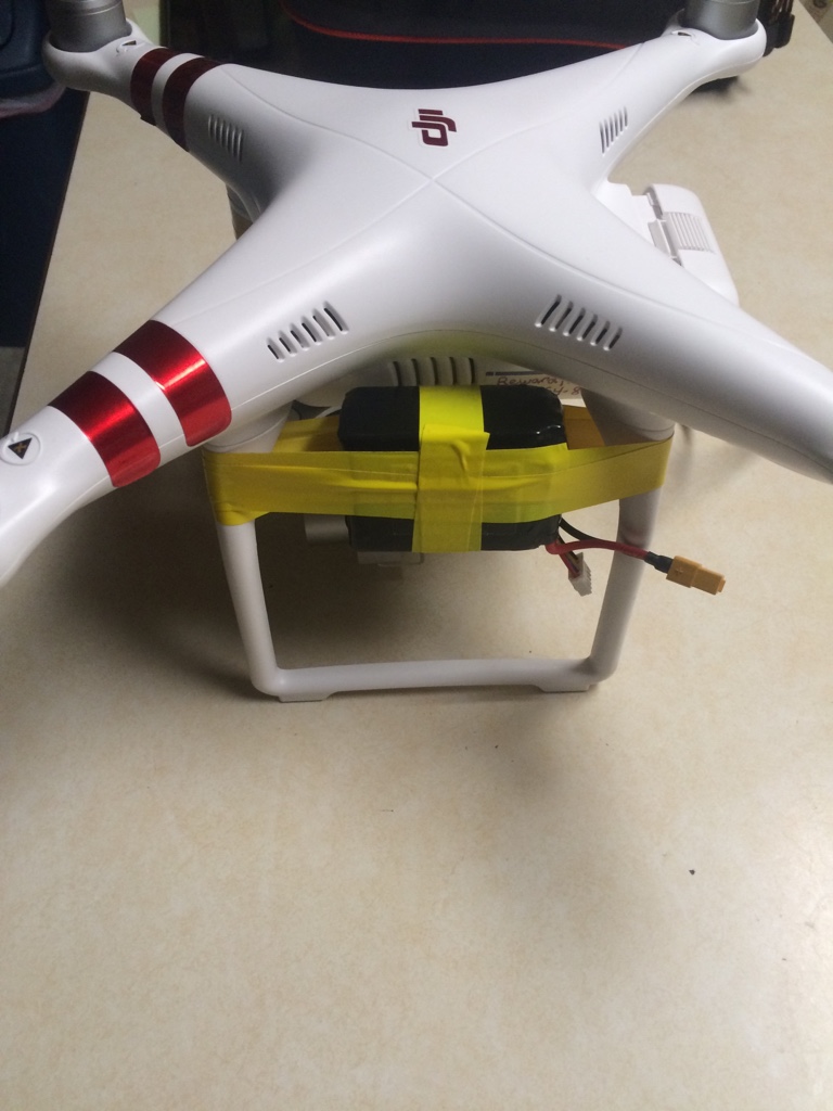

Heres the stock bird w/ lipos strapped before the flightView attachment 48830View attachment 48831
