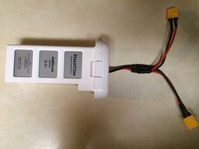

The v-3 is designed to use a split dji battery tied together with a modded dji battery so they balance and charge as one. Yes you send them (2) before any does that check out these results. Most of us found it does not live up to the hype.
Horizon v-3 split power mod
Most of have gotten as good or better results with a normal modded smart bat and (2) 4s lipos

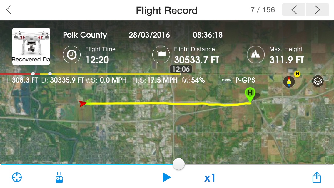

O.k. Guys got a chance to do a couple good flights with part two of these tests. Stock PIII standard, boosted DBS panel &( of course external bats)
22,500 last nite not in favorite spot. Had some signal issues towards the end had to climb up over 400 feet. Still good for stock Bird!
Then this morning, in one of my favorite flightpaths
30,000 ft turned at 55%

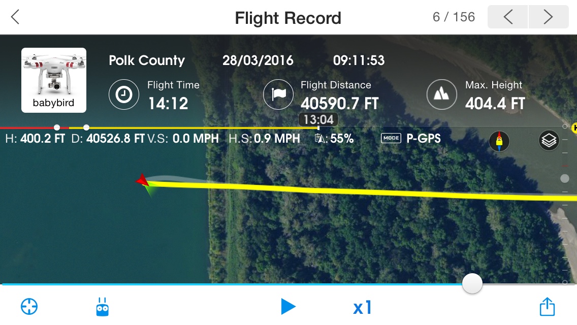

40,500' turned @55% landed 8% (Wow this is my personal best w/ ANY of the phantom series, and unexpected from the standard!)
I have screenshots I'll post later of 40,500 with almost full bars!
Pay no mind to the HD link where it says landed at 40% the flight is actually broke up into three flights because the signal on the way back was getting shotty! It was my second flight with that booster battery so it might've been getting weak!
40,000 is insane!! Unexpected!

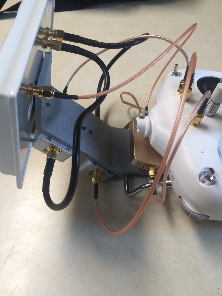

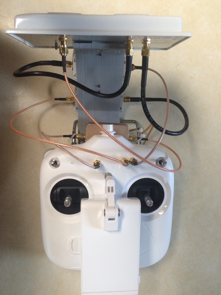

I didn't include only one 2.4 booster in my controller mod, mostly because I owned two and I already have the controller open. If you own one and want to leave one stock antenna inside the remote hooked up and only use one there would be no harm in that. For example, I don't know what everybody else is experiencing, but in all stages of these mods so far I lose control signal before Wi-Fi signal so I imagine (1) 5.8 booster (1) 2.4 booster would still work great as long as your antenna for your second 2.4 antenna was hooked up to something( dbs or stock)
Here's my controller, the top is my 5.8 (long antenna) booster, bottom is my 2.4(double helix antennas) booster. What if I had a booster for each helix instead of them sharing one? Guessing I would need another battery to power it?
http://i.imgur.com/OPIYCRv.jpg
Send me a pic of the top side. What do you mean the (2) 2.4's Are sharing a booster
That's a clean looking setup BeauS! It seems like it would work great. I dont think the 2nd 2.4 booster would be super crucial, are you getting bad results w/ that setup

I'm trying to understand how dual 2.4 antenna's, and the single 5.8 work in the Standard's Controller (with DBS)? How is that split? I guess I'm used to the P3/4 Controllers where are are only 2 antenna leads both @ 2.4.
