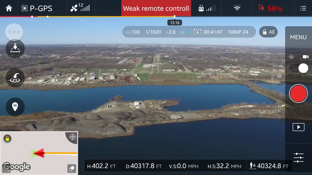

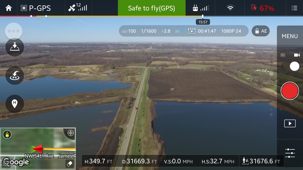

Heres a couple screenshots to show signal strength on my 40,000+ run today w/ stock bird and DBS boosted controller. BTW, just because the screen shows red weak signal its not a sign that all is lost! I see that a lot during the flight but as long as the bars are strong everything is flowing smoothly!

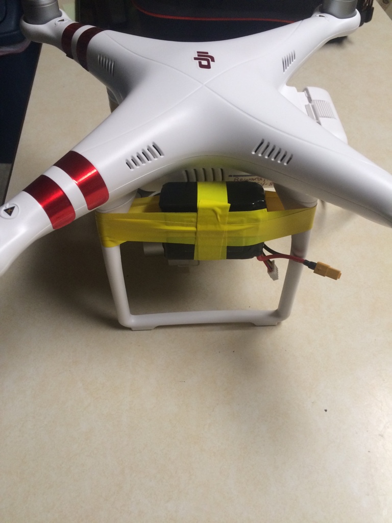

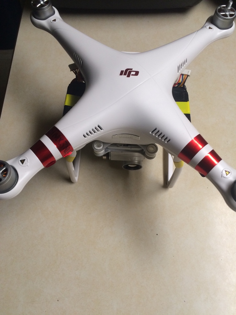

Heres the stock bird w/ lipos strapped before the flight

Hey dirtybum, do I need to keep my eye on the satellite icon? I don't get 12, but more like 8 or 9.
I went ahead and got the 5.8 4W booster, my control signal is definitely the one I always loose first.
So as long as that control signal is not down to a single bar of signal lost. The red weak signal notification is nothing to worry about?

It was 9 sats for most my flight, i didnt even notice the 12 til you mentioned it! Dont worry Big Guy, 9 is plenty!
I need to get me a P3 Standard. Wish I saw that eBay $399 deal in time last week. Then again I'm on the prowl for another v1 (W322) Advanced and if I can't find one of those in really good condition I'll likely end up getting a new P3A or P3P from ThePixelHub on eBay.
Yep, thats the bird" rite thar"!
Old motor p3a/p's rule!

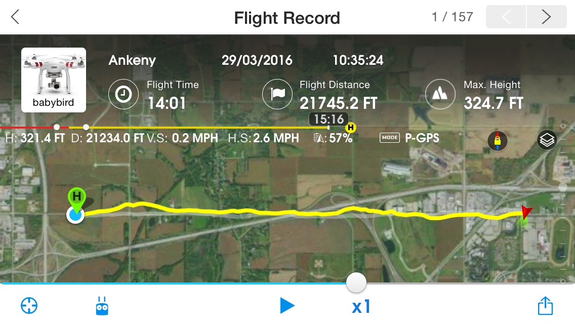

I already had a set of batteries charged up so I couldn't resist doing another run today stock standard, DBS boosted. Even though it was 17 MPH WINDS!!!(check out how wavy my flight path was) 20,000+ feet, no signal issues.
I think we can all agree that stock bird boosted panel is sufficient enough. What do you guys think should we even go onto the next step, add dipoles??

yeah, very impressive! Standard is a good bird, but it appears that newer model P3S are put together better than last year model, and get better bone stock range without any mods.
I have last year model and honestly i had a hard time getting any decent distance until i threw in DBS and amps.
I doubt i will ever get to 40,000 even if i hook up every available antenna mod out there..
If you have full signal at 40,000' with the current set up, how much farther can you really get before you have to turn around and go home, considering your batt was at 50% at that range.
Unless you can fly in a straight line till you run out of battery, and have someone follow it in a car and recover it after it lands. Then its probably worth adding dipoles, imo.
but if you do decide to go thru with it, keep us updated, we would love to hear your results!

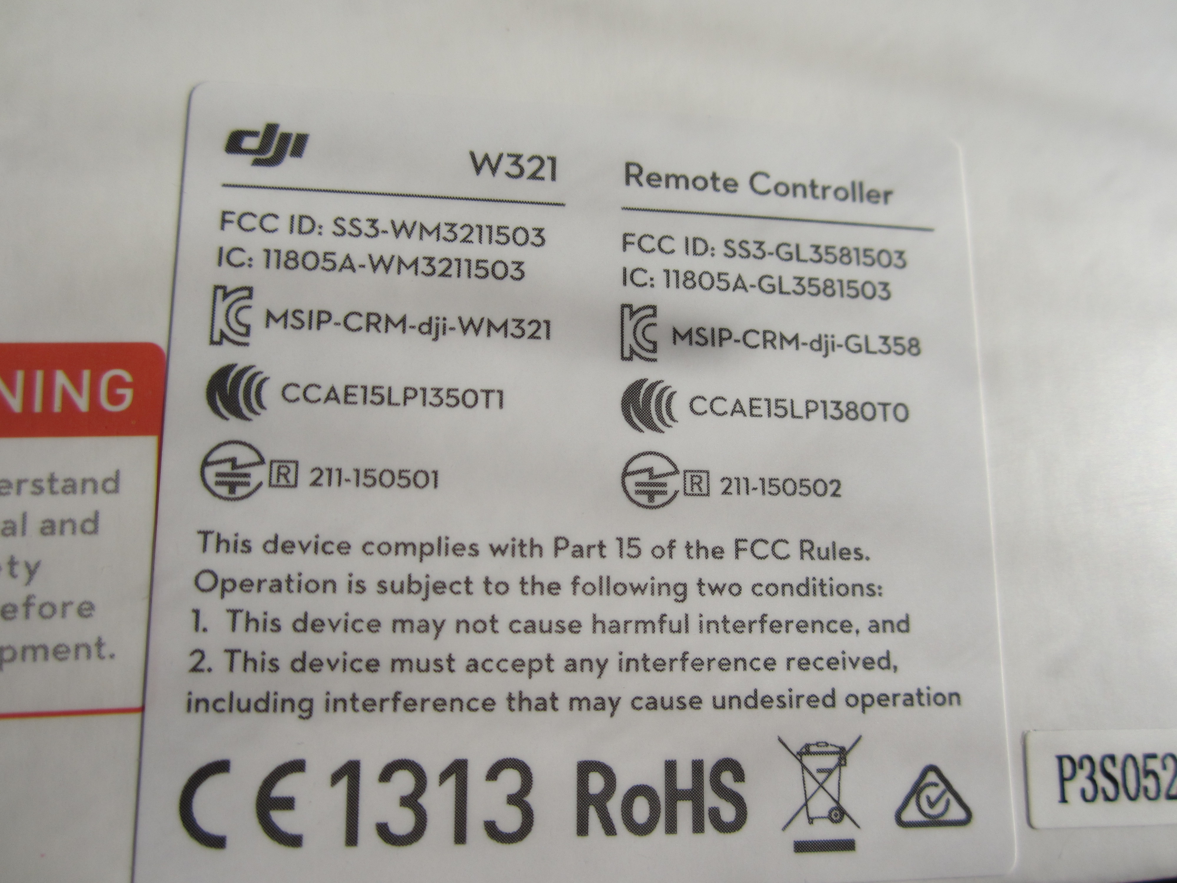

Here is a pic of the sticker from the box, i got mine around Christmas last year.. im not really sure how to tell the manufacture date tho. Maybe you can look at yours and see if there is any difference.

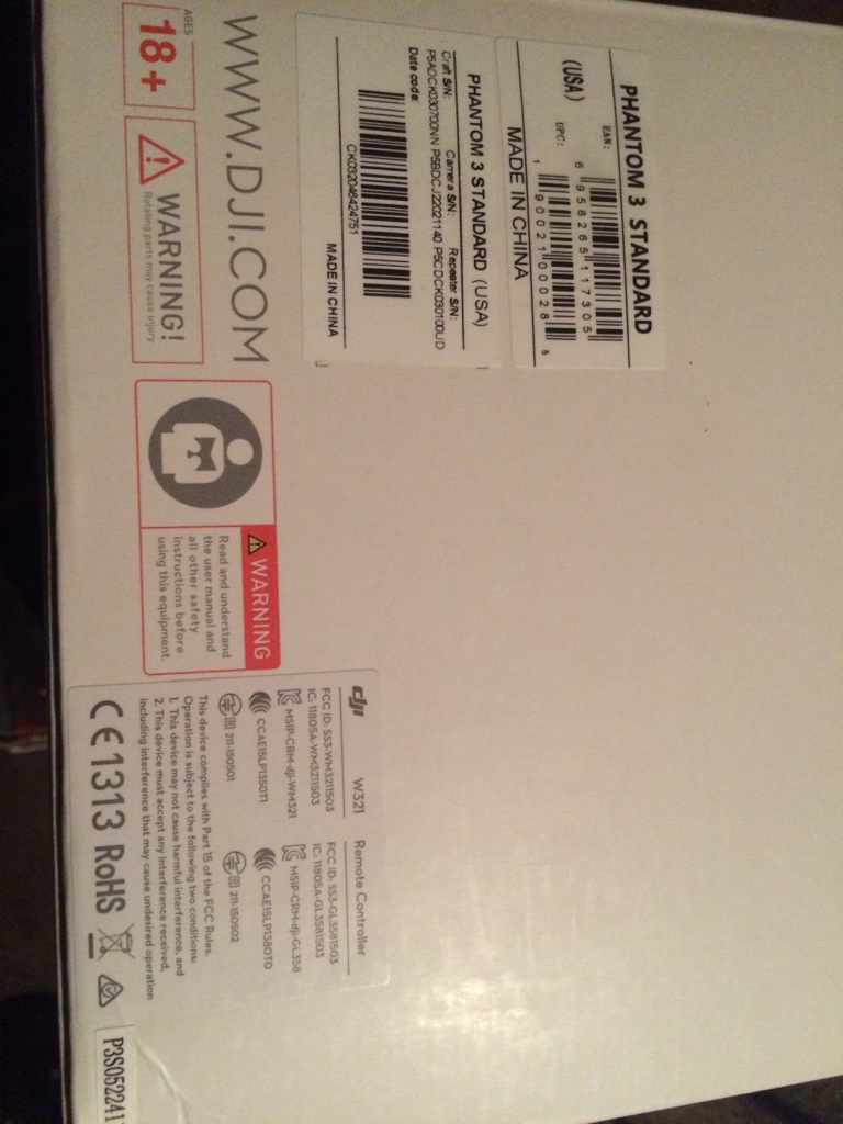

Heres what I'm flying

Hmm.. All the numbers are exactly the same!! I guess it doesn't really make any difference then, since your numbers are great!
Maybe it got something to do with the firmware u got on yours.. Its just that a lot of new (purchased in the past 1-2 months) P3S owners on here report great results with all stock Standards, vs. ppl who got their standard last year mostly disappointed with their range. You can see a lot of threads here with ppl complaining bout range issues etc.. @dirkclod was the one who first pointed out. i still think there is some truth to it tho. But regardless, its a great bird to mess around with. i cant wait to do more 'things' to mine :smirk: we gonna go the distance and she's gonna love it :wink:
