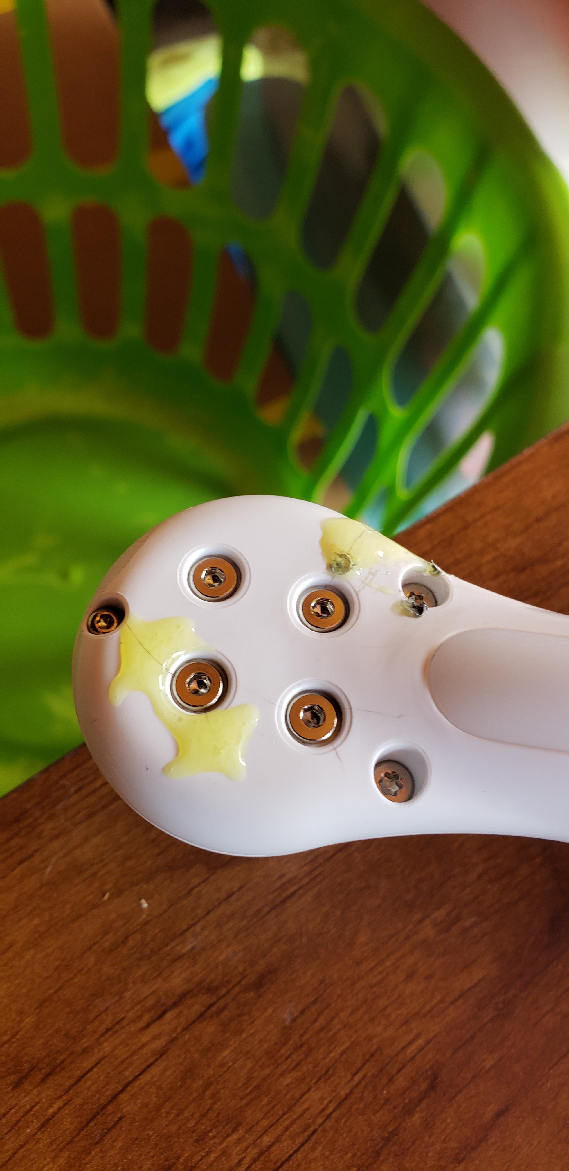

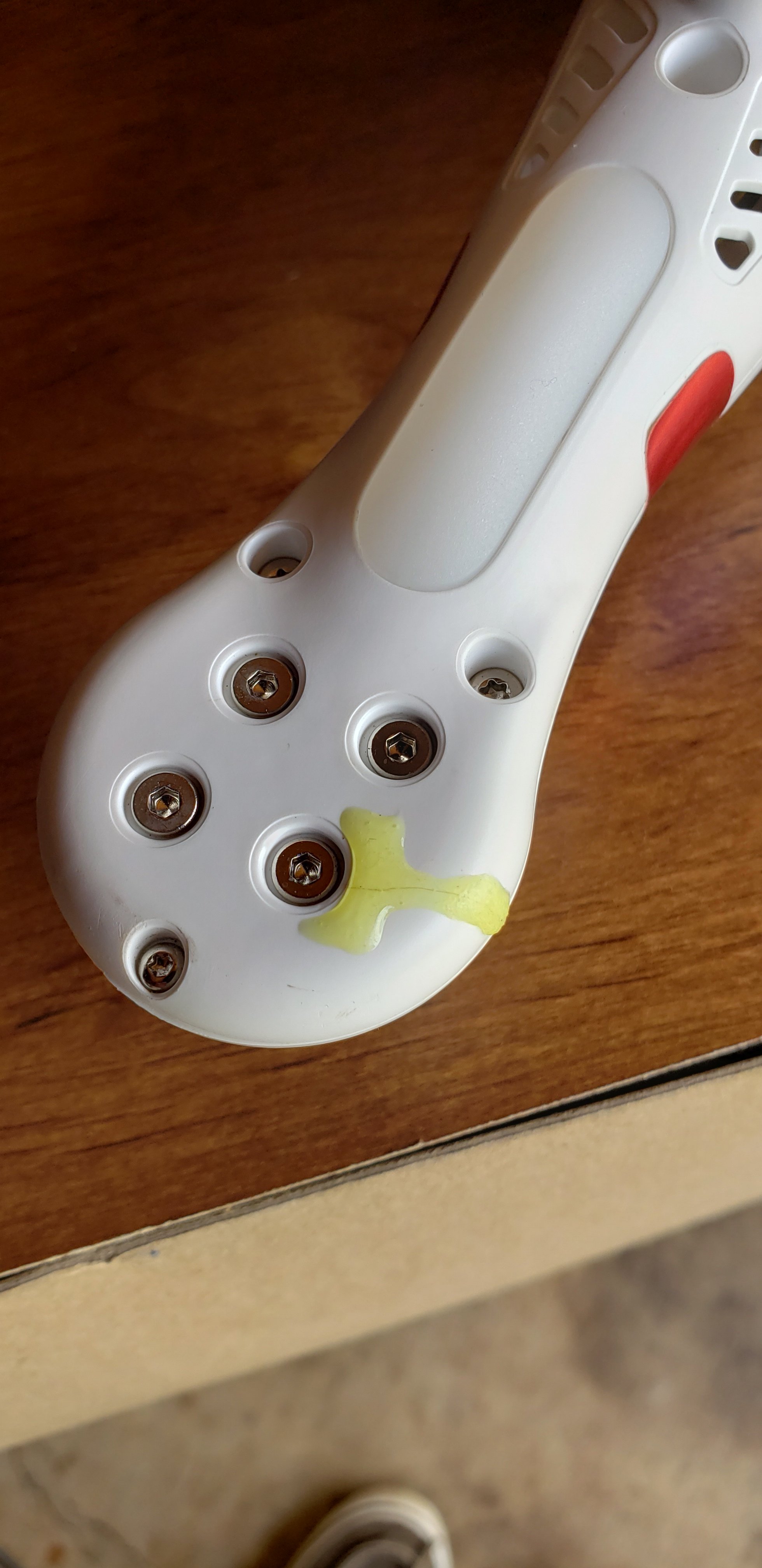

Right on. Appreciate the knowledge. Pretty much what i figured. Amd if your out there flying in alaska lol they must be up to the challenge.. the new shell is already shipped unfortunately. And i want to replace it anyway. The landing gear are bent too and think the whole shell is a little out of whack so ill def add the motor mounts for sure either when i replace it or a few days after as soon as i can muster up the cash just bought all these little goodies to go with the new shell heres my cracks.. i put a little jb plastic weld to hold her for a couple days until the new shell.comes
