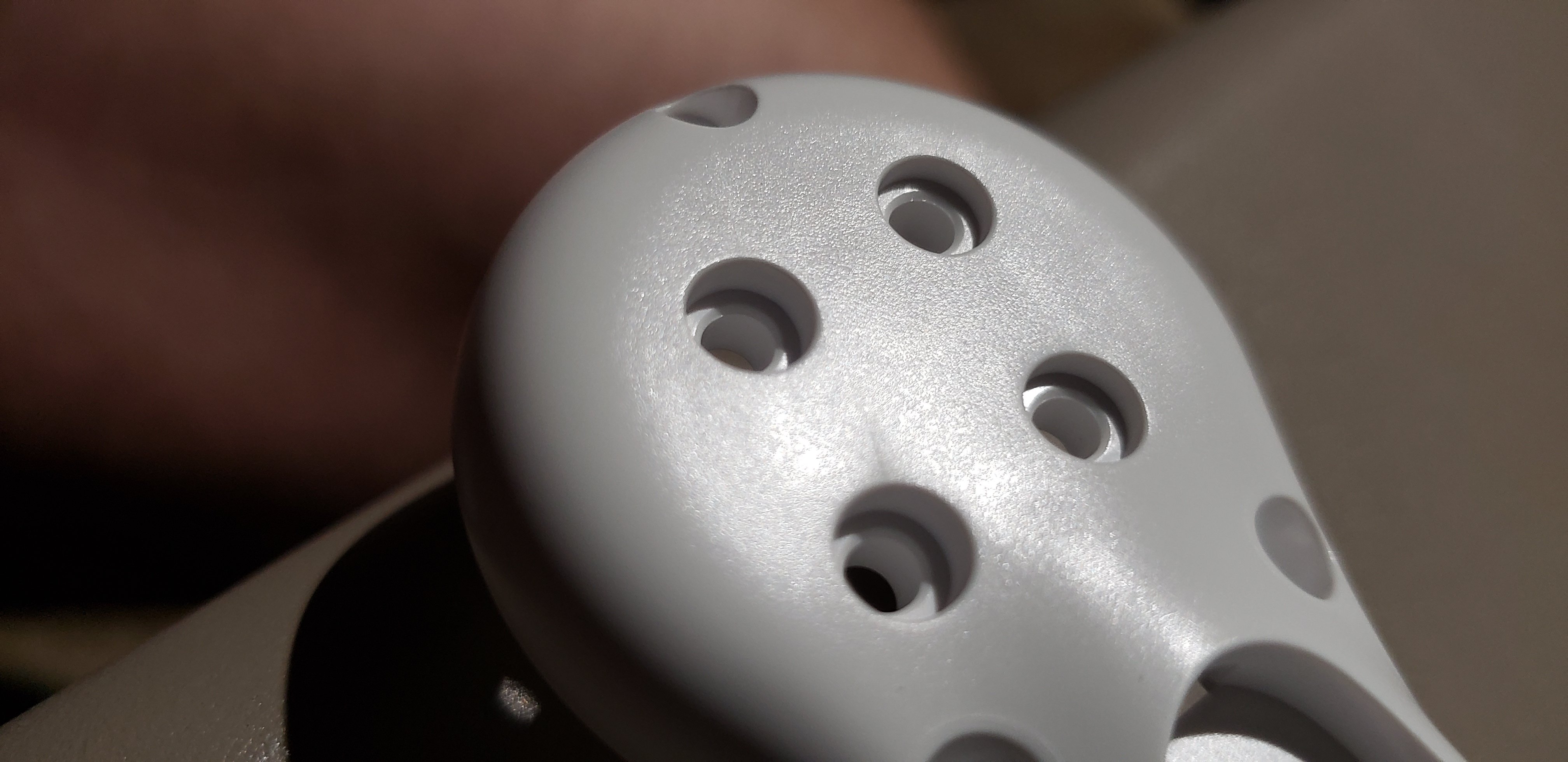

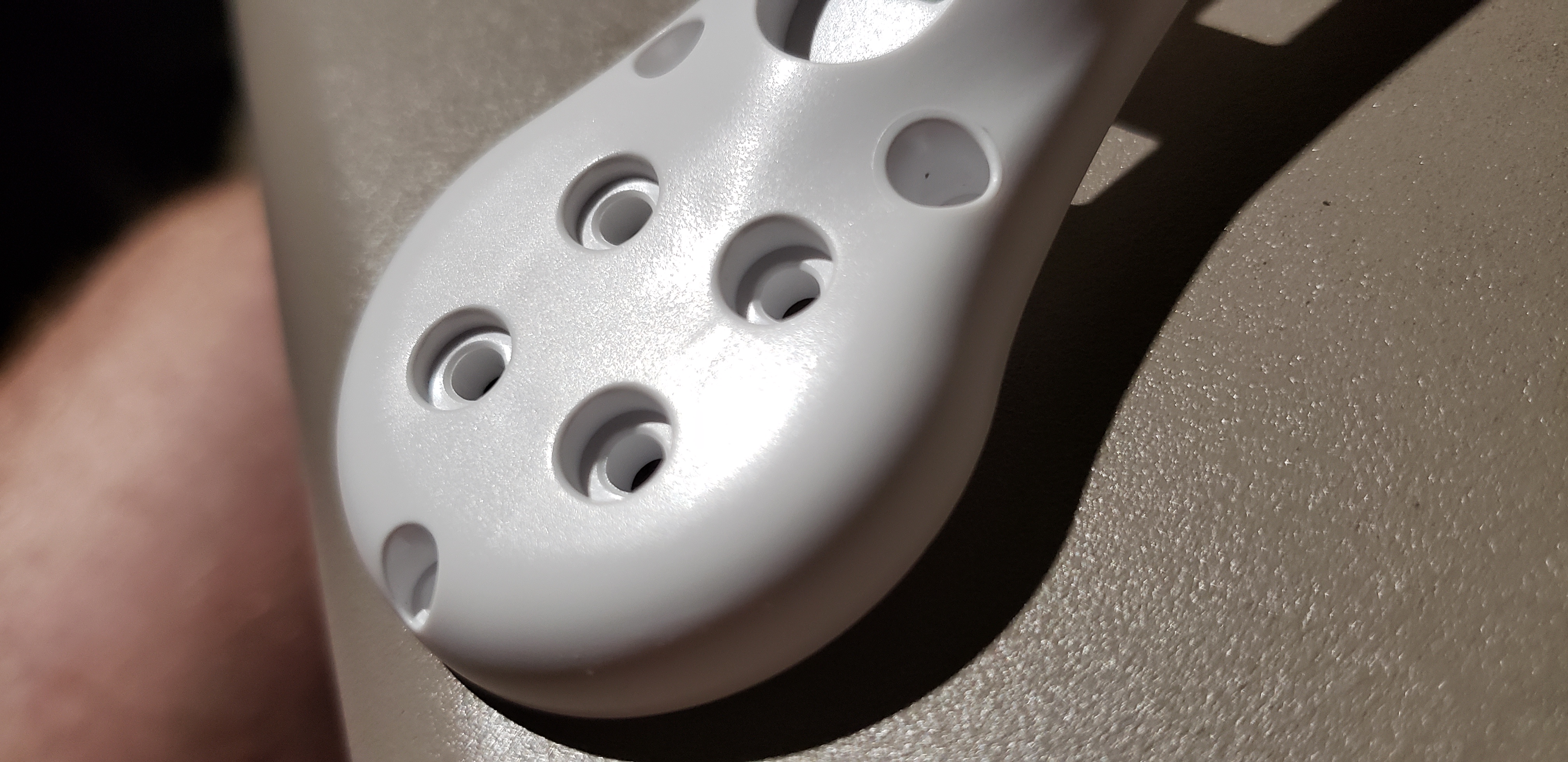

Man thats crazy! Thats no good! We definitely need to figure out a different solution. My new shell came today and I have some interesting news it seems to have the lines right were the cracks would form. Like light scratches it looks like from the molding process or something. Almost like predetermined cracks like im scared to put this thing on and now im scared to order the motor mount plates... what to do. They might be nothing . Sorry they messed your motor up even for a second. I know that is stressful. Which brings me to this question if your flying part 107. And you know your craft has stress cracks and do a preflight check are you in the wrong if you let it fly with stress cracks? Or only wrong if something unfortunate happens? Or are you guilty just putting it in the air? Heres the pics btw
