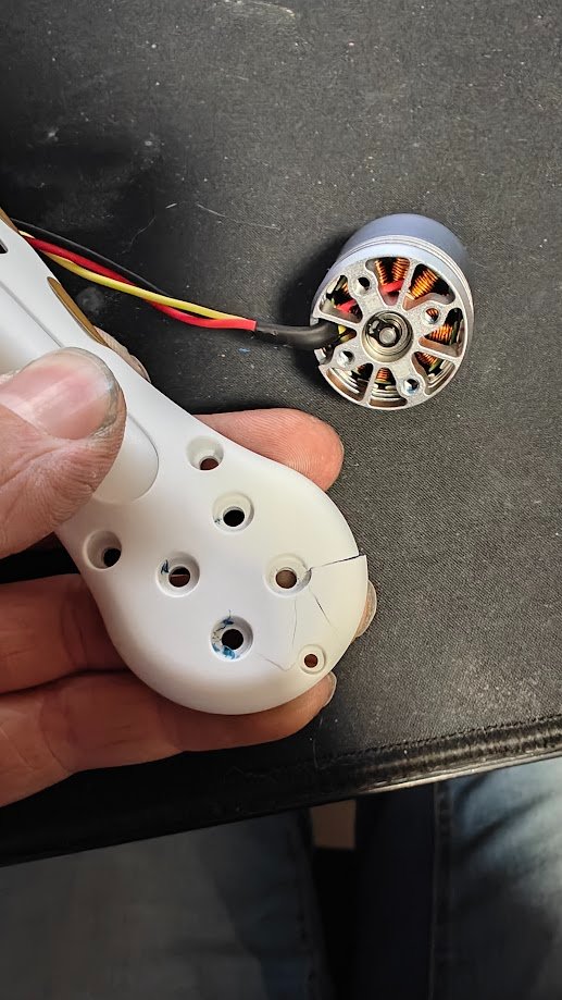

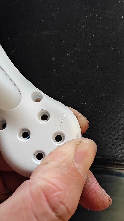

I bought used Phantom 3 Pro in hopes that i could fix it. It has weird problem with the motor rpm's. When using the lift-off feature on phone, 1-2 of the motors spins erratically, like up and down in rpm's, almost impossible to get the drone into hover/fly. Then i tested the drone without lift-off, manually controlling motor's rpm's with controller. Motor's spins nicely when the propeller's aren't attached, but with propeller's it becomes unstable. Two of the wing's have cracks under the motors.

Picture of the cracks would be great!

Sounds like a blast from the past. Cracks under P3 motors and rpm problems. I used to either replace the shells or place motor guards (preferred metal over plastic) under all 4 motors. Anyways, not doing that anymore so good luck
Do you think that the cracks causes rpm problems? I epoxy glued them yesterday, not tested yet. Quick Google search and i can also order metal reinforcements for it.
