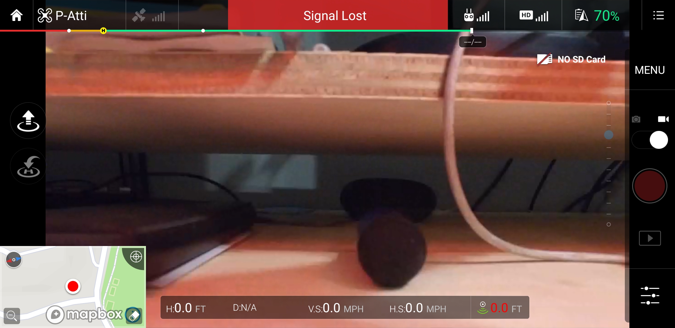

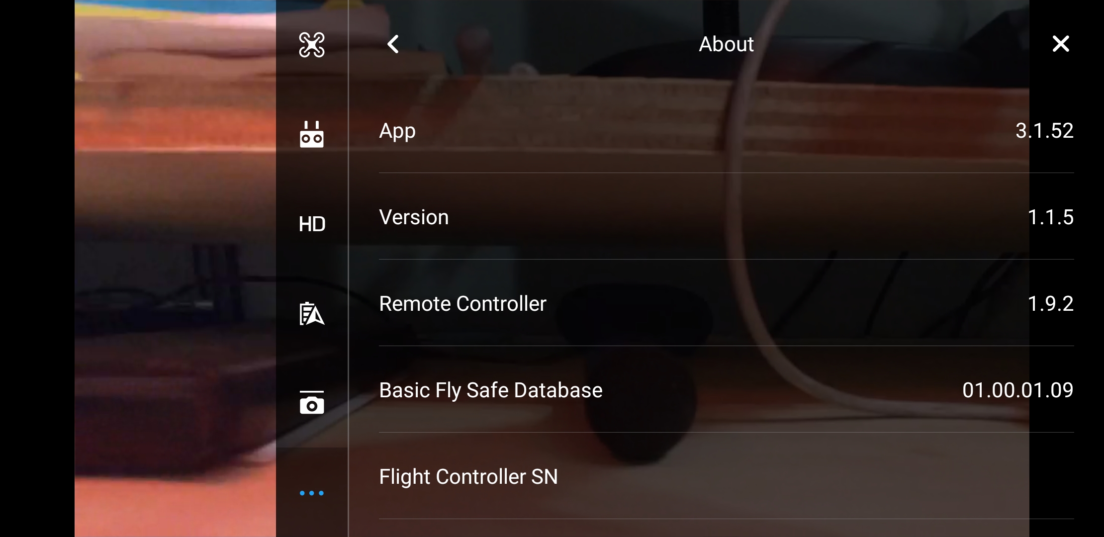

I had bought an Phantom 3 Advanced in 2015. Full disclosure - I just opened it to fly. I charged the batteries, installed the software on the phone and flew for a bit, video worked. No problems. Nag screen says "update firmware." I did as commanded. I have "Signal Lost" error. This bird won't fly. I have been fishing around for hours trying a range of dead end recommendations. I have video feed working intermittently. GPS is intermittent. I have included a couple of screen shots. Any thoughts?
View attachment 112958View attachment 112959

For one thing, it seems to me that you've created a FW encryption mismatch by updating the RC (remote) but not updating the AC (aircraft) to match. By that I mean to match the encryption, not the FW version numbers which do not need to be the same.
AC FW 1.8 and RC FW 1.6 were released together with an encryption change. If you have one (or later), you must have the other (or later) or you will have issues. DJI also noted this in the release notes, but even so we have seen several people here who were not aware and inadvertently created an encryption mismatch.
What it looks like from your screen shot is that your RC is now 1.9.2 (new encryption) but your AC is 1.1.5 (old encryption).
If it were mine, I would try to update the AC to at least the first new encryption version (1.8) or try to downgrade the RC back to the old encryption you had before you introduced changes. Then of course do a basic relinking of the two. [Note that the most common method to try to downgrade the RC is via what we call the "graduation cap method" but I have a feeling that in your particular case you would not be offered a downgrade option.]

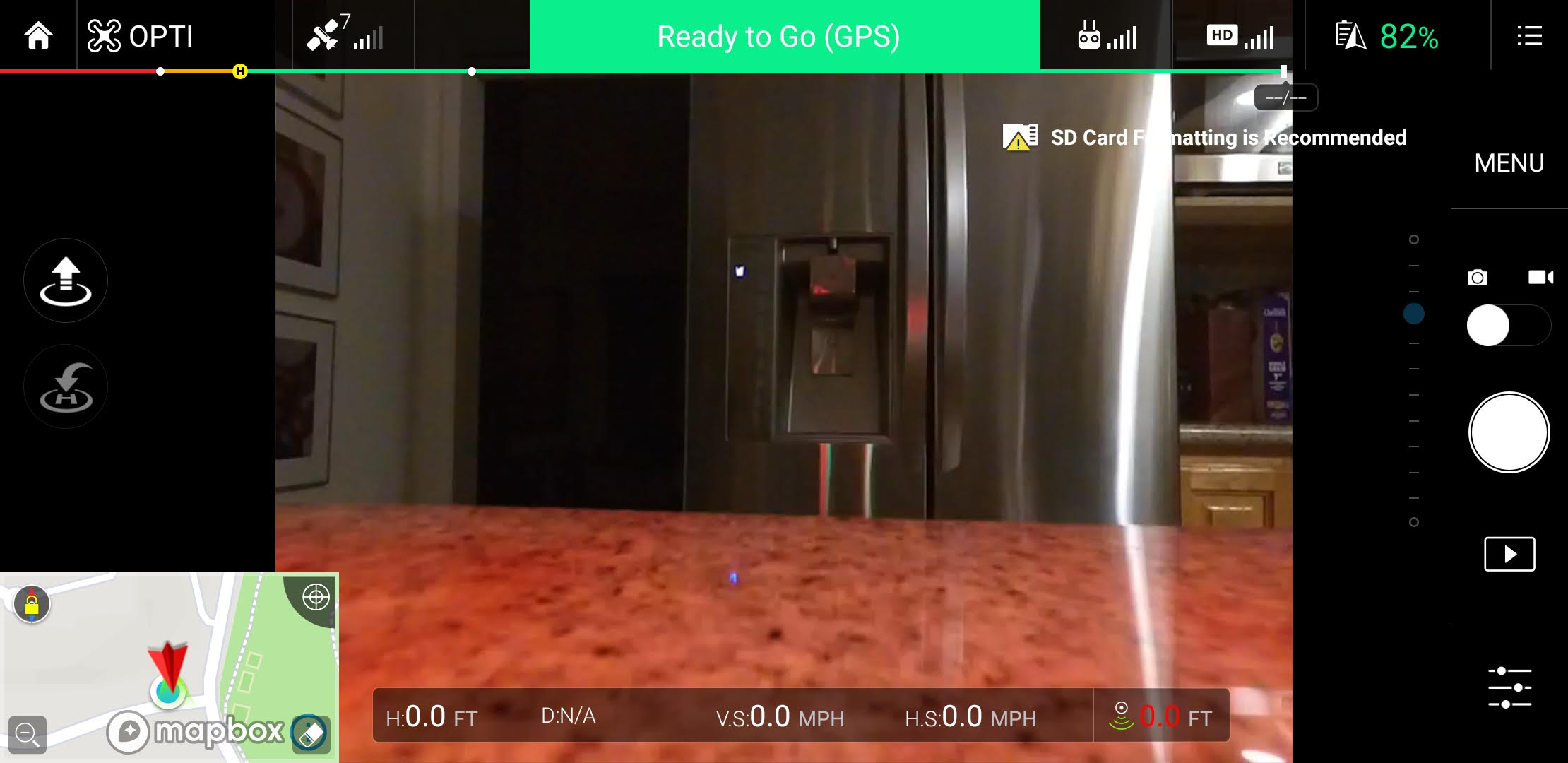

AMAZING. It wasn't simple, but we are READY TO GO !! The secret was having access to the correct firmware that would allow me to retrace the steps back to compatibility. Tower of Babble destroyed! PhantomPilots Forums are awesome.
, but I figured it
View attachment 112978, but I figured it
