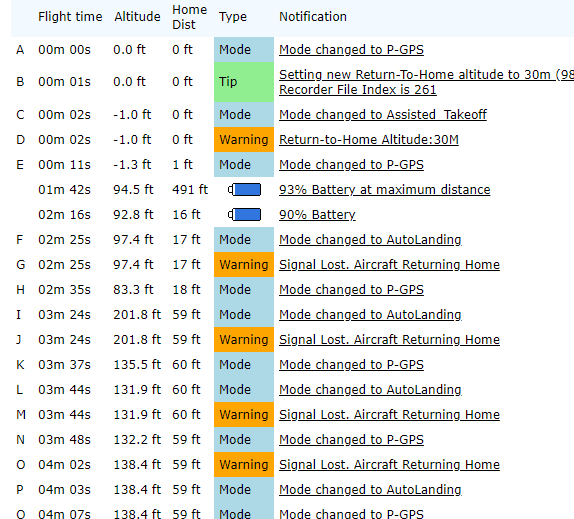

Reading the thread that @RodPad linked to, I came across the Airdata app. I uploaded some logs to it which show something pretty weird.

This picture shows notifications. They shows multiple instances of signal loss. What's strange is that the signal is lost even though the signal strength is good. I wonder what could cause that?
112589
I wonder if the signal loss is being caused by spikes of interference at 5.8Ghz. The signal map on airdata is generated by sampling signal quality at 30 second intervals. Perhaps the interference just doesn't show on the map because the sampling interval is too coarse but when it happens it causes a disconnection?
For what it's worth, I'm flying around 1km from a National Grid electricity substation. I wonder if that may create RF interference in the 5.8Ghz spectrum?

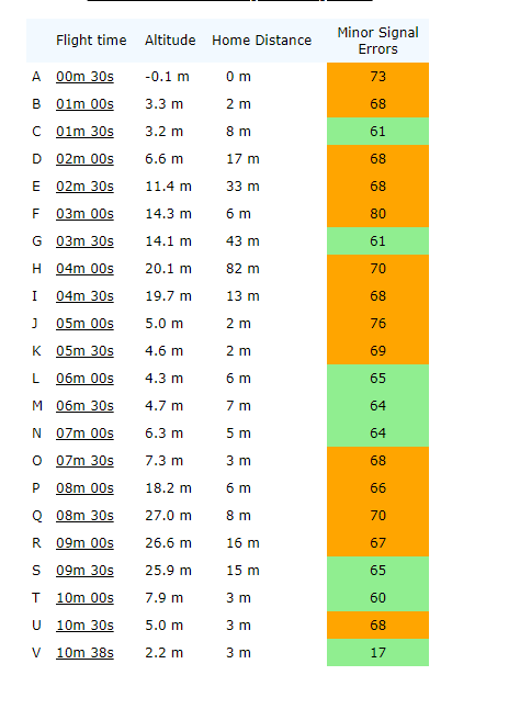

Mind you, having just uploaded another log I notice this. The signal is degraded even at short distances. Although orange apparently means 'fair', so I wouldn't expect this to cause a disconnection?
112590
Never been impressed with air data graphs, even when it was Healthy Drones.
RTH, initiates after 2 seconds of remote loss.
Uploaded your log to:
You can share the results by copying and pasting the url back here.
Really don't think it is interference.
Rod
In actual fact I don't think the signal strength indicated relates to the controller signal strength. It probably relates to the video/telemetry feed strength.
