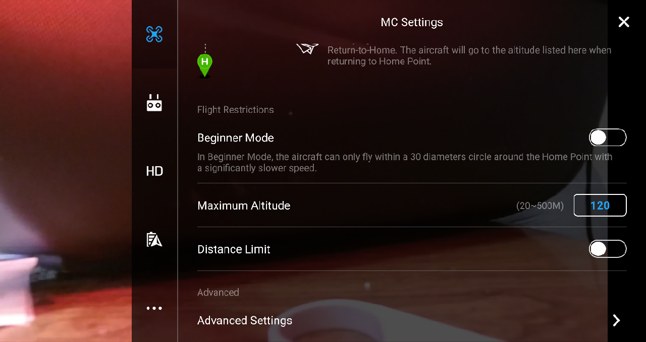

I was signed in and the AC and RC plus Phone all on and was going through the settings and came to max Height and off to the side it gave (20-500)M and was set to120 so I assumed its 120M or 360ft. Thought it was strange that it gave Meters since i set to Imperial so now Im not sure if the 120 is in feet or meters.
Again just curious since later I might want to try but at this point I'm fine with 500M .

Here’s a bullet from the tips post linked in post #2 above.
> In the GO app, the maximum flight altitude setting and the RTH altitude always show in meters and can't be changed to feet no matter what preference you set in the app. Keep this in mind when you are setting your altitudes prior to flight.
