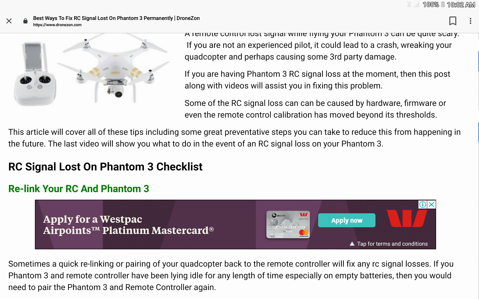

HI yip some p3s are nightmare on range,only thing I can think in this is give relinking a try,,this will establish a good pairing with remote again and hopefully give you better signal and welcome to the forum
Don't mean to hijack leftcase's post but... Relinking??? Don't guess I know what that entails. Care to enlighten me since I'm a noob ianzone?
Um,,very easy process,,in app under rc settings there rc linking,,I myself have done few times over the years with me p3,,mine was terrible on range and signal,,,this post below mentions about poor signal and relinking can sometimes cure,in process it ask to confirm frequency settings and press ok ,,drone beeps and flashes till drone link button pressed again,,I not to good at explaining so hope this give some idea

Um,,very easy process,,in app under rc settings there rc linking,,I myself have done few times over the years with me p3,,mine was terrible on range and signal,,,this post below mentions about poor signal and relinking can sometimes cure,in process it ask to confirm frequency settings and press ok ,,drone beeps and flashes till drone link button pressed again,,I not to good at explaining so hope this give some ideaView attachment 112407
Thanks for the tip ian!
